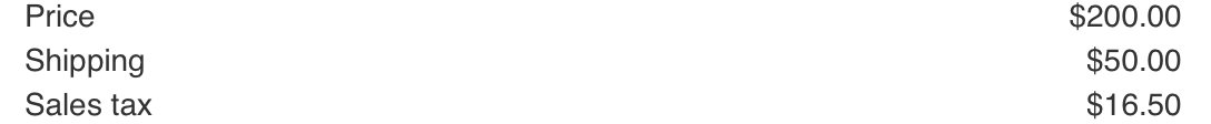

    $200 case

    Nice! I got mine on eBay as well, I was wondering if you got it from the same guy. $225 with free shipping was a steal. If anyone is interested in this mod, PM me and I'll give you the link.

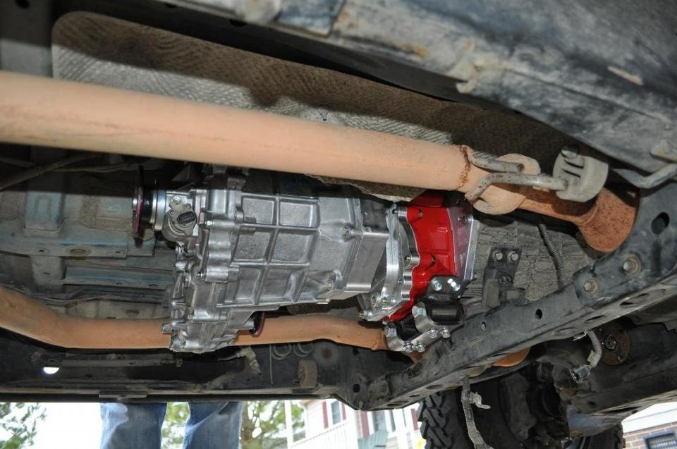

    FB reminded me it's been 6 years since I did my swap, FJ case still going strong. If you look real closely here, you will see a picture of myself and @wrmathis wondering what the fawk we are doing :rofl:
