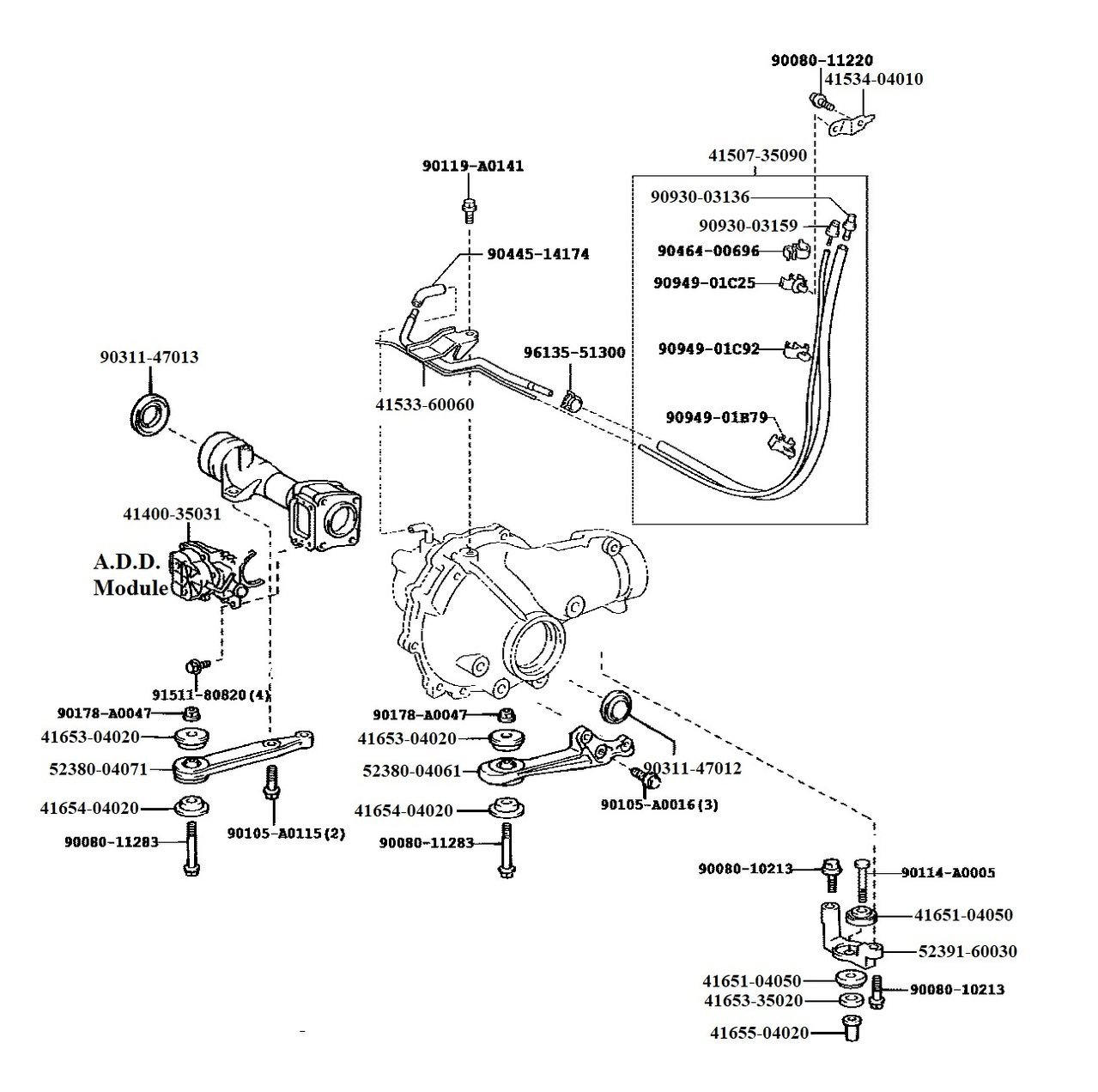

    I assume the actuator is wired to the case shift sensor much like the dash indicator is. Part of the process of the install is using the FJ case sensors so the stock Taco dash indicator lights for 4wd and lo are functional.

    Does the FJ use a different 4WD ECU then? It'd be pretty slick to not have to wire a separate switch.

    The FJ from the autos (with ADD) work just the same. You see in the tacomas the 4x4 detent switch in the transfer case sends a signal to the 4x4 ECU to activate and de-activate the ADD.
    For the FJs you could accomplish the same thing. Easiest way to do it would be to wire that 4x4 detent switch to a DPDT relay. Then wire the DPDT relay the same way as we wire it up for the ADD, except the coil is tied to +12V and the 4x4 switch would provide the ground for the coil. Very similar to how folks do the "locker anytime" mod on the e-lockers. The only downside to that setup would be there would be no way to get 2low without twin sticking the case, unless you wired in a switch to interrupt the power to said relay coil prior to activating it in 4wd.

    To answer your question, yes they have a different 4x4 ECU. A much simpler one than ours since it only controls the ADD, not the transfer case as well

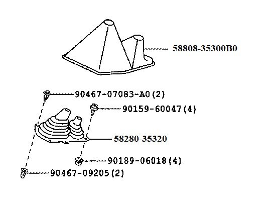

    @05Taco4x4 Do you have a part number for this FJC shifter boot you used? I am wanting to go the same route with my setup.. This is the one out of the 6MT AWD FJ right?

  8. Feb 28, 2019 at 7:13 AM
    #508
    05Taco4x4
    05Taco4x4 ToyotaHubs
    Jun 29, 2011
    #59085
    6,243
    2TR-FE Enthusiast
    FJ Tcase, Manual Hubs, 2017 Head unit, Mirror Riser
    At the bottom
  9. Feb 28, 2019 at 7:25 AM
    #509
    BassAckwards
    BassAckwards Well-Known Member
    May 3, 2016
    #186002
    27,938
    2009 Tacoma AWD Turbo 2TR-FE
    Full-time AWD & BorgWarner EFR 6258
    Thanks a million! :fistbump:

  16. Mar 1, 2019 at 12:22 PM
    #516
    BassAckwards
    May 3, 2016
    #186002
    27,938
    Have any info on where you bought your shifter boot (58280-35320)? I tried getting one from Gunny1005 on here and he said they're discontinued and he's unable to order them. I think i may have to find one in a pick and pull
    hoverlover likes this.
