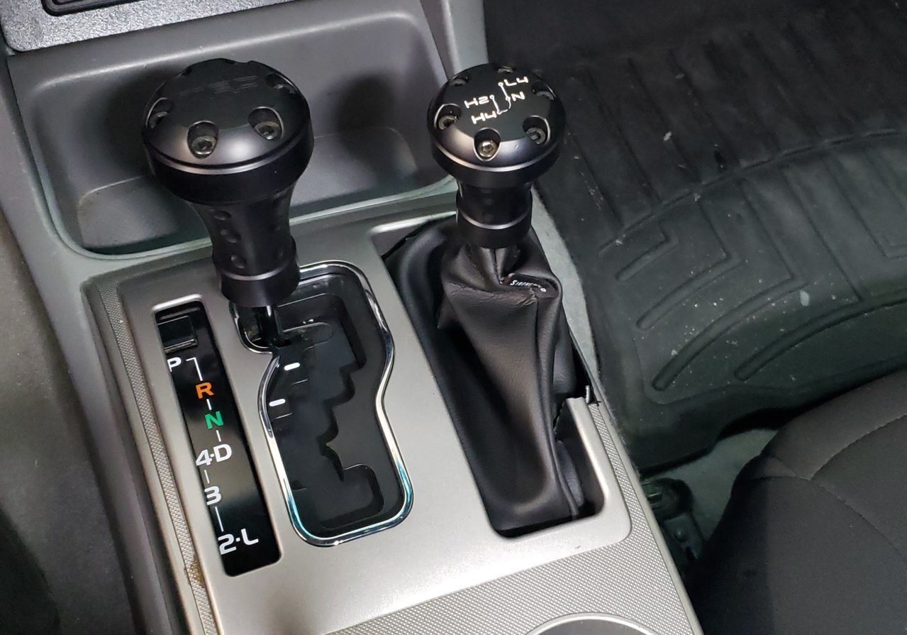

    Nicely done. I like how the knobs match.

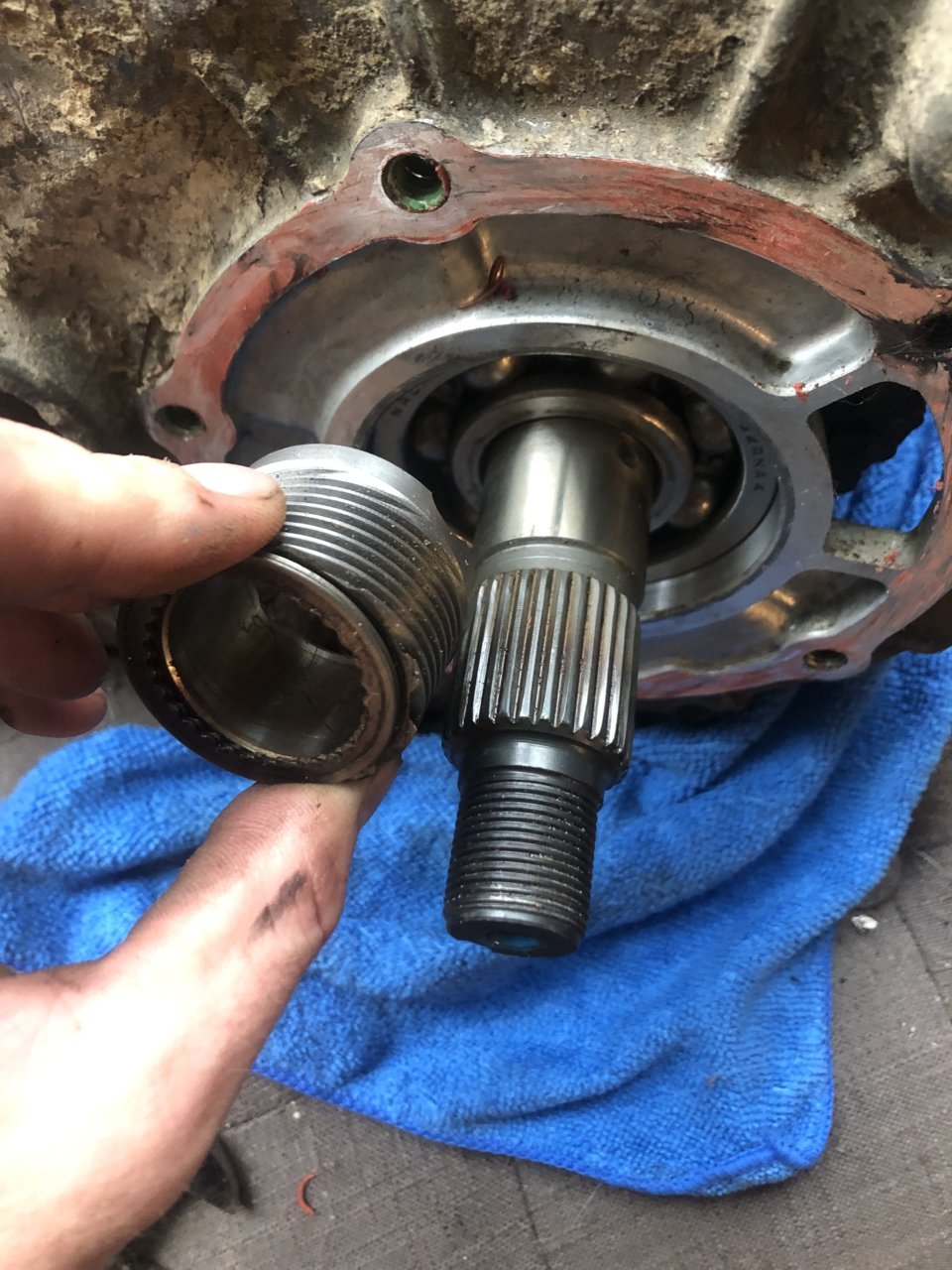

    Anyone know which direction this goes on? I got a tcase for basically free but it came in a cardboard box already disassembled. I checked schematics on an fj page I found and couldn’t figure it out. D05109A1-FA4C-47D5-A2CA-0C949B9024CD.jpg

    That looks like the speedo-ring gear to me. That belongs on the back side of the case. Some cases have them and others don’t but it can be installed on all cases whether they had it from the factory or not. There should also be a little ball and a shim that goes with that.
    If you look at the pic you posed, you’ll see a little hole in the side of the output shaft. That is where the little ball should reside. The little ball resides in a slot on the speedo gear.
