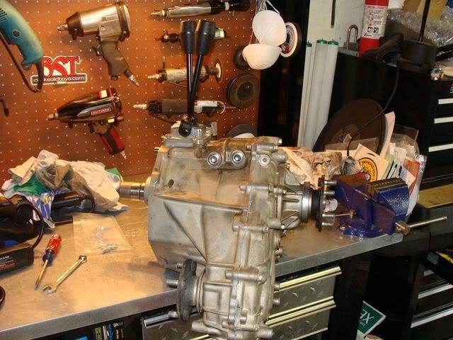

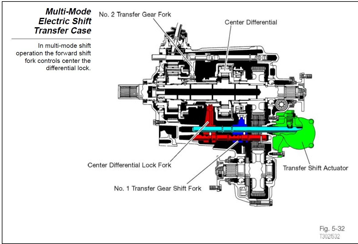

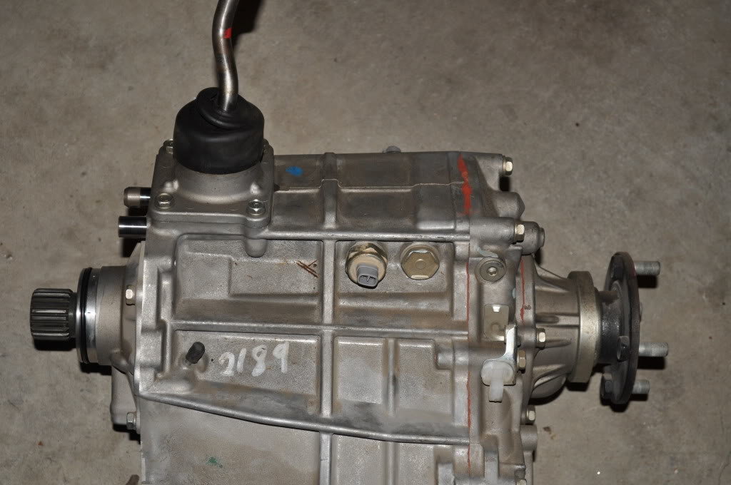

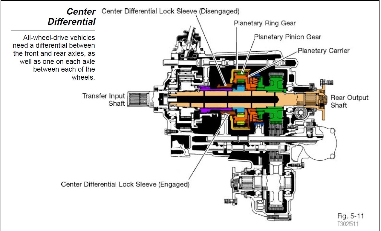

    To further clarify, you do NOT want a full time transfer case which is the fully electronic case filled with all the crap you are trying to get rid of. There are three types of transfer case operating systems: part time, full time, and multi mode.
    In full time transfer cases, there are two electrical motors to control the transfer case; the high and low synchronizer assembly and another dedicated to the center differential lock function.
    In multi mode transfer cases the high and low synchronizer assembly is engaged and disengaged using a floor mounted shift lever and 2WD/4WD and center differential lock are controlled by the transfer shift actuator
    The transfer case in the 03 4runner multi mode case is known as the VF4AM.
    The FJ cruiser transfer case is known as the VF4B which would be a direct swap for us tacoma 6 speed drivers.
    You can see the differences here. This is the multi-mode case found in the FJ cruiser:
    Here's the standard VF2A case from the automatic FJ cruisers
    A cutaway of the internals of the multi-mode case will show you that the center differential is behind the shifter base which causes the transfer case to be longer than the part time case.

    And the multi-mode case from a 4th gen 4runner has 2 electronic shift forks. One for 4wd and center locker, other for hi to low shifts
