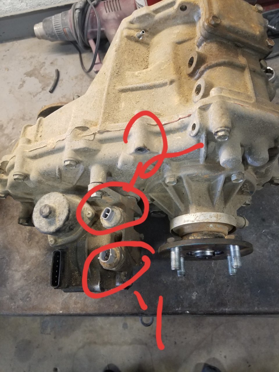

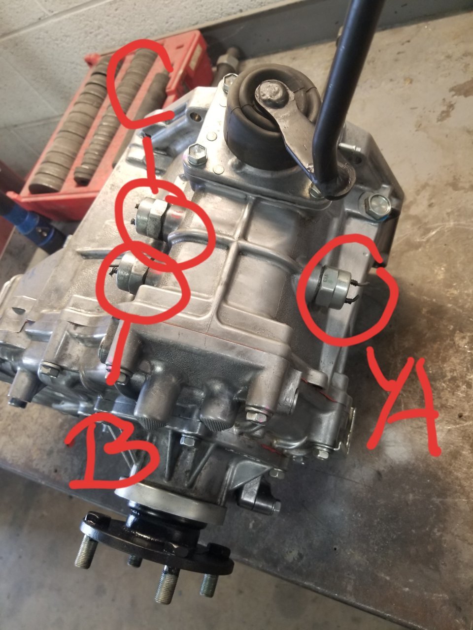

    Helping @TacoFMS install his fj transfer case. We need to know where sensors (1 & 2)from tacoma case get transferred 3 where on the fj case(A,B, &C). Can anyone help us out? We were making good time until now and we can't contact Wyatt. HELP

    Yep.
    Doh! Pretty sure you're right.
    FWD drivers 4WD
    AFT drivers neutral
    Passenger 4LO

    We got her now! Peeked at the wires on the other end of the plugs to figure out which sensor was which. The sensor with the external rib is 4lo, smooth outside plug is 4wd. So #1 goes to A and #2 goes to C

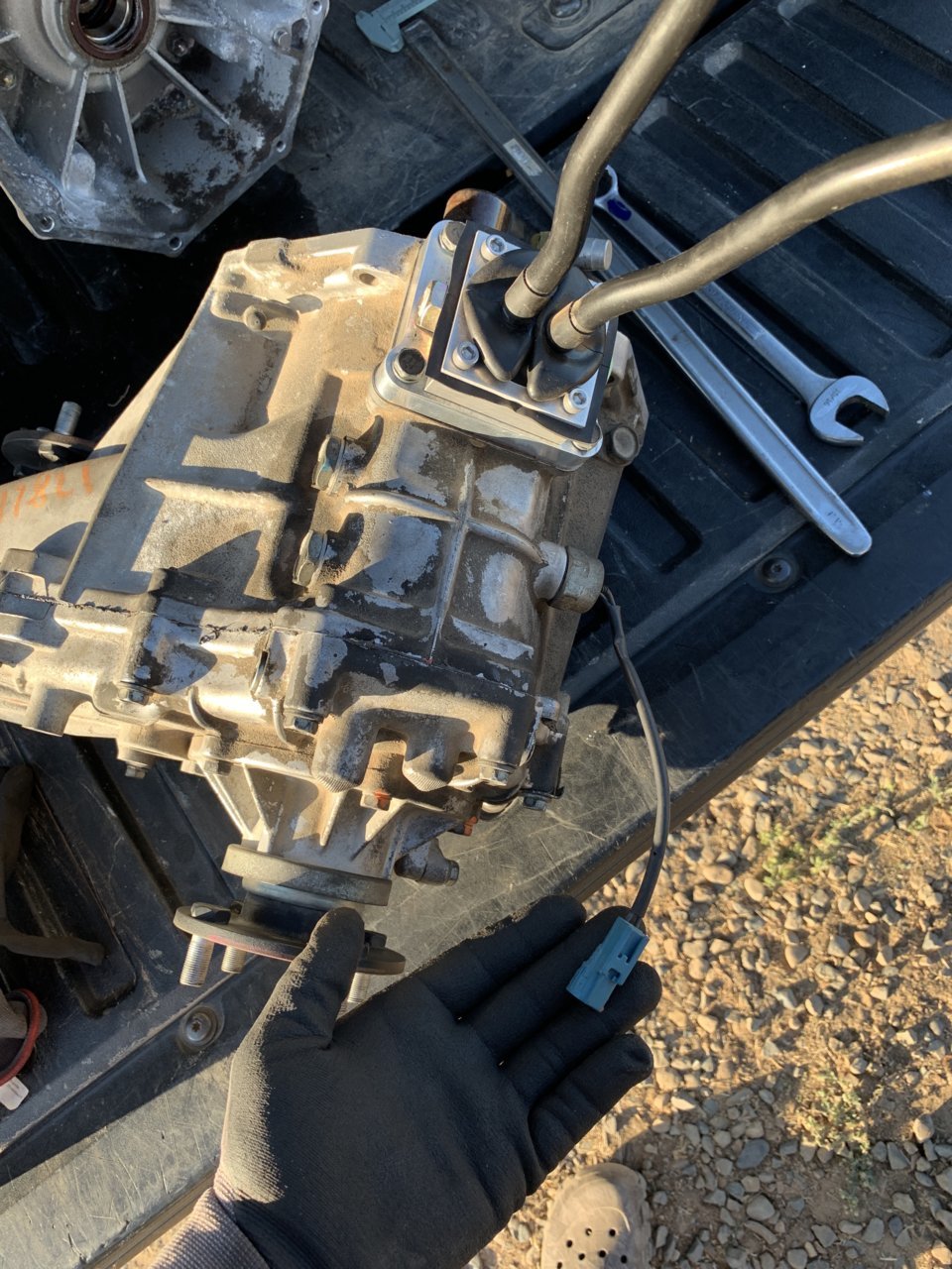

    You've got it right except the rear is neutral on driver side. I left the FJ sensor in that spot with wires dangling. Looks like you scored some plugs :thumbsup:
    If you're doing the ADD delete and gettin rid of the 4WD computer behind the glove box, its red to gray with black stripe and yellow to brown with white stripe. Mine was different from Wyatts write up.

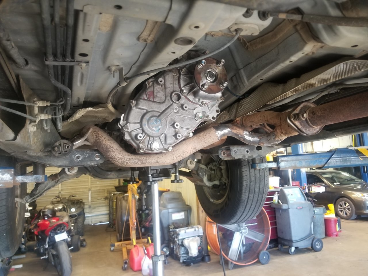

    Here is mine, thanks again to everyone in here for answering all my questions.

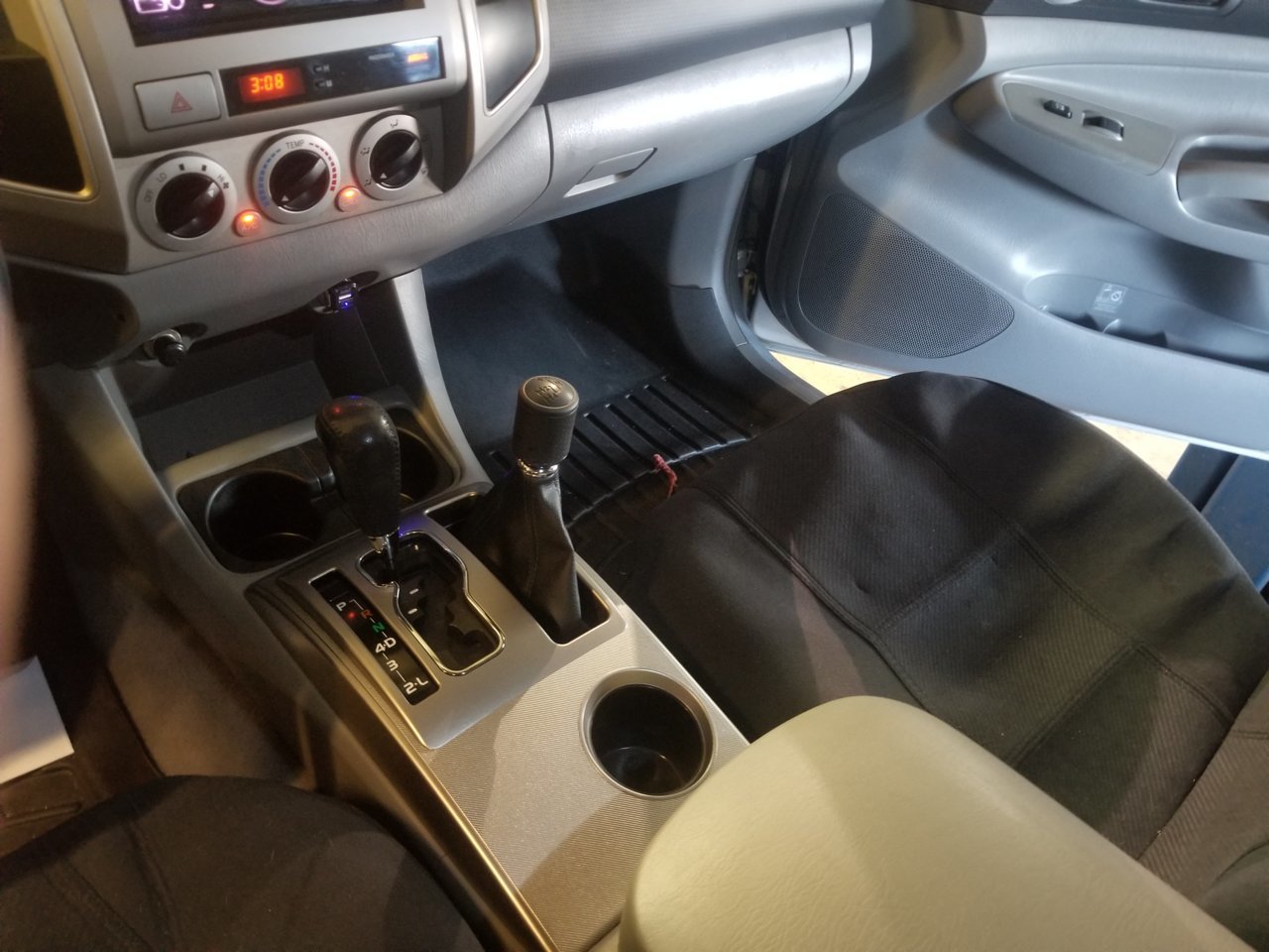

    Finally got my harness from Wyatt. I have been planning on doing this conversion for nearly a year - can’t wait to get started. TC has been ordered (just keeping it simple with the J shifter). Going to try and document the process as I go.

    Nice work, looks stock. Do you have any other photos of the shifter before putting the trim back on? I’m doing a 4wd conversion and am trying to decide on twin sticks or keeping the j-shift.
