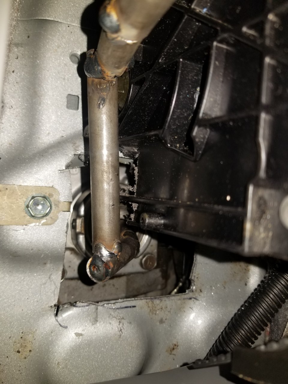

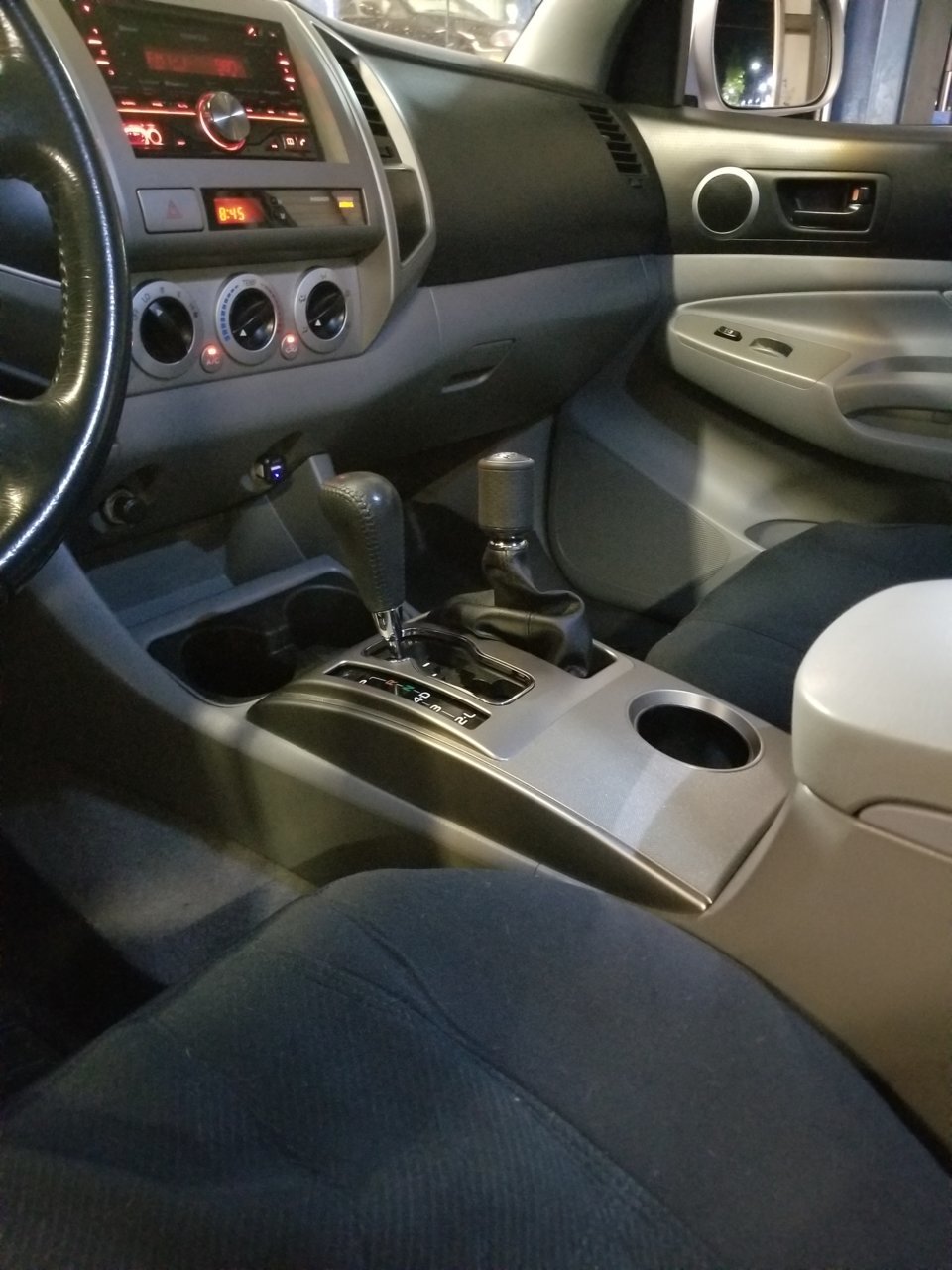

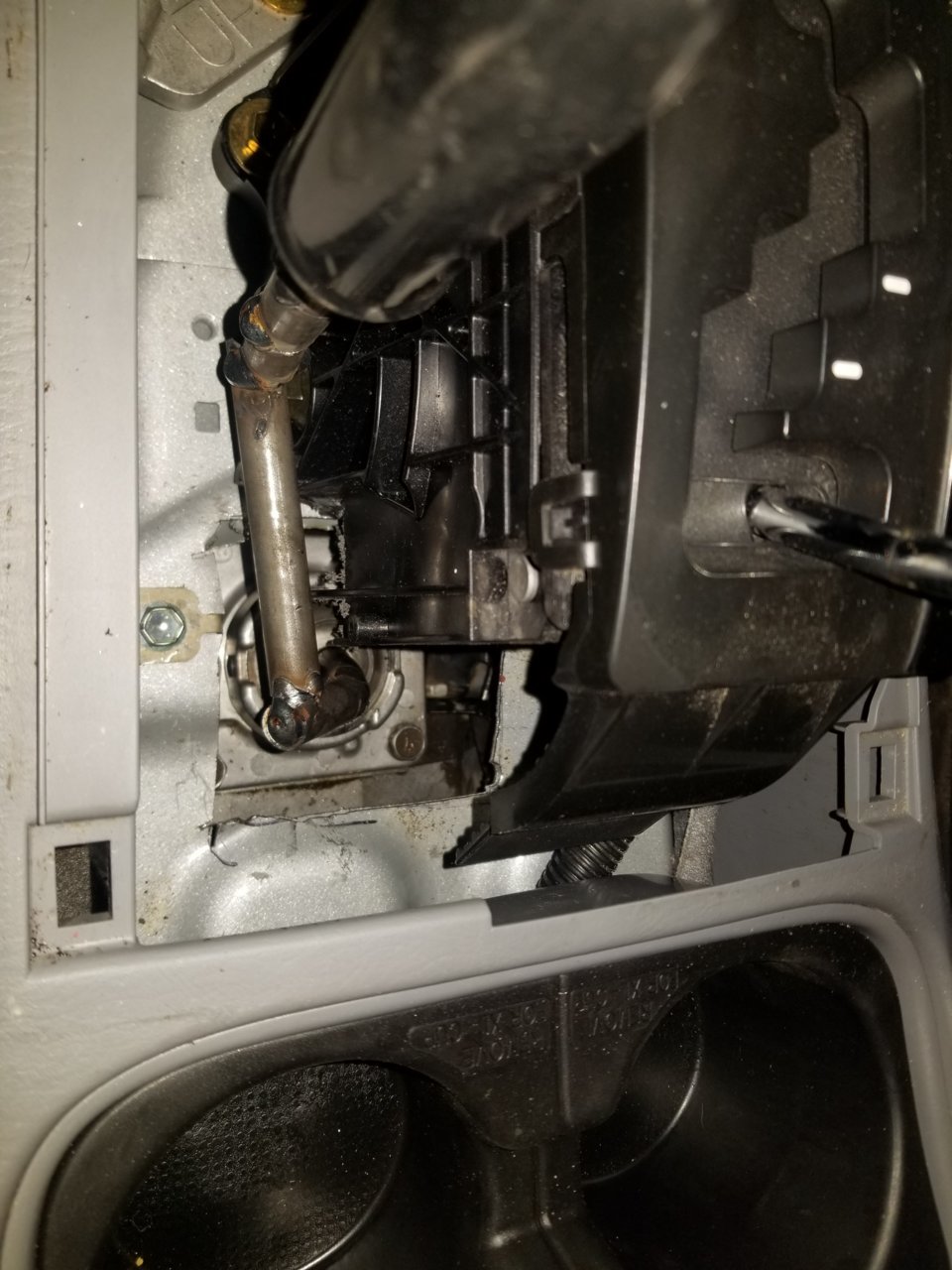

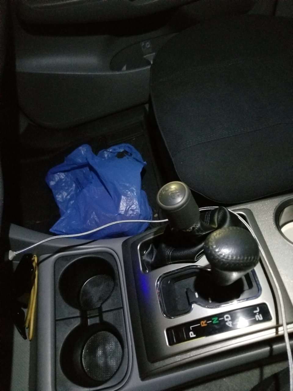

    This is after perfecting it. LOTS of dry runs and trimming but it looks stock and I'm happy with it.20190927_211147.jpg 20190927_204550.jpg 20190927_211251.jpg 20190925_195733.jpg 20190925_195719.jpg

    Also if your a prerunner and wanting to have your cluster lights work, there are no pins in the harness at the cluster. Meaning you physically have to find 2 tiny pins and put them in the cluster harness and run your own wires.

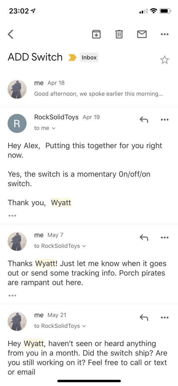

    I had refrained from posting anything about my experience with RST but seeing others having similar issues swayed me to add my bit.
    I called and talked to Wyatt on April 18th about an ADD switch and he agreed to put one together for me. He asked for an email with the vehicle specifics and I sent one later that afternoon. I paid $177.xx immediately and on the 19th he replied that he was working on it. May 7th I sent an email and called and got no reply. May 21st I sent an email and called and got no reply. I called twice between those dates and left voice messages and never got a reply via email, call, or text. On or about 28th I called and left a message for a refund. The first week of June I ended up disputing the charges and got my money back.
    This is the only reply I ever received.
    Needless to say, I won’t be doing business with RST in the future.
