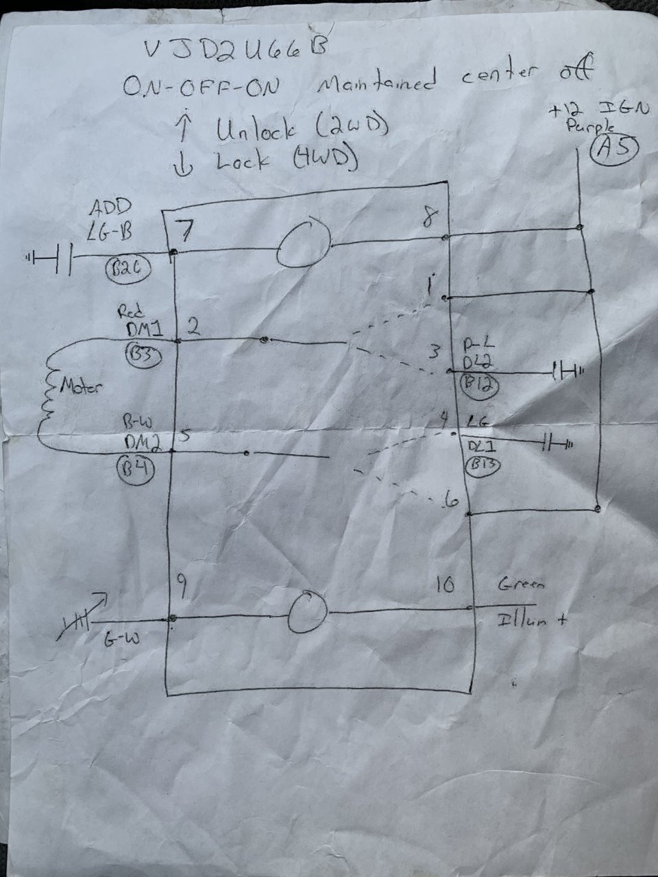

    hey I recognize that handwriting :anonymous:

    that crumple peace of paper

    Are you saying you recognize the handwriting because it’s your handwriting?

    yessir

    Cool. Well thank you. It was helpful when I did my 4x4 swap.
