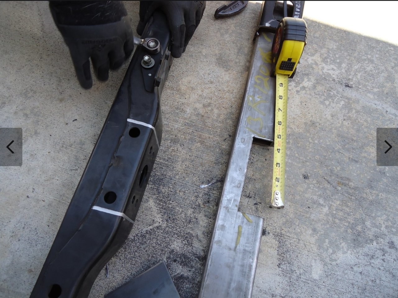

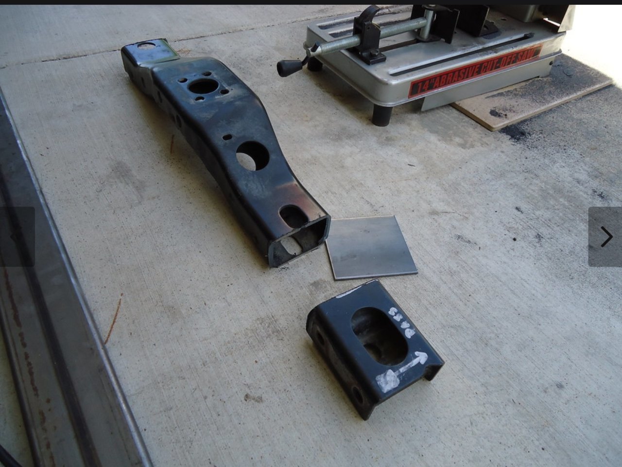

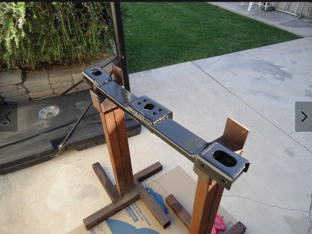

    So I couldn't find the template but found some pictures I had archived. Also some info, transmission mount only needs to be moved forward one inch but it looks like it was dropped as well in the pictures. I'm sure I can draw something up in AutoCAD. I'll be under the truck this weekend and take some measurements.
    Seems from the pictures just some tube steel was utilized and the existing mount was welded on center and up 1" in between the two existing crossmember mounts.
    We may have a template after all....
