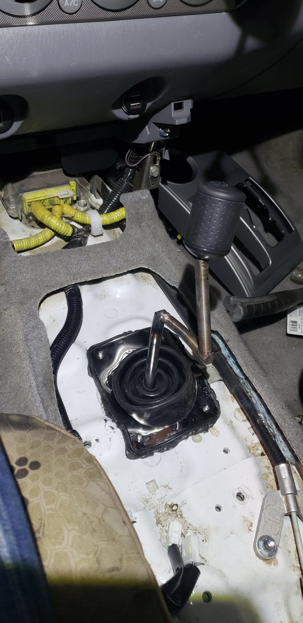

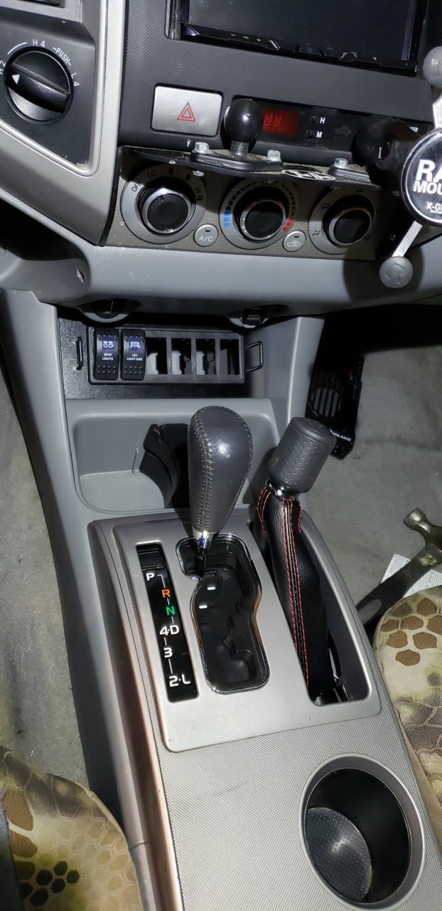

    It was a long process but I'm finally buttoning it up. Gonna change the location of the TC knob further back, but it functions and doesnt look bad. I just want it perfect. I need to finish the shift boot too.
    I did the TC swap, add delete, and 4.88 gears all at the sale time so my truck was in shambles for weeks.
    Anyway here you go.

    Kept the J shift pattern on the single stick. Looks like stock. :thumbsup:
    They should have come from the factory like this.
