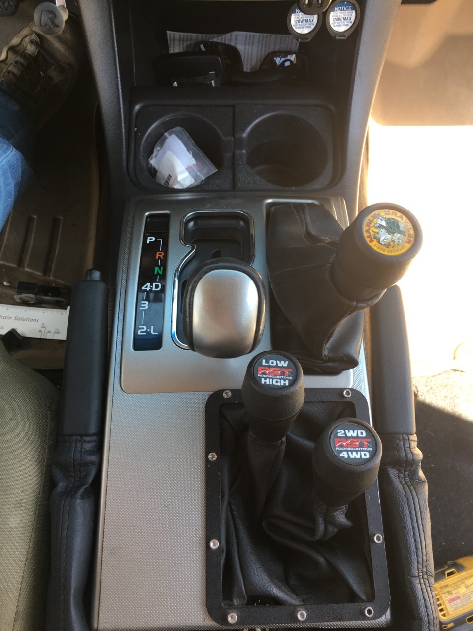

    Nic
    2010 TRD S Double Cab Ext Bed
    Toytec Boss Toytec add-a-leaf SPC Control Arms Nitto 275/75/17 Ridge Grappler

    hopefully my end result is close to looking like that
    Looks great
    nednic[QUOTED] likes this.

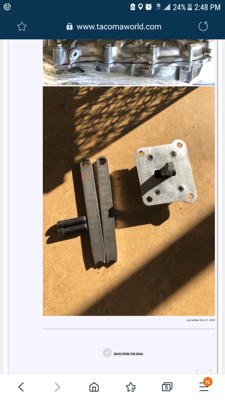

    I only seen ome picture somewhere! He doesnt have pictures on his website of the actual product just finished center console pix. Its kind of like TG but wider base plate and each stick is pinned on the side
    Here is a upside down shot of someone on here that was trying to sell it
    The only thing is that it's not ready to go! I think there is welding required Before you could even I use it.
    HomerTaco likes this.

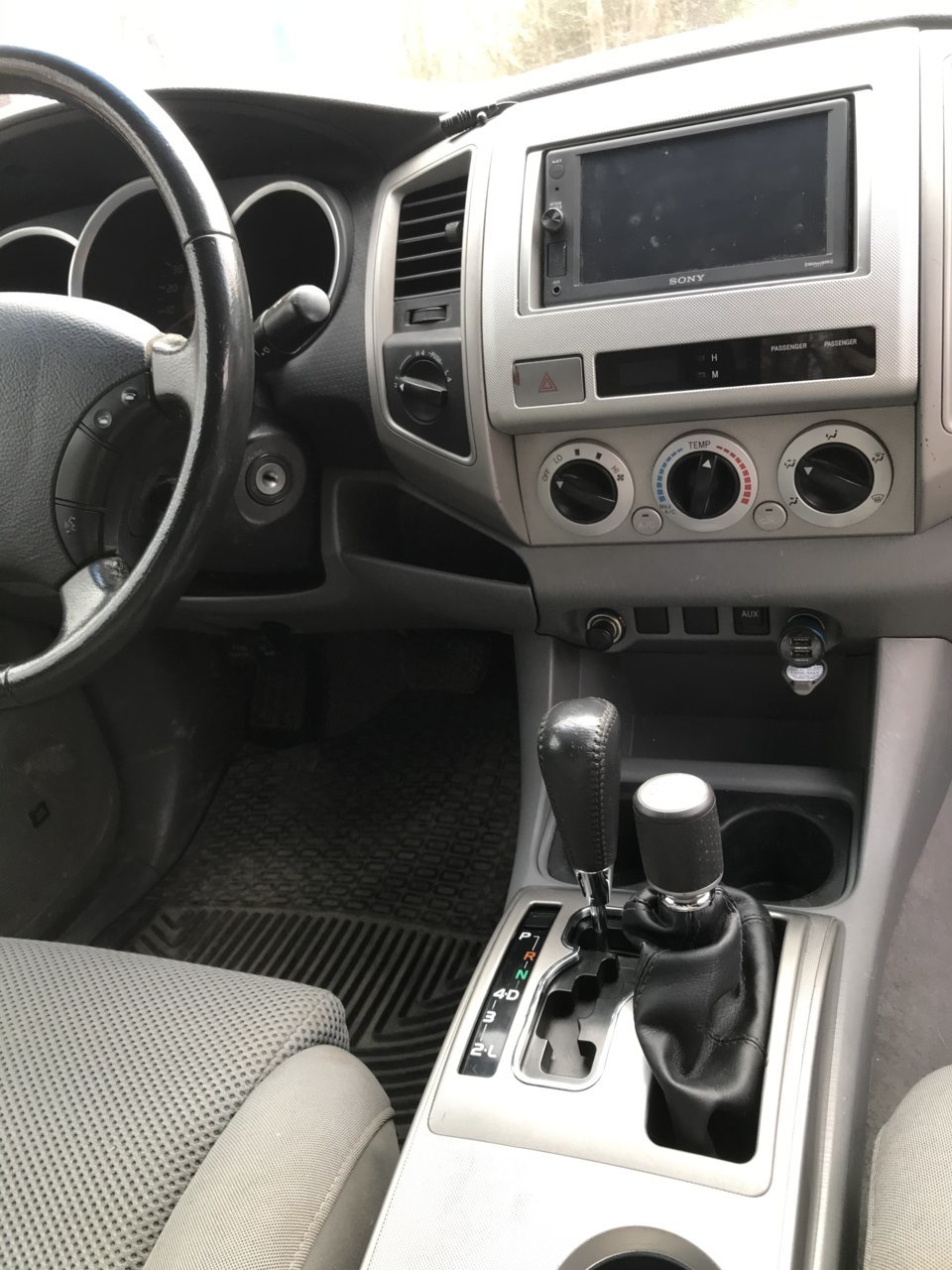

    I don’t... I’ll see if I can get one. My cut was fairly large because I wanted to be able to access the top four bolts through the hole.

  18. Feb 21, 2020 at 11:31 AM
    #778
    jowybyo
    jowybyo Well-Known Member
    Nov 19, 2013
    #116863
    6,092
    Joe
    Baltimore, MD
    '14 MGM DCSB Postrunner 4wd Conversion, Debadged

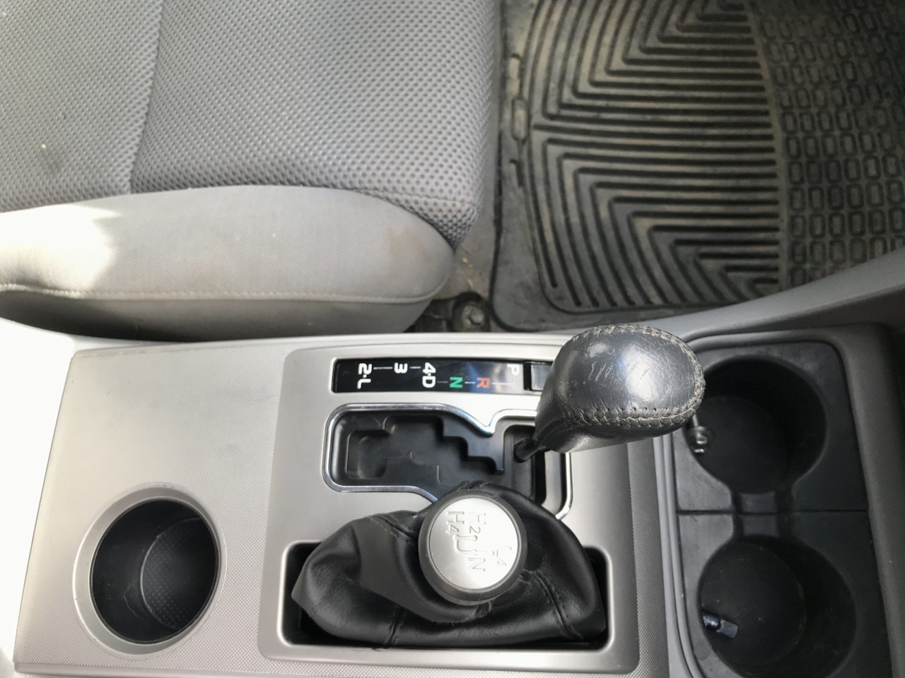

    How did you manage to get the range to shift into 4LO while keeping the hole inside the little coin tray? I had to cut about 1/2" further to the passenger side and about a full 1" further forward to be able to shift into 4LO.
    My cut ended up like this:
