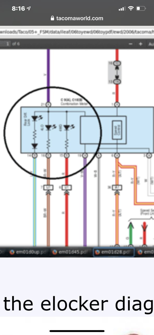

    I have another stupid question. I’ve checked all of the FSM and various videos and posts and maybe I’m missing it. But I don’t see a gasket being used between the fj tc and the trans. Am I missing something or are you all using etc gasket maker ? Or a Toyota supplied gasket ?

    So you just tapped into those two the green and white?

    this is the one from @lucky and I’m sure his truck is the same. But wanted to double check before I cut anything.

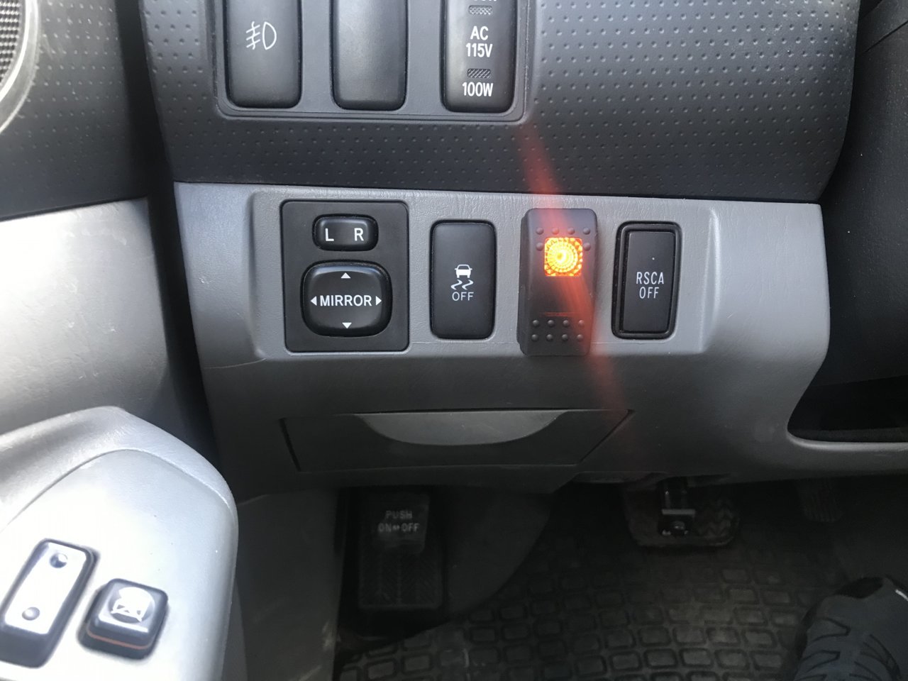

    New ADD is in, switch seems to be working. Will be ready for the test drive tomorrow.

    There's 2 empty spot on that plug. White is 4Lo green 4Hi.
