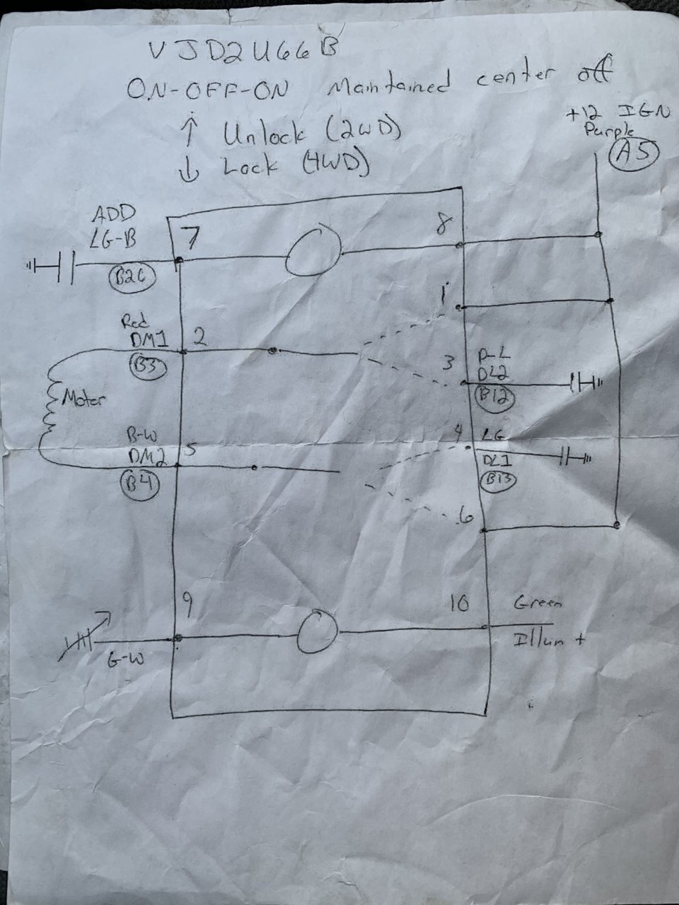

    How you get your switch to light up?

    Figured it out. Add those two wires. And run them to the tc

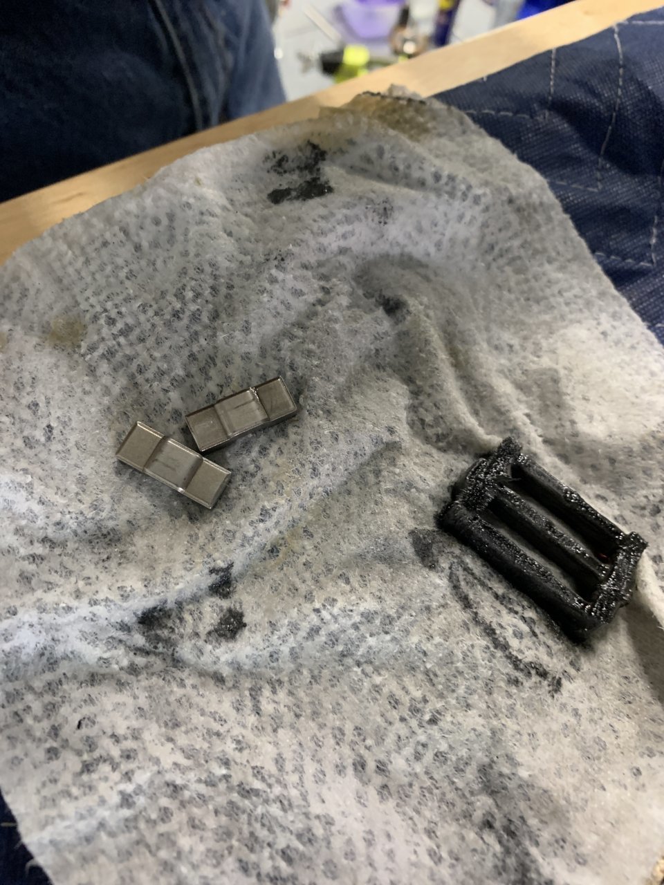

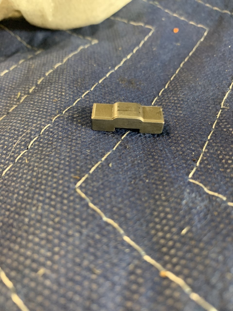

    Split the case in 2wd and found this little shit sitting inside waiting for me.
    I don't really have the time to go back and re-read 42 pages, could someone share some wisdom and guidance on where that little key goes?

  8. Mar 2, 2020 at 9:58 AM

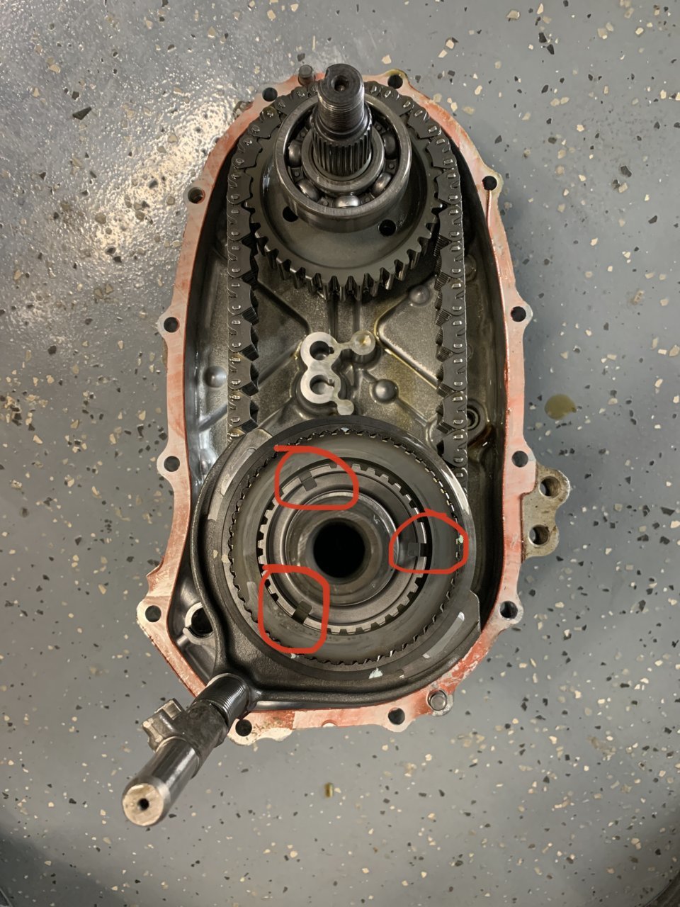

    I had the same issue. IIRC, the keys fit into slots circled in the pic blow. Slide the outer gear up, then hold the keys in place and carefully slide the outer gear back on.
    dborrer, TacoFMS, 6 gearT444E and 2 others like this.

    HomerTaco
    Mar 28, 2010
    #34129
    45,874
    HomerTaco
    HomerTaco
    HomerTaco
    Correct
    hoverlover likes this.

    yep that's where those buggers hide out

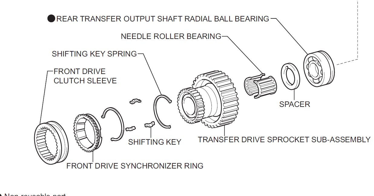

    TacoFMS and hoverlover like this.

    Don't recall who said it but they were absolutely correct: wish I'd never seen them before.

    Got it, thanks guys

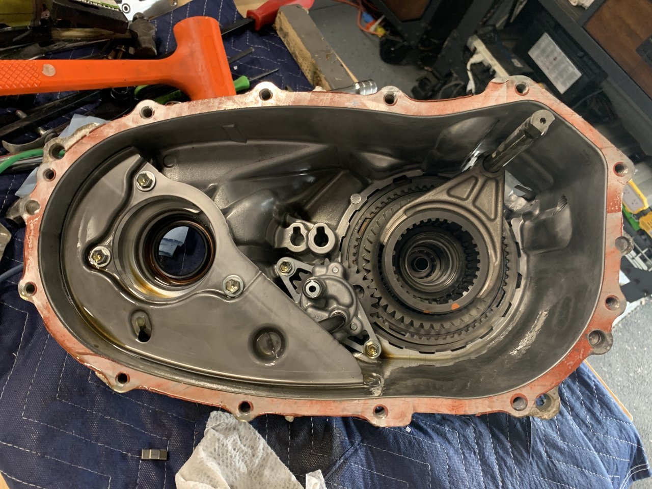

    Thanks for the help guys. I just pulled the other fork and realigned the sync ring, wasn't too bad just took a bit to figure it out
