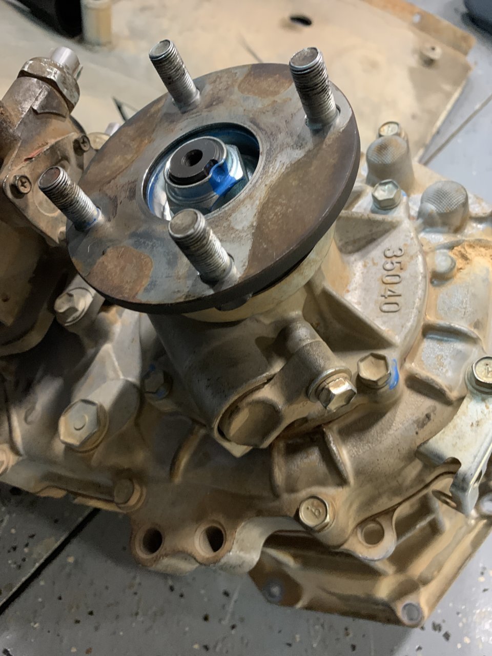

    Doing the harder part of the swap this week and in about a month or so I’ll do the rest (regear & install front diff, extended axles, hubs etc)

    I saw that you hadn't swapped your sensor over and was going to ask you about that.
    Pull that plug out, and look to see that there's a worm gear on the tcase output. If there is, you are good to go, just swap your sensor from your taco case. If you can't see a worm gear on the output shaft, I got some bad news for ya...
    If that case is from a 4runner there's a chance you don't have the worm gear on the output and you're pulling that tcase, splitting it again, and replacing that smooth ring on the output with the worm gear from your taco case.

    There's a worm gear in there, but the xfer case out of my taco doesn't have the speed sensor on the output. Apparently it reads off the rear wheels. I posted that question and then found an article.
    My old taco case.

    I wasn't aware that had changed. So you should be good to go then.

    Ya me neither. I spent a good hour and a half trying to find something online about where the speed sensor was when I posted that. Like a minute later I found a site with that info. Was thoroughly confused for a bit though!

    Auto Tacoma’s use the wheel speed sensors, manual Tacoma’s use the speed sensor output on the t-case, simple as that.

    My taco t-case didn't have anything where the sensor should have been on the back side of the case. It had three plugs total, 2/4wd sensor, hi/low sensor, and the 6 pin for the actuator.

    that’s weird. They must have changed it up then. Mine is 2010 and had that sensor in the case, I saw yours was 2013. I know the 2012 went through the facelift maybe that’s when they changed the wiring a bit??
