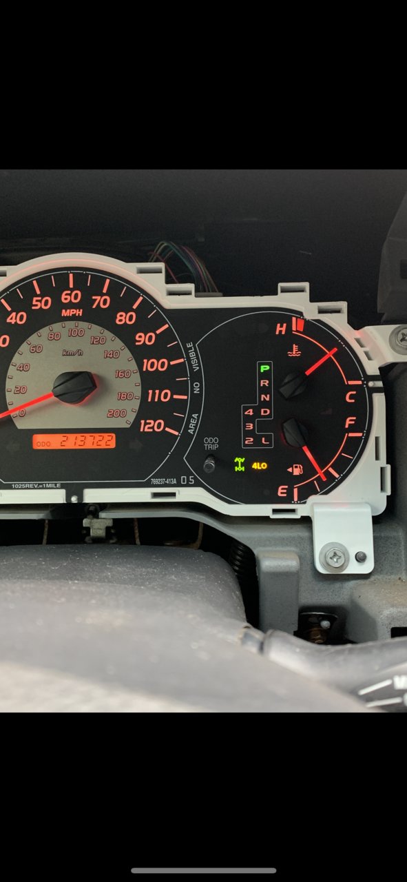

    Guess I can finally contribute my FJ case to this thread now!
    Here's an in-progress pic from today

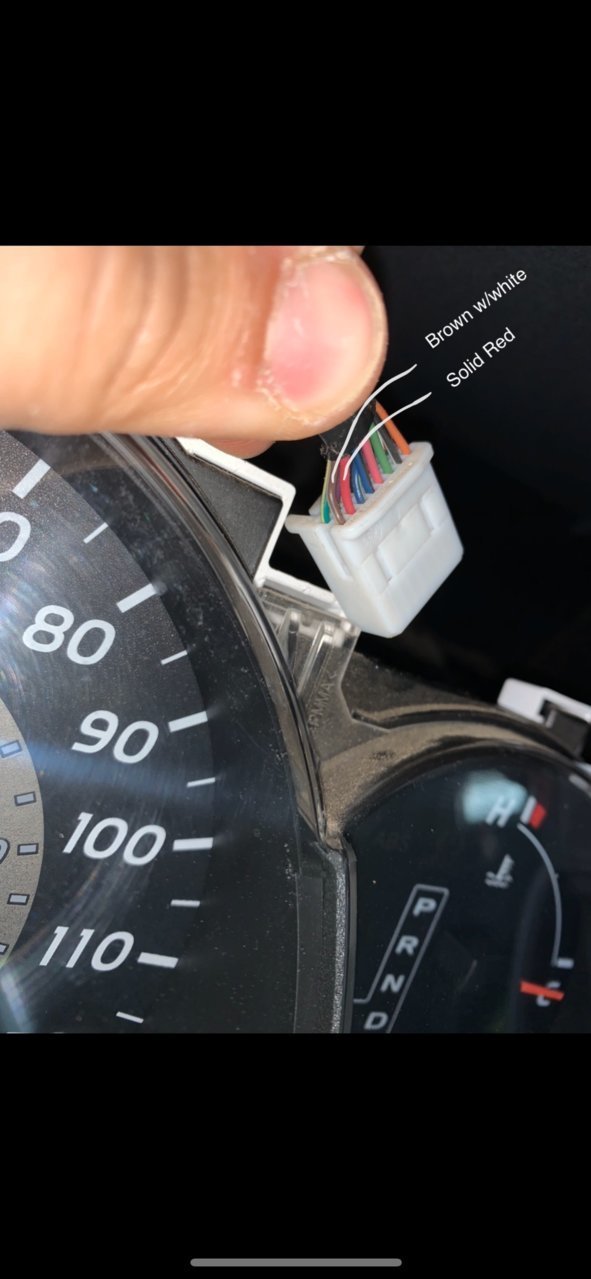

    Here is what I found behind the right side of the gauge cluster. Pic included
    so per what sae/new life described the left most wire is the 4Lo (brown w/white) and right of that is the 4hi (solid red) which aligns with the write up from Wyatt for the glove box connections.
    so which one do I try and connect it with to get the lights to align with the shifts? The tcase sensor wires or behind the dash?
  16. Mar 10, 2020 at 5:54 PM
    #876
    Newlife
    Newlife Well-Known Member
    Jun 22, 2013
    #106845
    8,570
    Adam
    Knoxville TN
    2020 t4r orp
    Bone f’n stock for now
    @Southernstrutter
    Southernstrutter likes this.
  17. Mar 10, 2020 at 5:58 PM
    #877
    Newlife
    Jun 22, 2013
    #106845
    8,570
    Adam
    Knoxville TN
    2020 t4r orp
    MAybe that will help.

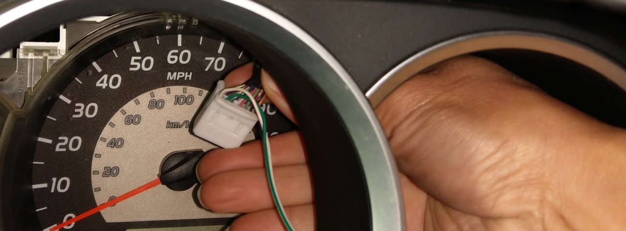

    Verified that my connection for the correct pin locations was as Wyatt described. No grey w/black stripe on either of my ecu plug ends...
    I’m going to cont. test the actual light wires on the gauge cluster to see if they even work but if not I’ll have to come up with something.

    UPDATE: so this weekend I got around to cont. testing the actual 4wd light wires on the small plug (right side) gauge cluster plug. Both red and brown&white
    As detailed in the picture from the most recent post.
    got nothing.

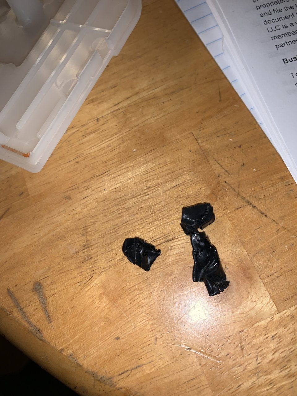

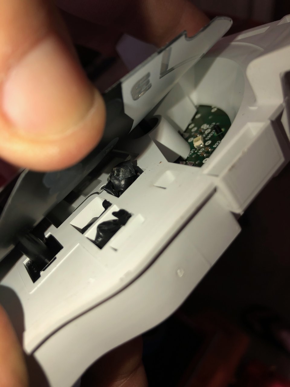

    so I figured I needed to pull my gauge assembly apart and test the actual led connectivity... while disassembling I found this..
    Someone had shoved wadded up pieces of electrical tape into the square holes on both my 4wd and 4lo light channels on my gauge panel!!!! WTF. I cannot explain it. I bought the truck in 2015 and the previous owner must have done this.
    Maybe he didn’t like the flashing lights? Hence the whole reason for my swap being that the original e tcase wouldn’t work?
    they’re working flawlessly now.
