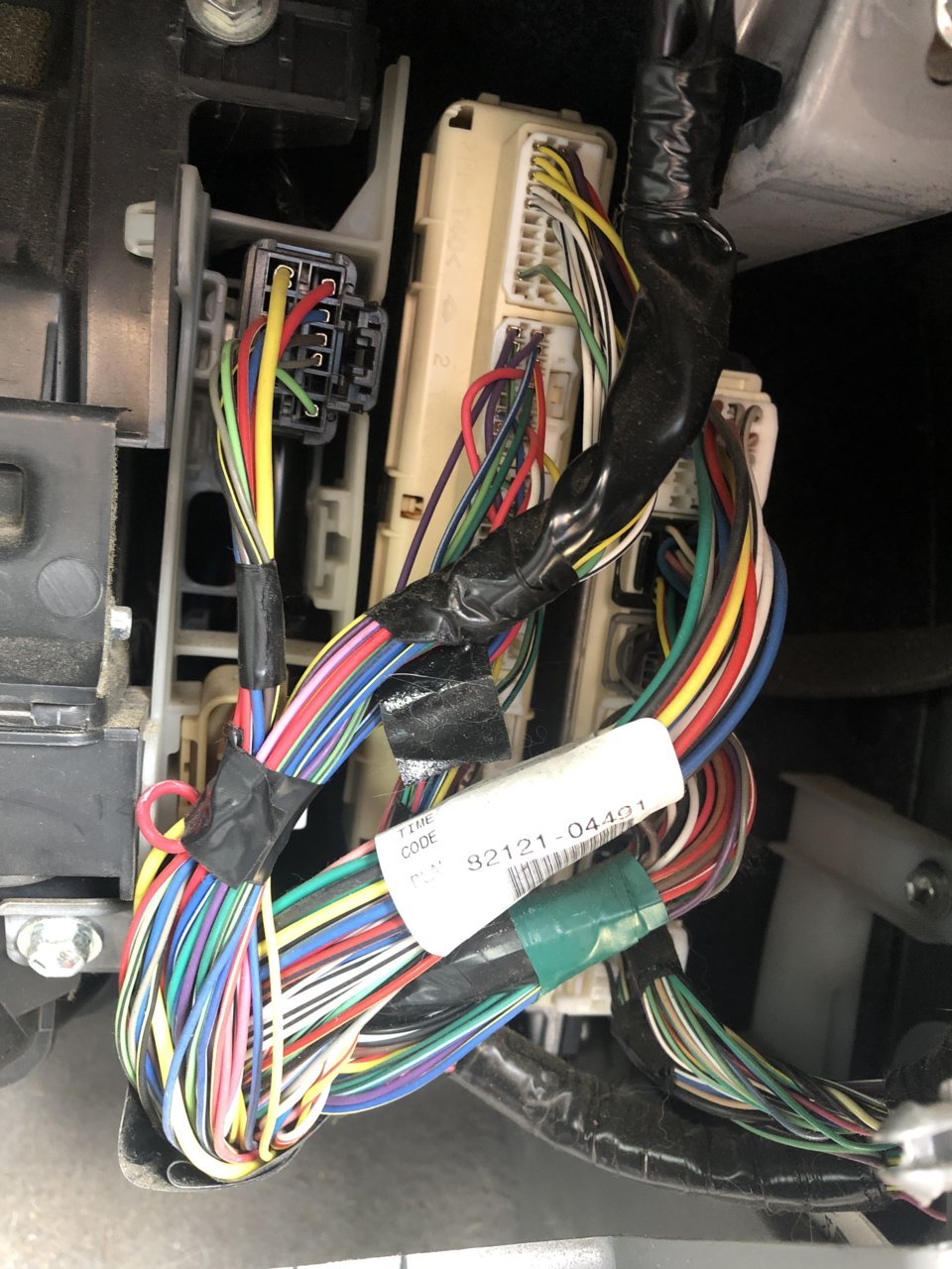

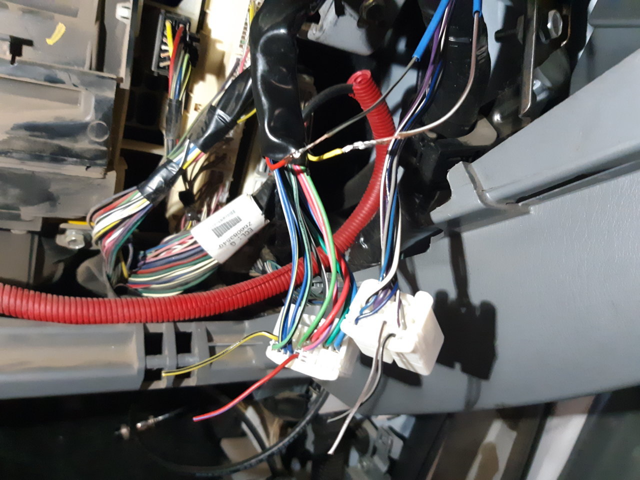

    Still blows my mind. When I cut the ignition off to shut the truck down my rear diff lock icon lightly flickers now that the ports are all “untaped” curious as to why. I have no rear factory diff lock button or addition, but the wiring is there.. onto the next mystery lol

    which plugs are these. Lots going on here.

    none of those, look above the glovebox

    Look up! The control computer is mounted up under the dash. Above this location
    2nd Gen Tacoma Wiring for FJC Case Install

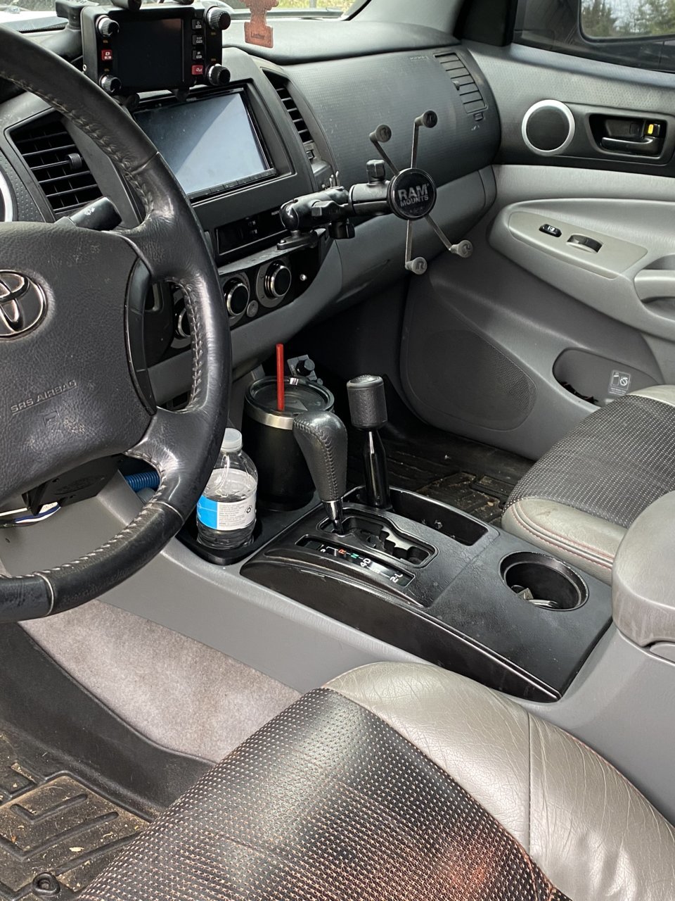

    Mine is complete. Thanks to everyone’s pics it made moving the handle over into the pen much easier. As well as drilling the hole. We got away with only a single 3” hole and no extra cuts fit in there like a glove.

    Quick question though how are you all attaching the shifter boots? Is it just a stuff it down in the cut out and go or glue.

    Yes sir. I’ll post some pics of the setup once I get back from the alignment shop and the muffler shop.

    Now I just need to figure out a boot. I went to oriellys today and found a 5” round rubber boot and used some small self tapping screws and put it over the shifter base for the fj tc.

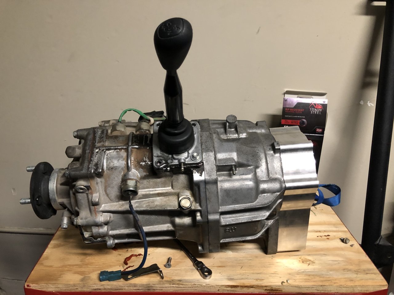

    Hey Jerez! So that 3rd gen 4runner shifter worked perfect with the fj t case shift base plate? I’m looking for a t case shifter and came across this. If so I’ll be searching also for one of these. Thanks!

    the chain driven Toyota shifters are all the same.

    Oh awesome thanks! That makes my life easier and less expensive. I’m going to cut up the shifter anyways so i didn’t want to buy an expensive one.

    sorry man I didn’t see the tag; yea it worked great
    I cut mine too but I haven’t weld it back on to the location I need it at since this whole thing is happening so I’m waiting (no need for it)
