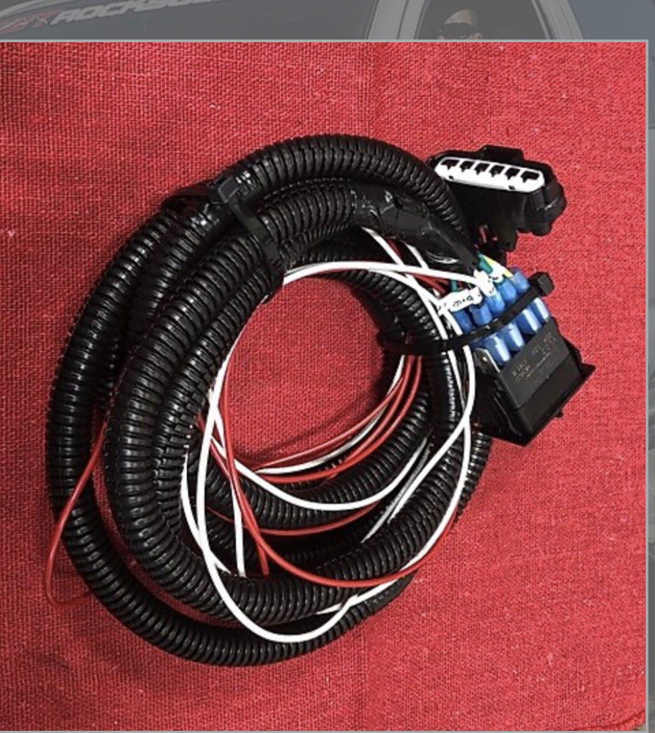

    Ok read the thread have a few questions I’m kinda half assing this for now if I attempt due to budget constraints. Plan so far is fj case with J shifter and if I use this rst harness does it plug into the glove box harness and would I have to splice anything? I’m not concerned with ign/ground taps or dash lights working since it’s mechanical now just if the add will function properly.

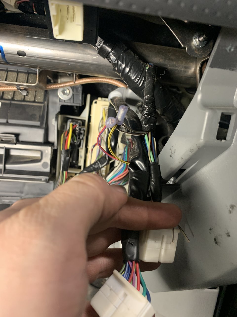

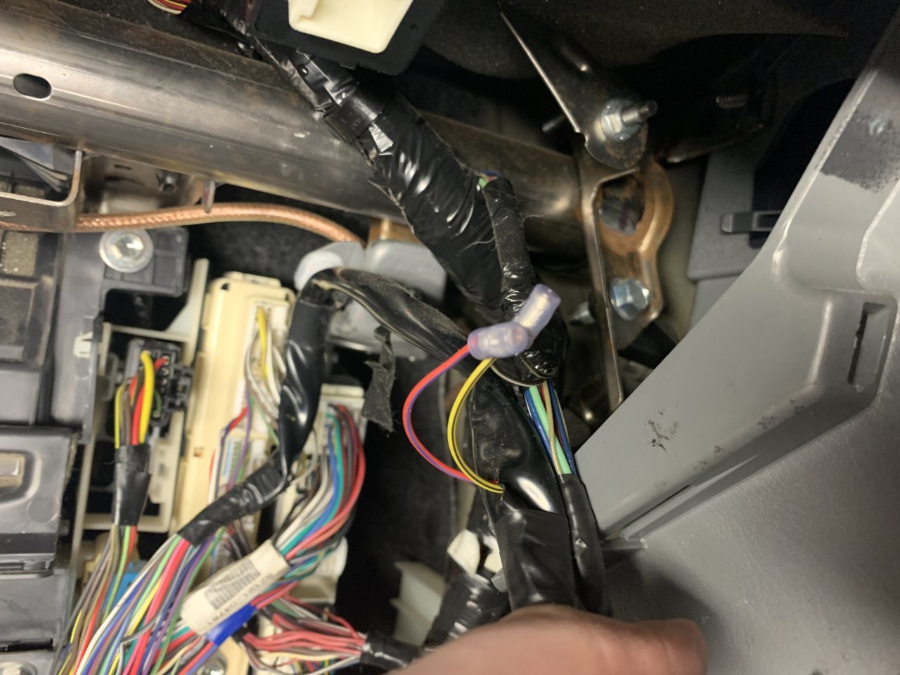

    You'll cut two wires in the glove box and splice them.

    @MattCowsmasher I was half awake when I read your post and misread it. The wires behind the glove box will make your dash lights illuminate correctly. I'm not sure how it will affect the ADD.

    If you're doing the FJ tube swap with the FJ tcase then you don't need that or any other harness since you're getting rid of all the electronics except the sensors. That harness is for people who are keeping their ADD. If you do the ADD delete, just those splice the two sensor wires that Alex mentioned behind the glove box. That will bridge the existing wires from the tcase to the dash.

    If money's tight at the moment, I'd hate to see you spend $170 on that harness. At that price you are over half way to the FJ tube and that's buying 100% brand new parts and replacing the bearing. I know wiring isn't for everyone, but to keep the ADD, it's a night in front of the TV with soldering iron, few bucks worth of switches, wires, and the actuator plug which you can either re-use yours or I'll send you my old one if you want to pre-wire a harness. Just something to think about.

    Thx you make a good point let me drink on it I may just just do the tube and wait for the twin sticks. I currently have the 2lo module for the oem Tacoma setup I can sale.
