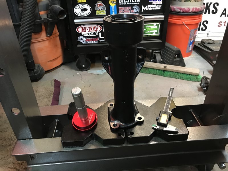

    Forgot about this thread. I threw in the FJ tube a couple of weeks ago too.

    Whats the point to swapping the axle tube?

    Eliminates the ADD

    10/4 looks like I'll be ripping one of those out of the donor truck too
