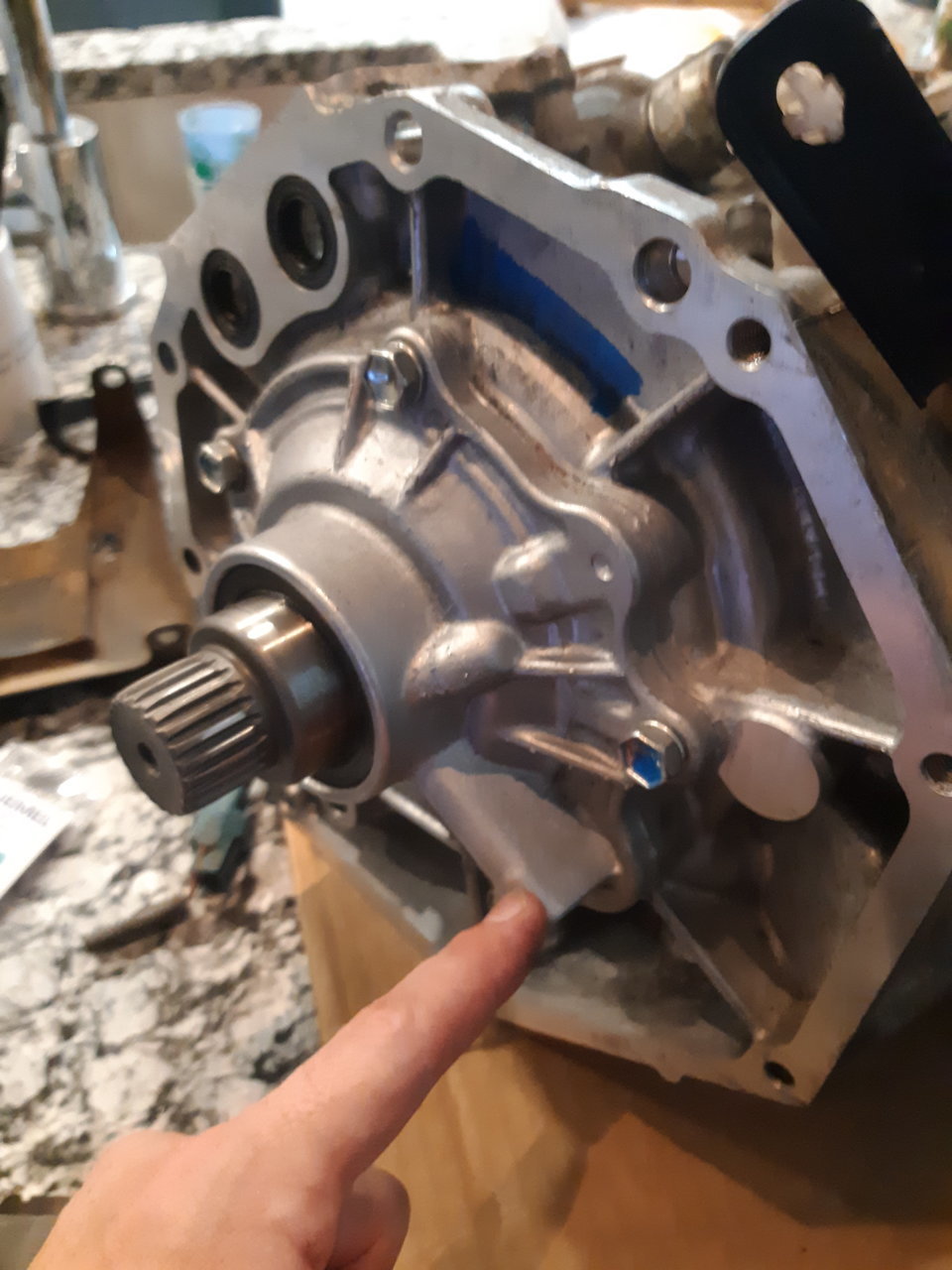

    Evening gents, trying to tackle the input shaft swap tonight. Does anyone have tips on how to remove the input shaft cover? I am trying to get mine off but there is no where to pry and it's sealed really well.

    hit it with a hammer? which cover is it? take a pic.

    3 tons of fun
    Give it a twist? Maybe tap on that elongated part I'm pointing to with a rubber mallet?
    There are no alignment studs or whatever you call them, so it should help break it loose.

    got everything torn down, swapped, and put back together.. tested function and all is well. Ran out of time but I'll take it back apart and seal it up tomorrow. Do y'all see any issue using toyota FIPG? I don't have any red RTV on hand. Also noticed there was thread sealer on the bolts for the cover for the input shaft. Can I use red locktite on this or do I need to track down the sealer?
    Thanks for the tips fellas! She put up a battle but I sharpened the end of a flat head screw driver and used that as a wedge
    Great minds think alike!:D
    I have had this FJ sitting around for probably 6months lol. Couldn't summon the courage to split my case so I Bought a 6spd taco case yesterday off @hoverlover to use to swap input shafts so it didn't matter if I messed something up. For once everything went smoothly though
