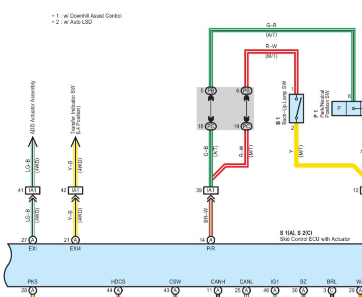

    yes, the position sensors for 4hi and 4lo feed into the skid control ECU as well, so it will turn it off.
    No, it's above the glovebox you have to remove the plastic cover where the latch is and look up

    It would do the same thing, the feedback from the ADD and 4lo position signal will be lost. The only way to make it work like stock is to splice the wires into the transfer case position switches

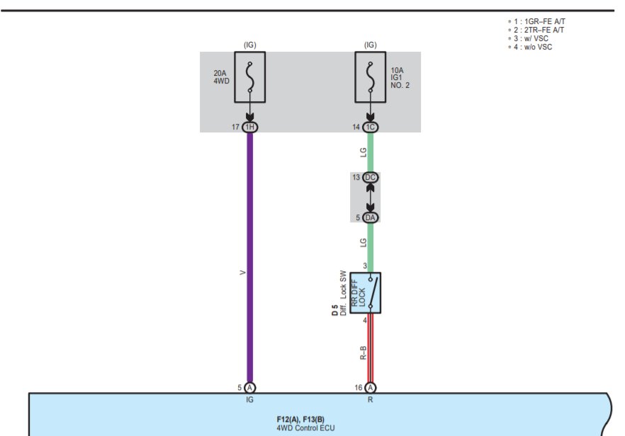

    Here's where the 4wd ECU is located
    As far as the AWD case, the center diff lock is done internal to the cause using the shift lever. There is a high, high lock, neutral, and low shifting pattern. There is a position switch to determine if it's locked or not, you can wire that up to the 4wd light if you wish.

    that’s correct. The AWD case doesn’t have a 4hi switch on the case it’s. “Center diff locked” switch. You would wire that to where the existing 4hi wire was and the 4lo would be wire the same as the taco or part time fj case. The skid control needs to see those switches to be able to activate different modes of traction control, as they are different between 2wd and 4wd as well as in 4lo the traction control is disabled.
