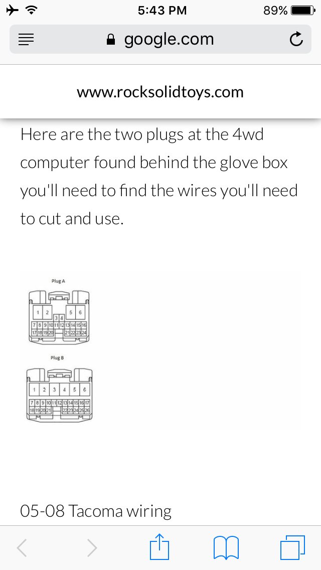

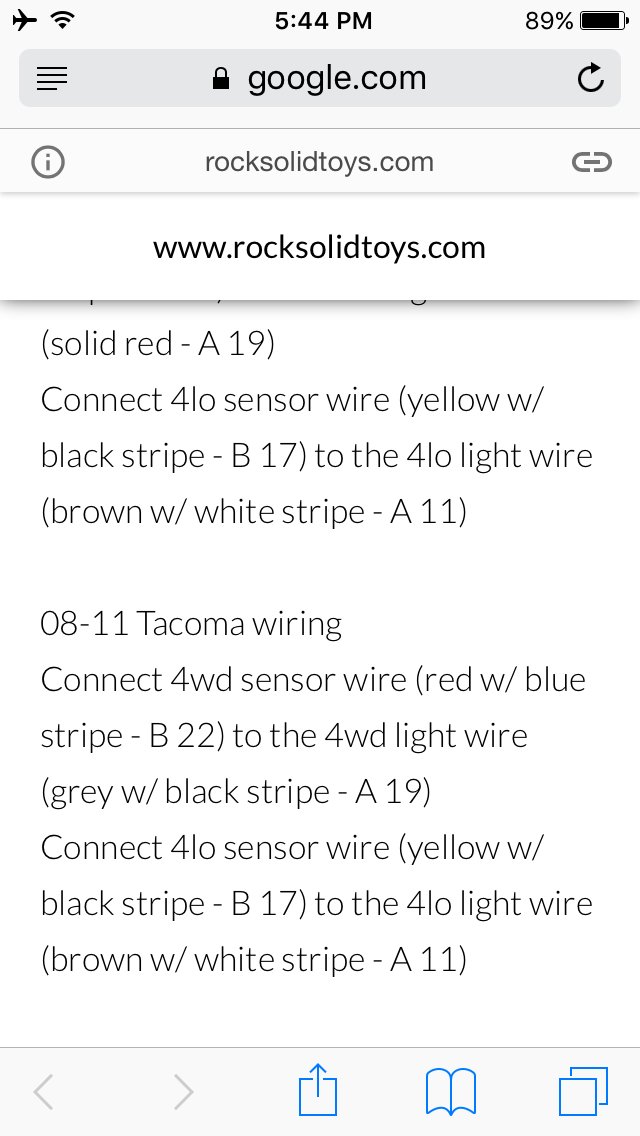

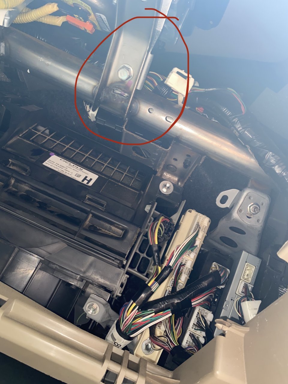

    @BassAckwards im confused. Which one controls the 4lo and 4high sensors? Plug

    Here's a little info on the plugs. I am not sure if your prerunner would have them since you're doing a 4wd conversion. Maybe someone else can chime in on that

    Lol idk even know which wire or plug that is.

    Is the 4wd control modul the silver or black box?

    If I remember right the 4wd ecu should be up here.

    All you do is make the connection but I’ve got a prerunner and I’m doing a 4x4 convesion so I’m thinking I don’t even have the box but i thought maybe the wires would be there anyway because Toyota doesn’t separate wiring. They usally just tie up what you don’t need between models. I’m looking for pin f12 which I was told was behind the glovebox on a prerunner l.

    Those plugs are more behind the dash were the airbag would be more than behind the glovebox

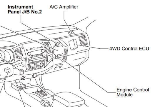

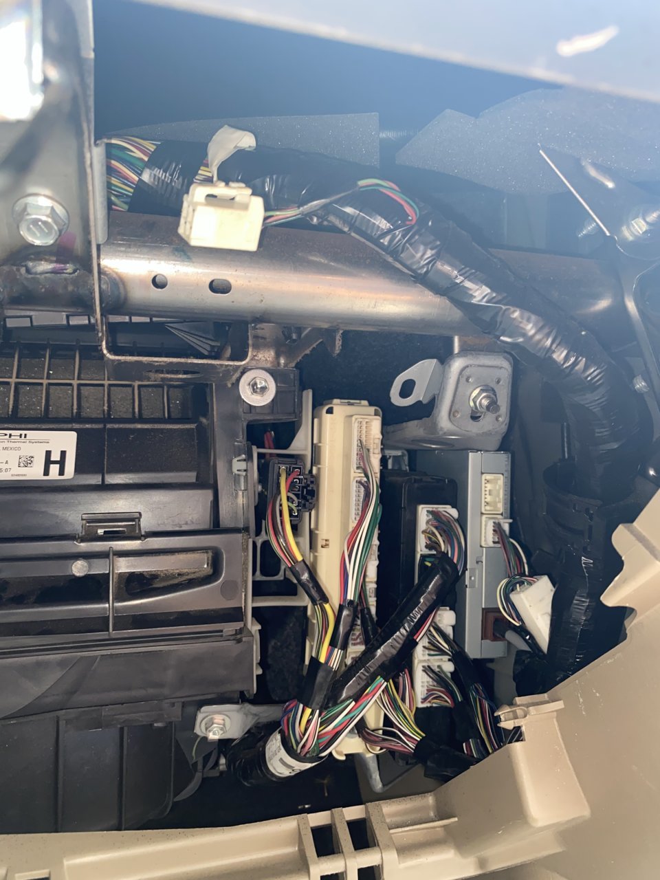

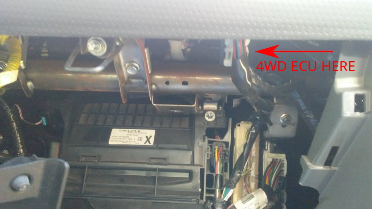

  15. Jul 26, 2020 at 4:17 PM
    #1095
    wrmathis
    wrmathis Dark Lord of the Sith
    Sep 10, 2008
    #9126
    9,467
    Bonaire, GA
    2006 Tacoma TRD OR 4x4
    parts and stuff
    The airbag would pop out if the panel above the glove box. The 4wd ecu would be behind that. So above the glove box and not directly above it
  16. Jul 26, 2020 at 4:18 PM
    #1096
    Brian422
    Brian422 I fell into the pit that is TW
    Jun 8, 2011
    #57958
    15,699
    Brian
    Birmingham, AL
    2012 DBCSB F/R Locked, 35's ,Long travel, 23 Tundra 4x4 limited
    Not Stock
    Ahhh we’re u able to see it?
  17. Jul 26, 2020 at 4:19 PM
    #1097
    6 gearT444E
    6 gearT444E Certified Electron Pusher
    Feb 3, 2018
    #243372
    7,798
    Deep South
    Herculiner Hootus
    Look up
    dborrer likes this.

    not sure on that harness, unless you have the diff lock there is no reason for Toyota to run those wires.

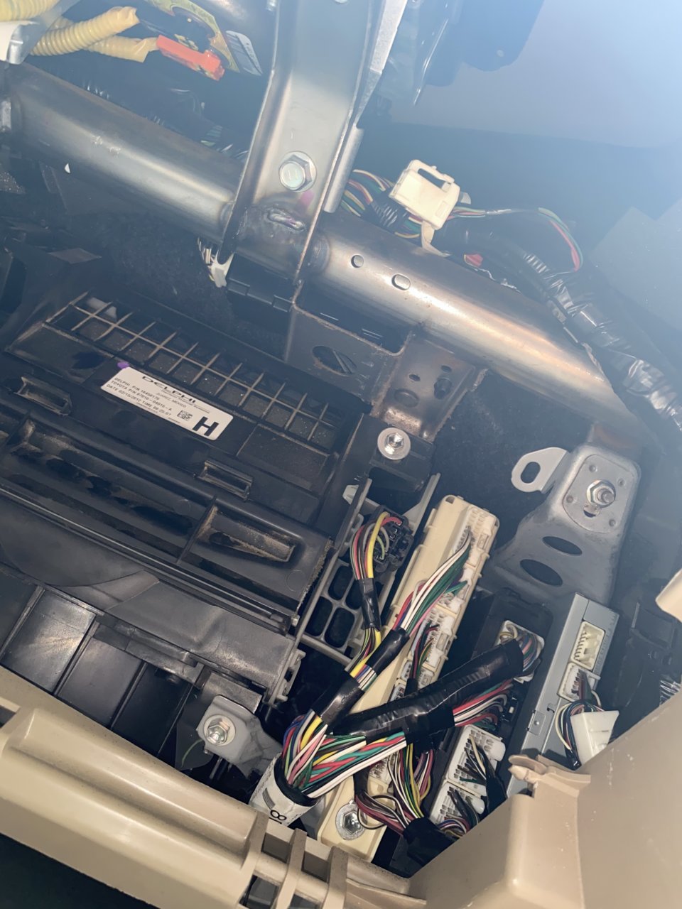

  20. Jul 26, 2020 at 4:28 PM
    #1100
    Brian422
    Jun 8, 2011
    #57958
    15,699
    Brian
    Birmingham, AL
    Not Stock
    I think it might be in the taped up portion!
    Anderson and BassAckwards like this.
