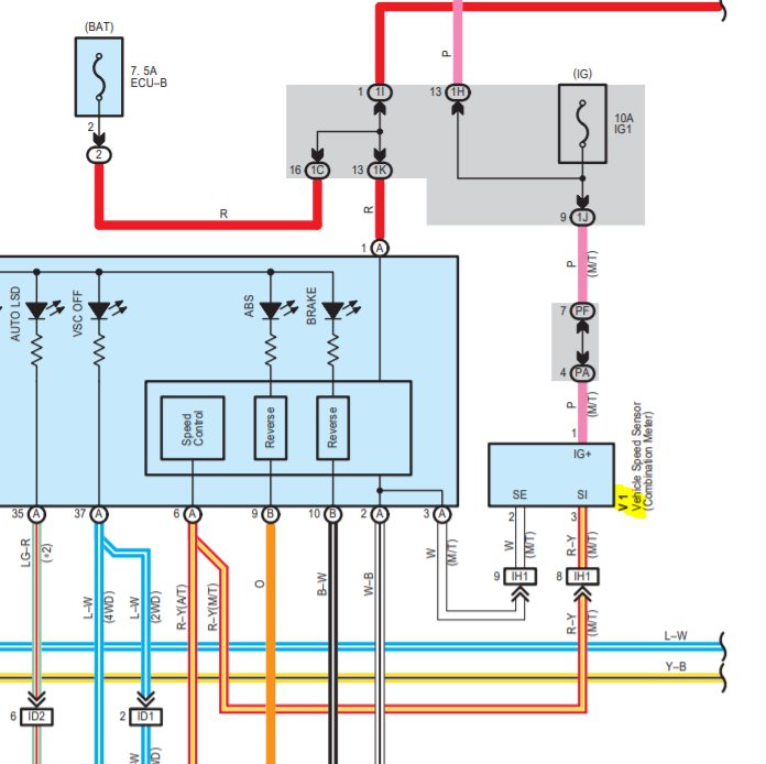

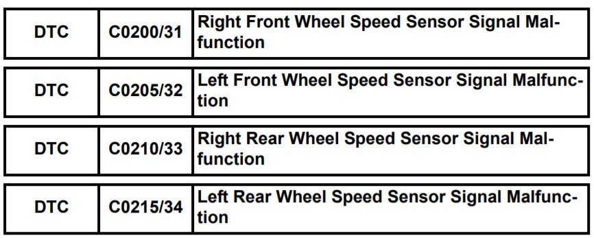

    So why would you lose speedo if only 1 of the 4 fails?

    6 gearT444E
    6 gearT444E Certified Electron Pusher
    Feb 3, 2018
    #243372
    7,798
    Deep South
    Herculiner Hootus
    That is also incorrect. In a manual transmission, the speed signal is developed by the VSS. It then passed to the instrument cluster. In an automatic transmission, speed signal is developed in the skid control ECU and passed to the instrument cluster.
    You won't, who said that? I've had a failed speed sensor on my 6 speed and the speedo works fine. You get a MIL for a sensor malfunction.

    Y2kbaja
    Y2kbaja Well-Known Member
    Jun 11, 2013
    #106028
    1,405
    Sacramento
    05 Total Chaos Tacoma
    Total Chaos
    My 05 prerunner would have brake&abs light on when one sensor was lost, then mil on with 2 sensors lost, then no speedo with three sensors lost. I have since done the tcase to speedo mod and speedo works again. Brake light is on but I don't care about abs. When the speedo was out I blacked out the abs and air bag lights so I can't see them anymore.

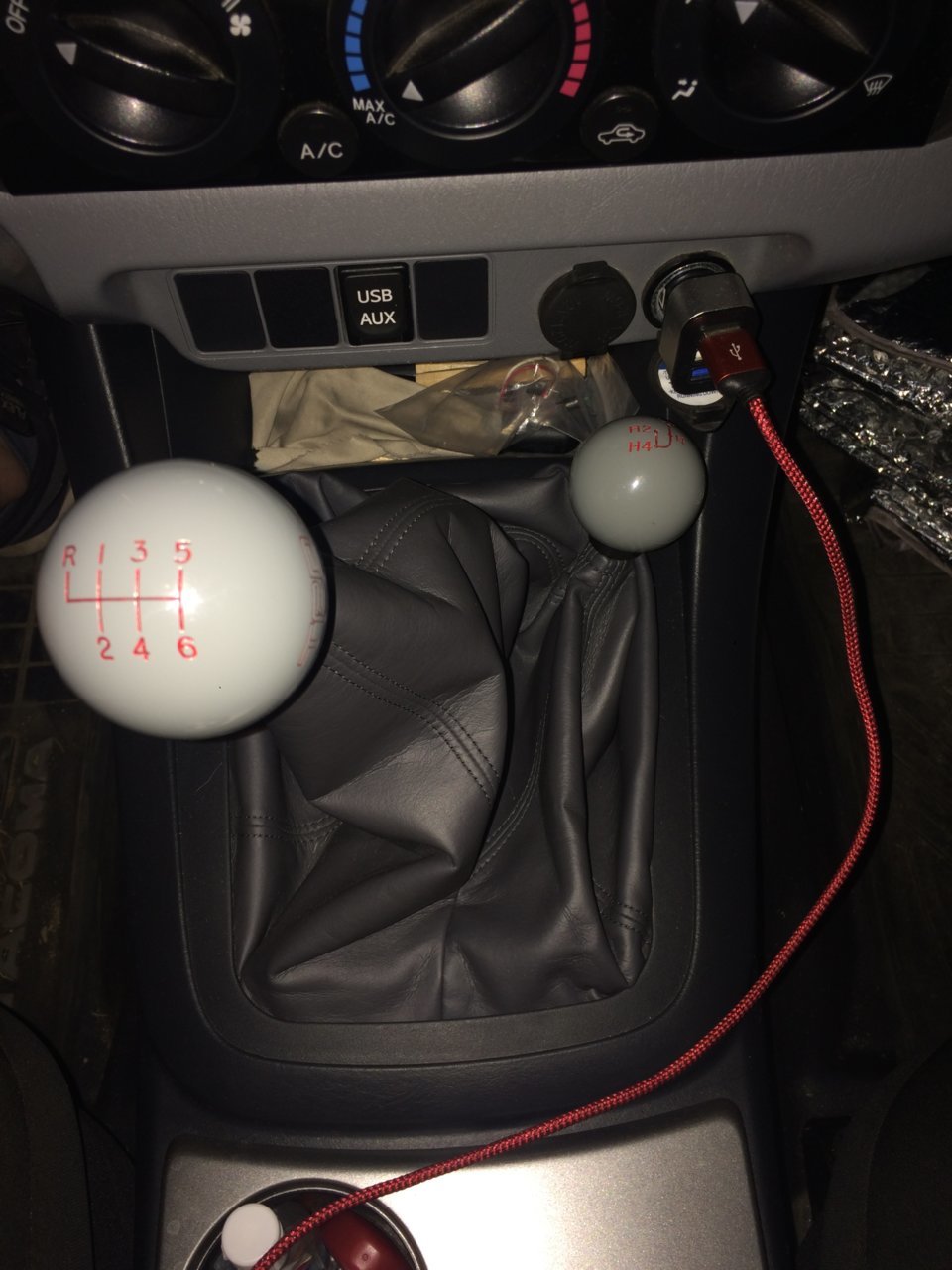

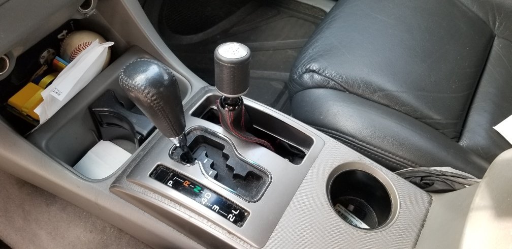

    Anyone have pictures of a single stick FJ case with a manual? I'm trying to figure out the best way to mod the shifters so they don't hit each other or the console. Seems like a tight fit no matter what.

    BassAckwards
    BassAckwards Well-Known Member
    May 3, 2016
    #186002
    27,953
    2009 Tacoma AWD Turbo 2TR-FE
    Full-time AWD & BorgWarner EFR 6258
    Here's the single stick behind my 6spd. I am fairly sure the layout of the shifters is the same. I am using the stock FJ t-case shifter and it rubs a little bit on the main one in 2wd 5th and 6th but I didn't modify anything

    What about in 4LO? The t-case stick is hitting the console hard.

    Here's 4Low. It's a tight fit but mine has no problem shifting without interfering with the console. It gets cozy on the side but with the boot in there I am happy with it. I am kind of OCD and it didn't rub enough on there or on the shifter for me to want to try to modify things. IMG_4572.jpg

    I Have a single stick case with the crawl box

    Did you have to mod the FJ stick at all?

    Yeah it got moved to come out up and right. Think the stock is either down and right or up and left. Depends on how u put the shifter into the shift base.

    Mines in there up and right. Could flip it around to be down and left but it didn’t seem to want to go in that way.

    Actually mine might be down and right. I don’t remember.
