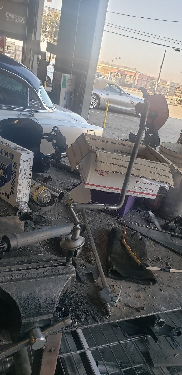

    I don’t have a picture of my fabricated shifter installed. I’ll take one tomorrow. Here’s the shifter be tac welded for a test fit
    @Ereyna93

    That’s the shifter to transfer case?? It doesn’t just go up in the coin slot? Do I have to make it all crazy like that ?
  14. Oct 4, 2020 at 8:02 AM
    #1174
    ToyoRideBFG23
    ToyoRideBFG23 Clifford, the big red Yota Beast
    Oct 5, 2018
    #268409
    160
    So-Cal
    2011 Toyota Tacoma OR Edition 4WD
    Front: 2.5 Icons extended travel remote reservoir CDCV, JBA Offroad High caster Arms, Wheelers super bumps Rear: Bilstien 5125, 1.5” AAL, Other: Front tube bumper, FJ T-Case, 285/75/16 BFG KO2s, Black Rhino Chamber wheels -10 offset with 1.25”wheel spacers, Nilight Ditch lights and LED Fogs. Upcoming Mods: Hammer Hangers, Icon RXT leaf pack, Icon 2.0 VS Series Remote Reservoirs.
    yeah you have to re route it to fit in the coin slot.

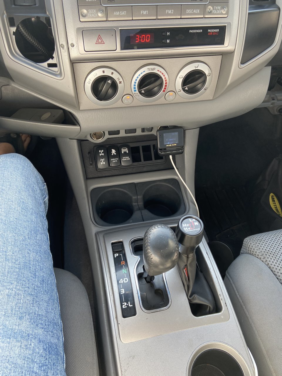

    so when I see any of these completed mods (single stick, Manual) and the fj shifter lever is in the same bay as the factory shifter, its been moded to get it there?
  18. Oct 5, 2020 at 4:00 PM
    #1178
    HomerTaco
    Mar 28, 2010
    #34129
    45,874
    HomerTaco
    HomerTaco
    HomerTaco
    Yes

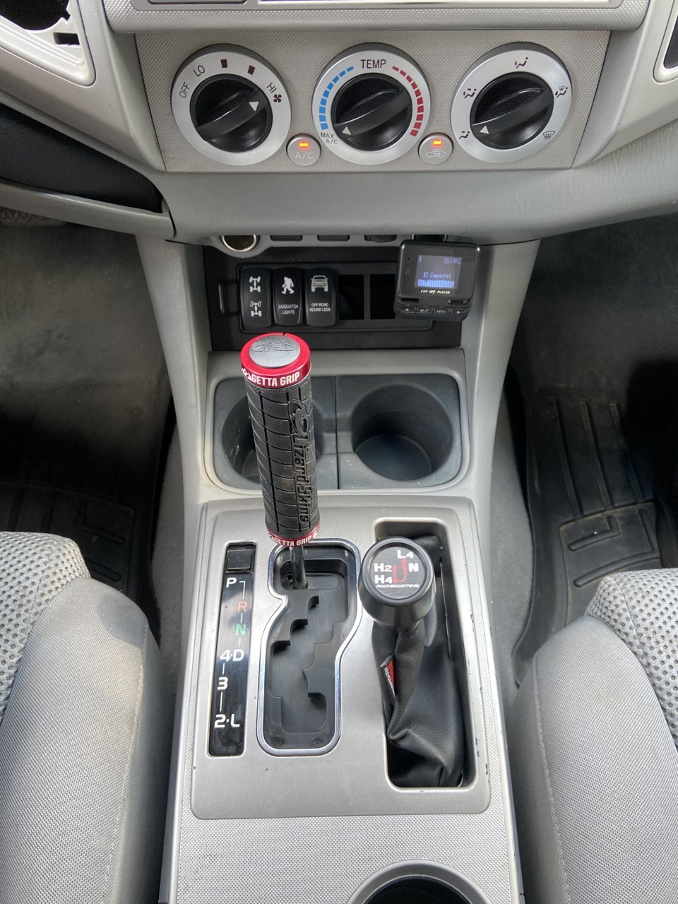

    On another note my Getta Grip shifter came in today completes everything I think.
    6 gearT444E and HomerTaco like this.

    160
    So-Cal
    Here’s how the shifter came out. I think I still need to do a slight bend away from the transmission shifter. Barely rubs like (1/16 of an inch) the t case shift knobs when going from park to reverse. But it’s not that big of a deal for now.
