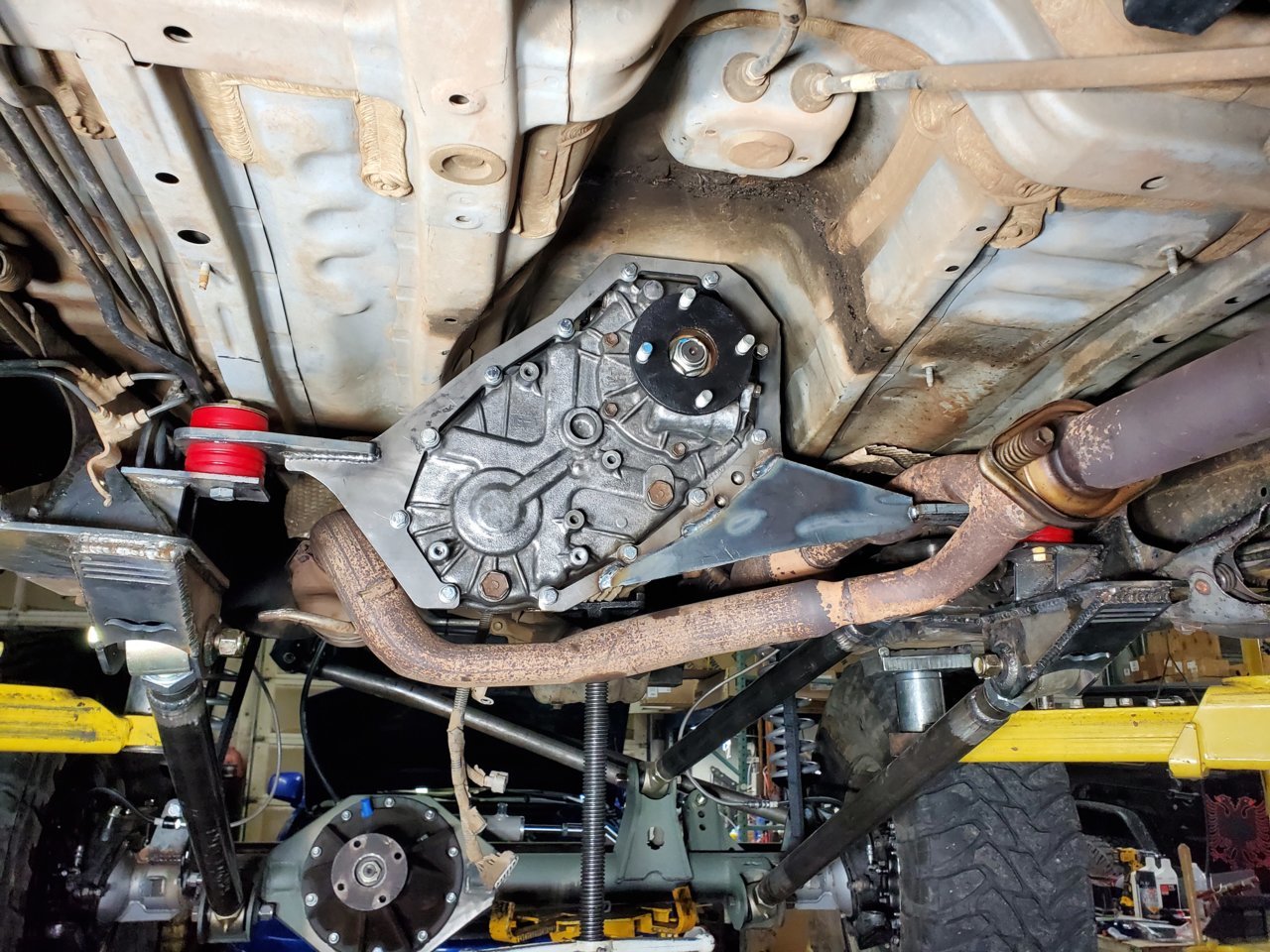

    It is in nutral in the pic.

    Looks like you had a lot more space to the right than I did, especially if you are in neutral in that pic. When I'm in neutral, my shifter is almost centered in the console, if not slightly to the right. Also, my transmission shifter doesn't lend to either side. It looks like your leans a little to the left. I thought about modifying the transmission shifter to position it like yours, but ultimately I couldn't get the t-case shifter to not hit the console without modifying it. So I chose to only mod one of them.

    cuz he is using the fj cruiser 6spd shifter which has more of a drivers slant to it than the tacoma's 6spd shifter

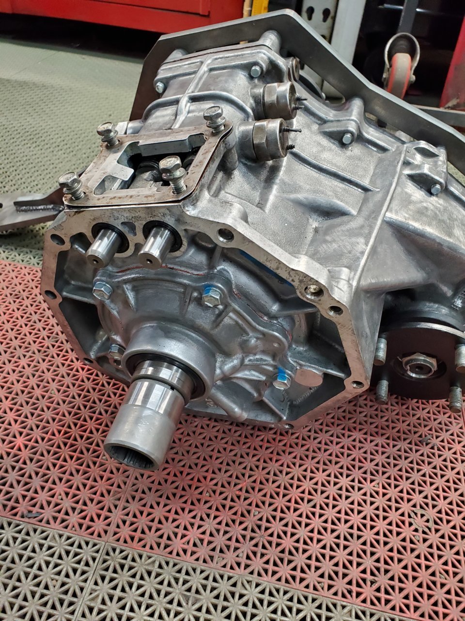

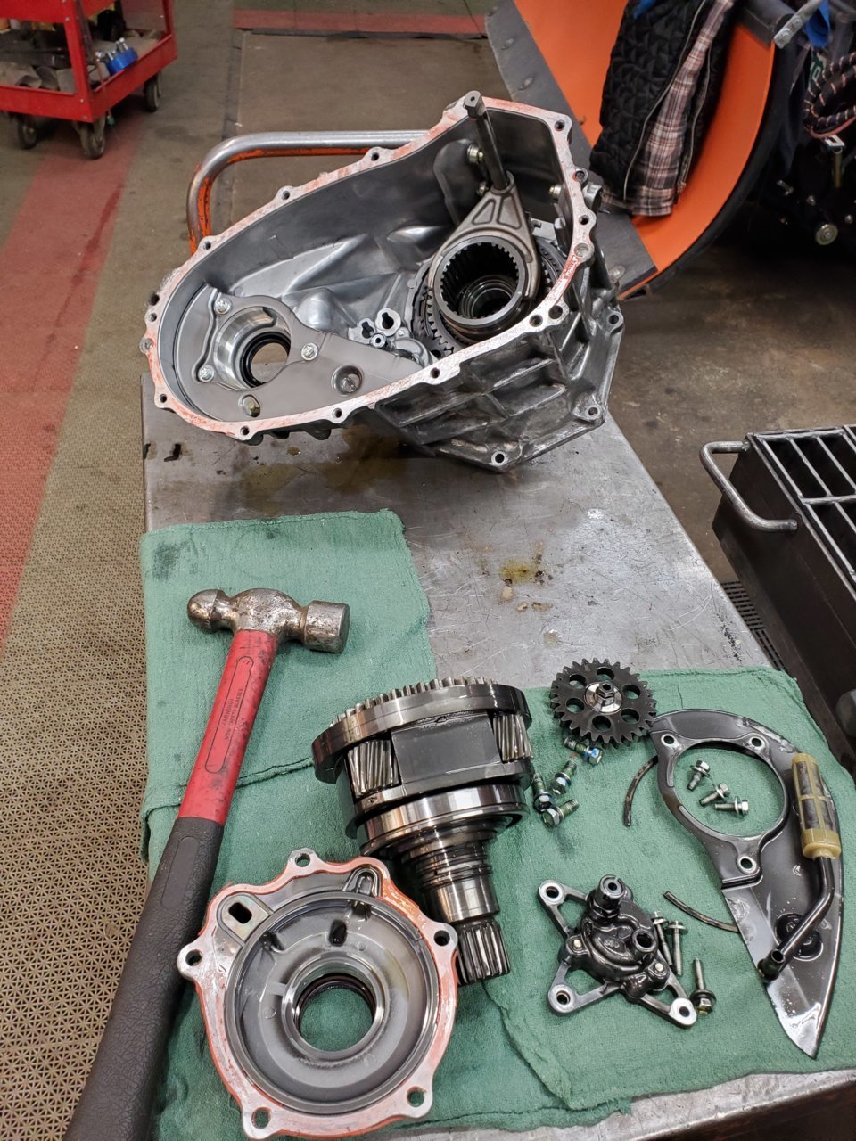

    Started mine last night, everything was going smooth until I went to put the case back together. A small ball bearing fell out somewhere. Then we picked up the case and could hear a "ting, ting" when lifted and tilting.
    ohcaltexscar, dborrer and rheath08 like this.
  10. Oct 31, 2020 at 6:50 AM
    #1210
    ToyotaRoamer86
    ToyotaRoamer86 Well-Known Member
    Jun 20, 2017
    #221993
    520
    Brandon
    Frisco, CO
    2007 Tacoma TRD Sport
    Noise is coming from behind
    dborrer likes this.
  11. Oct 31, 2020 at 8:44 AM
    #1211
    6 gearT444E
    6 gearT444E Certified Electron Pusher
    Feb 3, 2018
    #243372
    7,798
    Deep South
    Herculiner Hootus
    that sucks, on the plus side the case looks really clean inside! Did you lose one of the synchro keys or possibly a shift detent ball?
