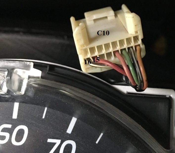

    All you have to do is:
    These are in the gauge cluster
    • Make a connection between the 4WD sensor and 4WD light (C10 Pin 15).
    • Make a connection between the 4Lo sensor and 4Lo light (C10 Pin 16).
    • Ground the second sensor wire.

    If you look at the diagram you will see the sensors that come off fj case. 4lo and 4wd. You need to take some (i think i used 18 gauge) wire and run it from the sensor plugs coming off fj tcase to the gauge cluster inside the cab.
    Here are the 2 wires you need to connect to in gauge cluster [​IMG]
