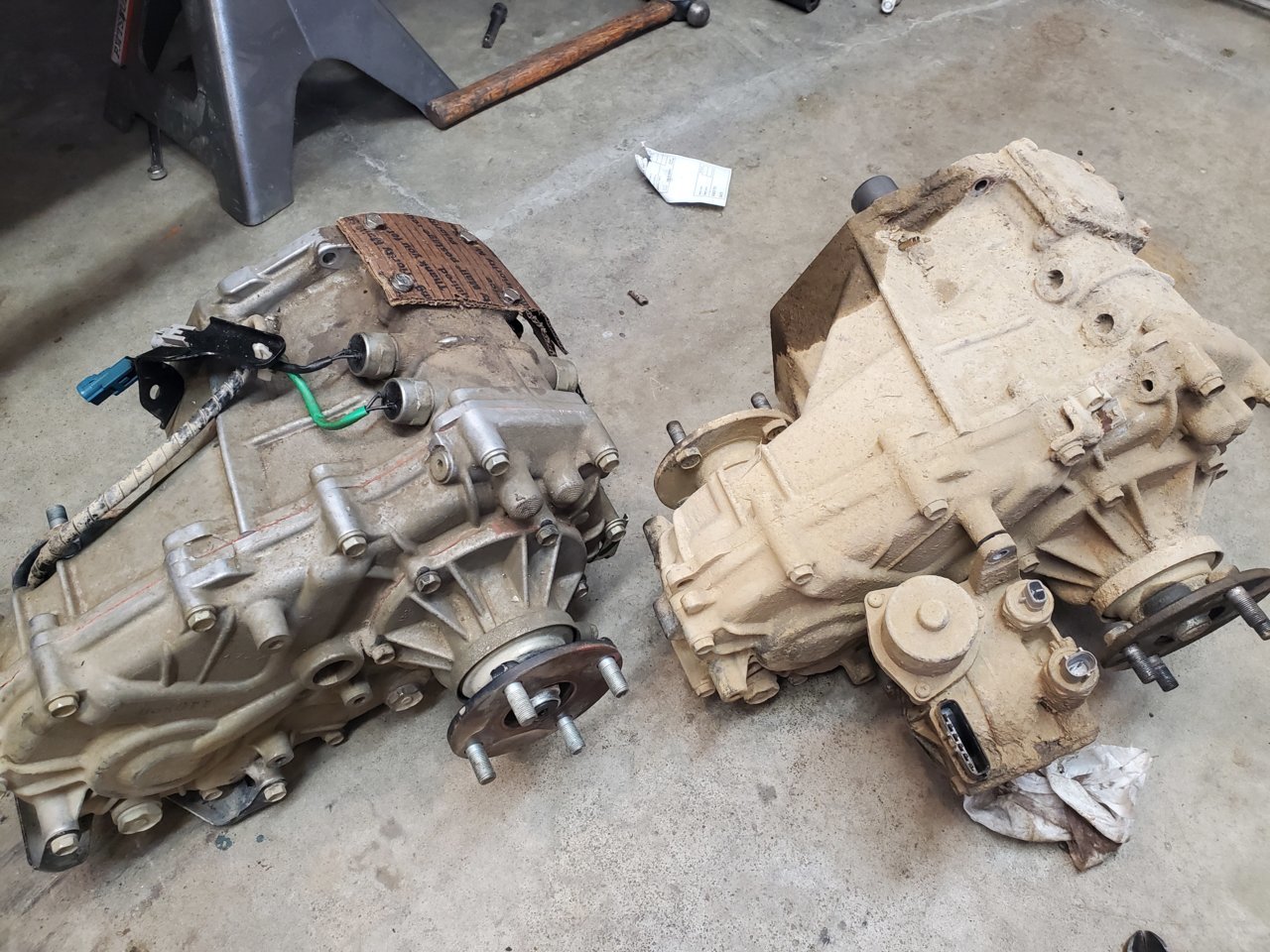

    Figured it out . for the next guy

    Great info! I had to drop my case again to swap these bc i got it wrong the first time around. Definitely going to save someone some time later on

    you could have just swapped the wires under the dash to avoid dropping the case, I know I had to triple check mine when doing install to make sure everything was right.
    I’ve got a switch and ECU, about 10k miles on it. Still functional, I swapped mine out due to a problem with the transfer case actuator. Send me a PM if you want to arrange shipping.

    Lol dammit this would’ve been so much easier :bananadead:
    I have a bad habit of trying to do things by the book instead of using my head to solve a problem. Won’t forget this now though, I appreciate the information!:hattip:
