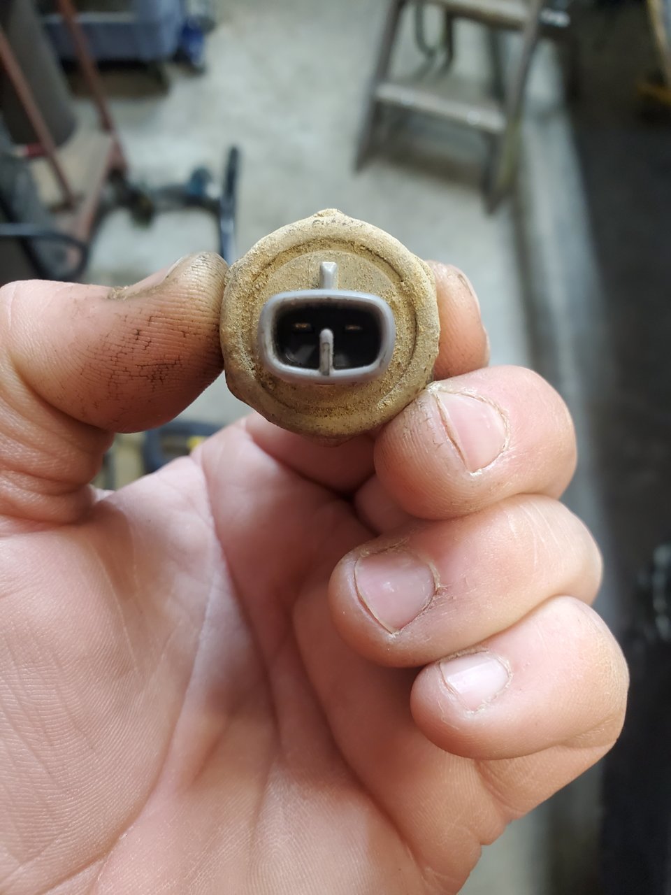

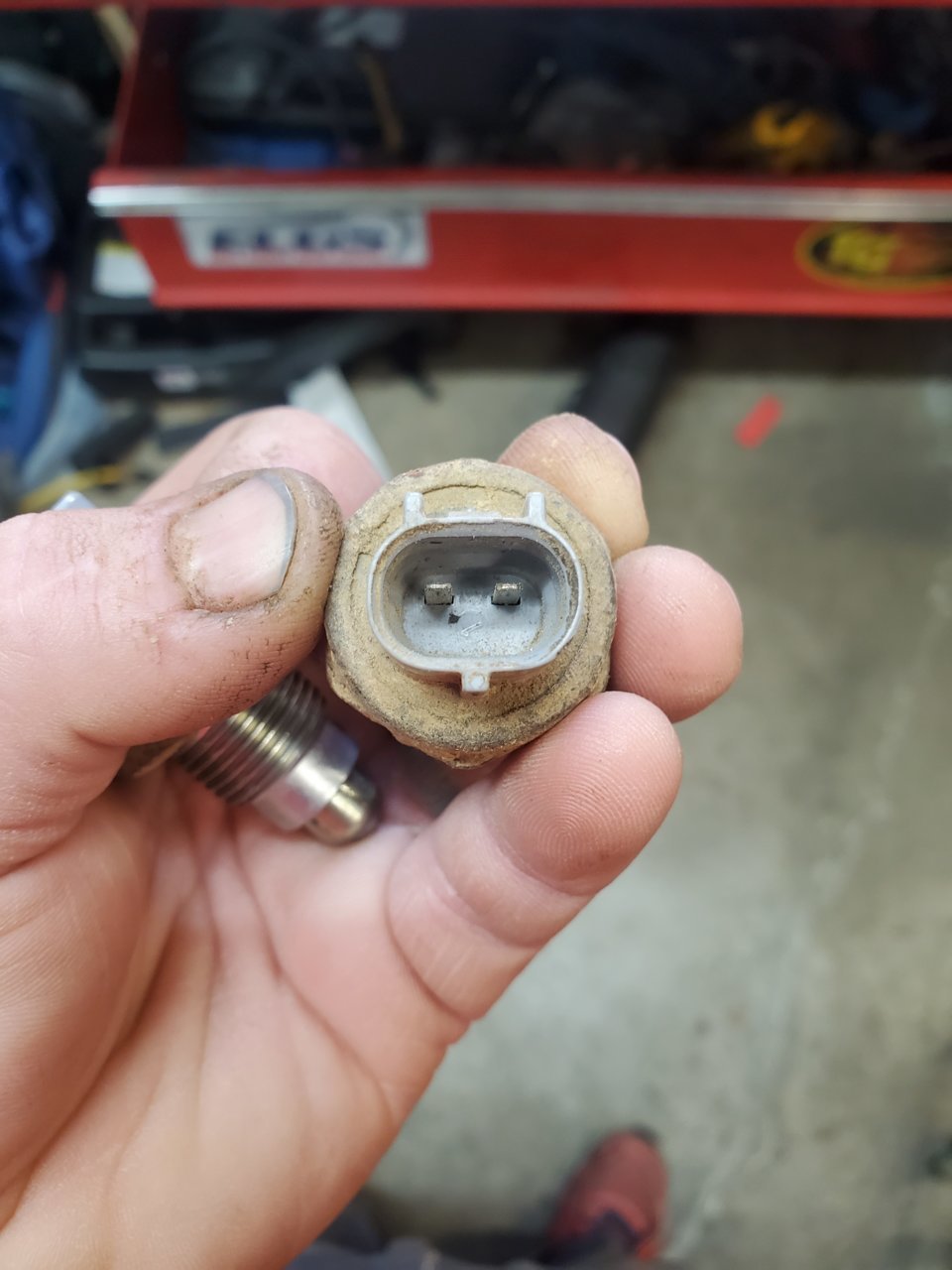

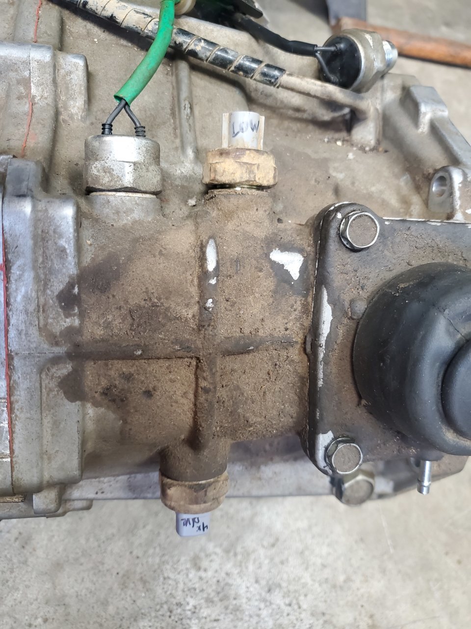

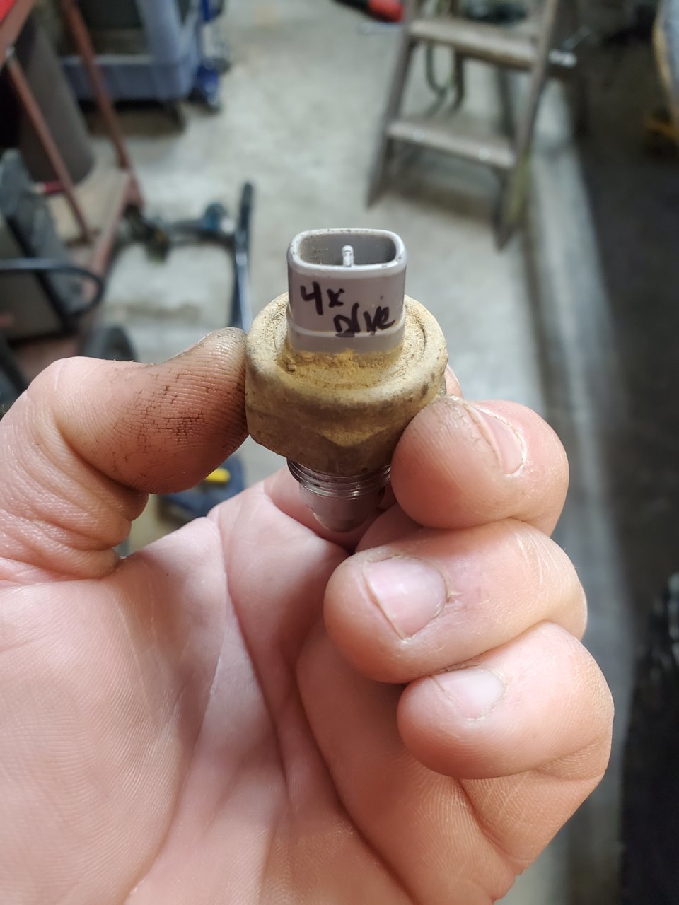

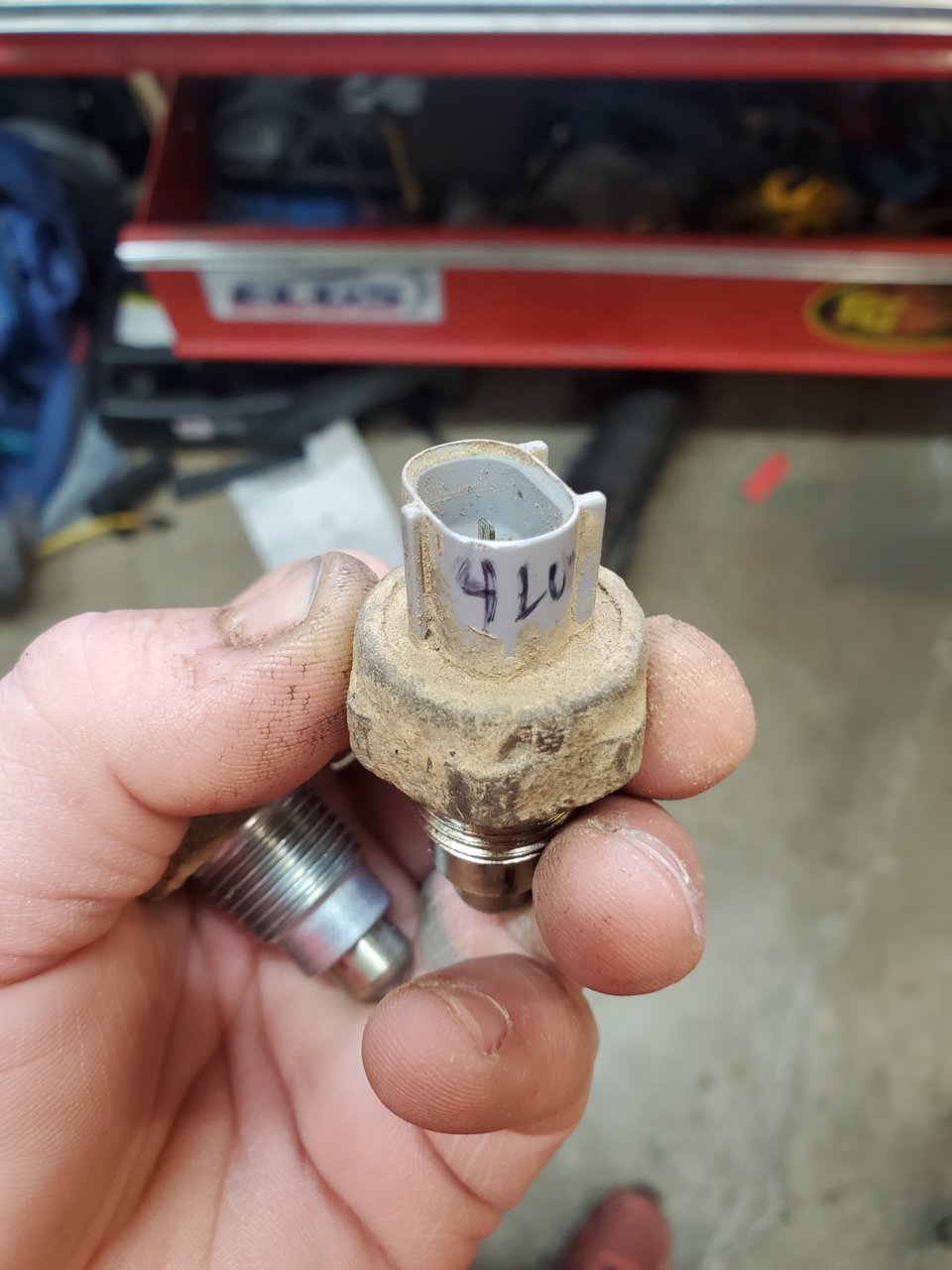

  20. Dec 11, 2020 at 9:39 AM
    #1340
    dairyman
    dairyman Well-Known Member
    Feb 24, 2018
    #245504
    150
    Beat up 08 Tacoma
    3” lift 285s
    Where’s the green wire go to?
