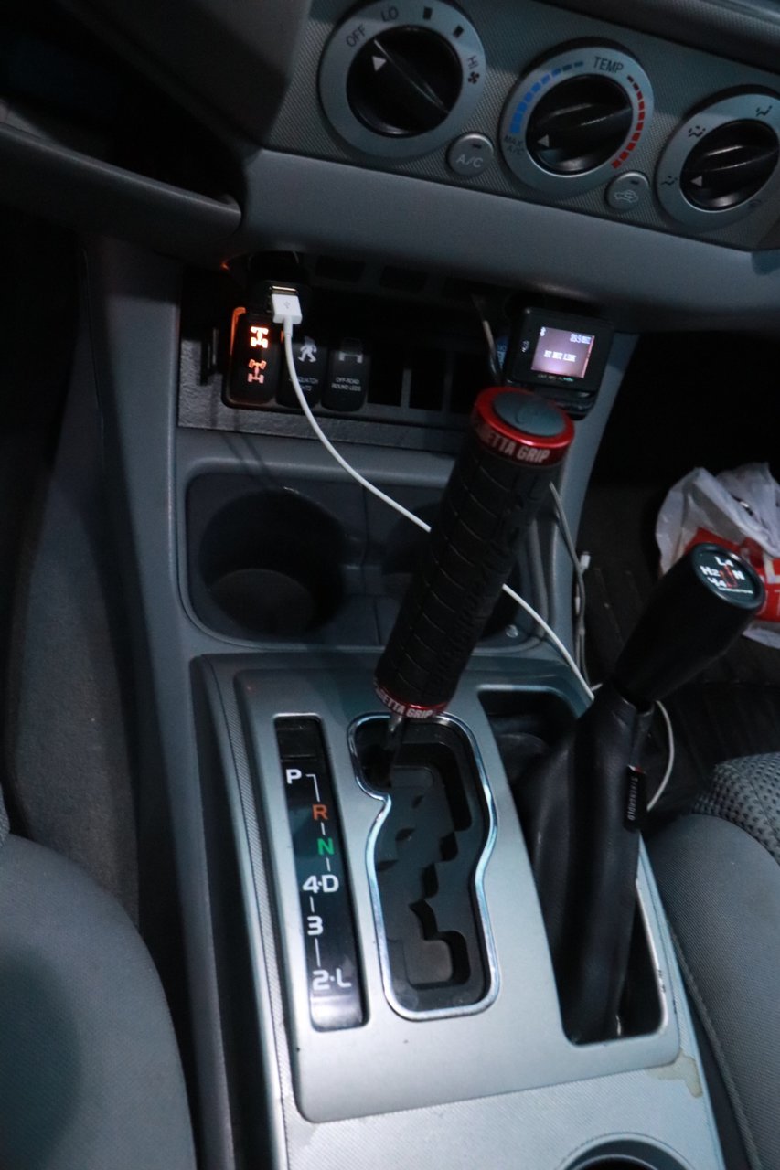

    My fj case didn’t
    vssman[QUOTED] likes this.
  2. Dec 11, 2020 at 9:46 AM
    #1342
    6 gearT444E
    6 gearT444E Certified Electron Pusher
    Feb 3, 2018
    #243372
    7,798
    Deep South
    Herculiner Hootus
    neutral sensor.

    Where did you find the switch rocker? Looking for one for mine. So it matches the rest of my otrattw rockers.
  5. Dec 12, 2020 at 10:19 PM
    #1345
    hoarder23
    hoarder23 Truck fell over
    Aug 14, 2012
    #84787
    12,886
    Shay
    NJ
    15 Pyrite Mica DCSB Sport
    Scratches
    Otrattw sells the one I used

    Does it supposed to plug into anything?
  7. Dec 13, 2020 at 8:25 AM
    #1347
    6 gearT444E
    Feb 3, 2018
    #243372
    7,798
    Deep South
    Herculiner Hootus
    only if you want to know it’s in neutral, otherwise you can just leave it plugged at the case.

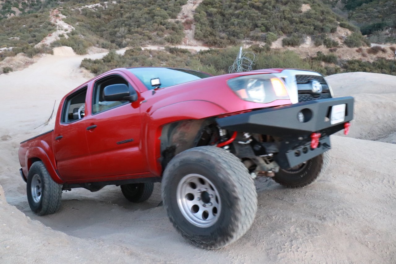

    Finally got the struggle stick out on some trails out west on a Muley hunt. It had just snowed the week before so the two-tracks were trashed, made for a lot of fun wheeling. Loved just leaving the front ADD engaged during the trip as we were mostly on tracks, but then made it easy to just pop the TC in and out when jumping between trails and HWY.
