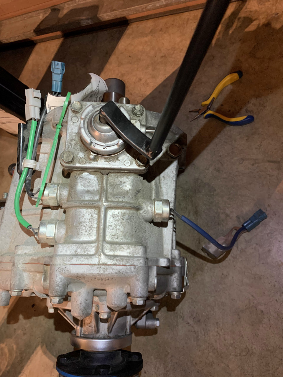

    So, finally got my swap all figured out. I made a template to help clearance the transmission for the shift rods, worked like a dream. Way better than guessing.
    I went a bit too deep on the driver side shift rod, definitely didn't need to go that far. But shouldn't be an issue, I'll keep an eye on it.
    I found that using this burr bit was easiest, only walked off on me a few times as you can see above :D
    Basically done, just waiting on my twin stick kit, and trying to figure out the timing on the actuator after I took it all apart and cleaned it, and I should have 4x4 again!

    You going to sell the stock shifter when you get the twin sticks?

    I s'pose I could, although I've modified it to clear the transmission shifter.

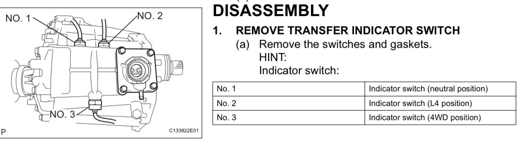

    Question for the all mighty swap gods: I've got a Xfer case from an '18 4Runner with three sensor pigtails (4x4, 4lo, and Neutral?) What is the third pigtail for certain? and can I remove it and put a plug in? and what is that plug P/N? Was told this is the same Xfer case as the FJs. Label from part yard has '18 4Runner 1GRFE Automatic on in it. Thanks for the help.

    It’s for the neutral sensor. Not sure why waste the money on a plug, just leave the switch in there. The plug part number is 90341A0002

    Thanks! Figured I could but thought I’d ask. Where’s the diagram from?

    the FSM for the VF2A transfer case assmebly.

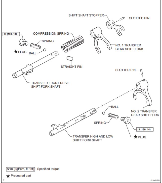

    Yes it has a different shifting pattern. Not sure if it would be possible to twin stick or not. I know the shifters themselves are different part numbers but are interchangeable between cases, the difference is the bend in the shifter the manual transmission transfer case has more a dog leg to clear the transmission shifter.
    VF4B - shift lever PN 3636035580
    VF2A - shift level PN 3636035590
    bravinci likes this.

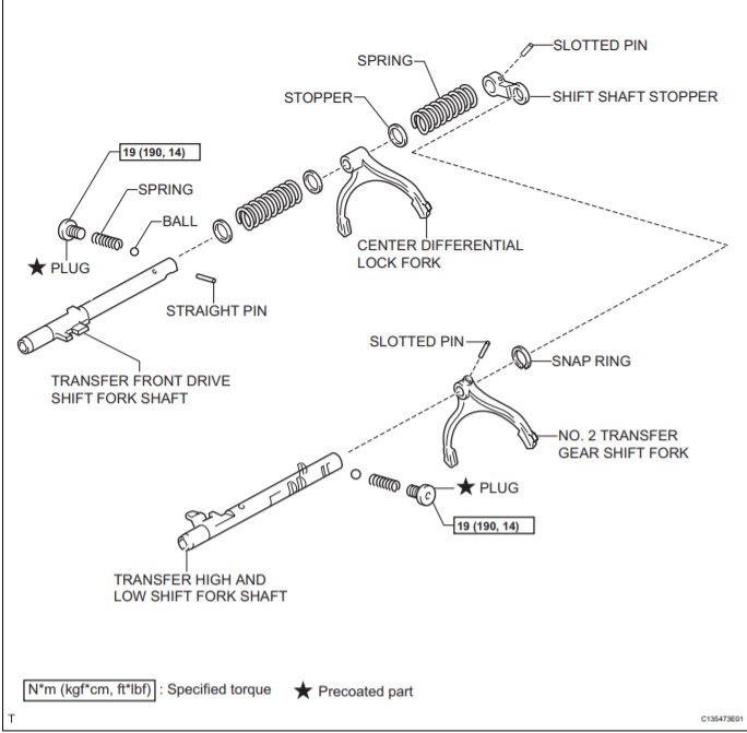

    Looks like you may still be able to twin stick by how the rails line up?
    It looks like there are some models of the transfer cases that are AWD that utilize electronics for shifting the center differential lock in and out, but for the FJ case VF4B it is done mechanically
