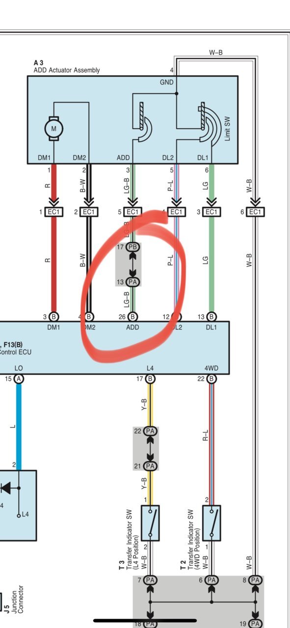

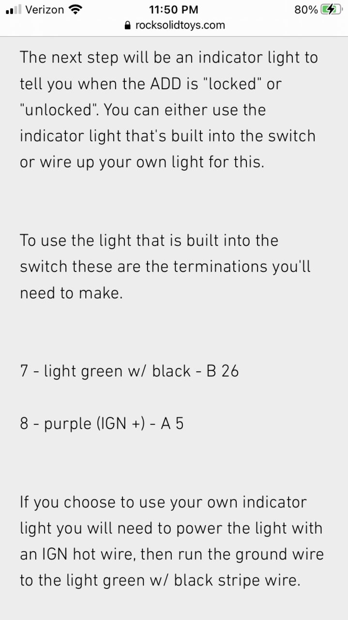

    I just recently did an FJ transfer case swap in my 09 tacoma. I have everything done and I can hear the front diff actuator engaging. But my indicator light on my switch doesn’t turn on. I followed the Rock Solid wiring diagram that says to use the purple ignition (A5) and the light green/black (B26) to power the light on the switch. I can’t get the light to come on at all. Has anyone encountered this issue? Is there a different ground wire or positive wire I should be using from the 4x4 ecu harness?
  13. Feb 7, 2021 at 9:01 AM
    #1413
    6 gearT444E
    6 gearT444E Certified Electron Pusher
    Feb 3, 2018
    #243372
    7,798
    Deep South
    Herculiner Hootus
    I assume you got a switch from RST? Not sure on the terminals on that side but B26 is right from the ECU. So you either wired it wrong or something is up with the switch
