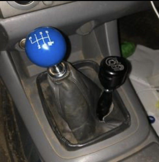

    You shouldn’t have to modify the shifter at all for a manual. I just cut a hole in the boot.

    The shifters bump a little bit going into sixth gear so yours might bump with reverse. It doesn’t bother me

    Thanks dairyman , so there is no interference with the transmission shift , one doesn’t hit the other ?

    I don’t mind if I I have to heat it and bend it slightly.

    Wouldn't happen to have a picture of that with the cover off? or a pic of that tcase's shifter?

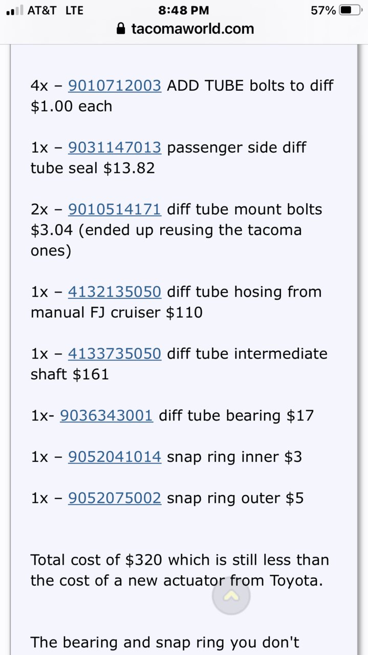

  17. Feb 17, 2021 at 6:56 PM
    #1437
    Mech1txs
    Mech1txs Well-Known Member
    Feb 17, 2021
    #356479
    293
    Troy
    Nor-Cal
    06 single cab manual FJ swapped add delete
  18. Feb 17, 2021 at 6:58 PM
    #1438
    Mech1txs
    Feb 17, 2021
    #356479
    293
    Troy
    Nor-Cal
    It’s from this forum , those are parts for the add delete for a 2nd gen , plus a manual transfer case from a 07-14 automatic trans FJ cruiser .
  19. Feb 17, 2021 at 7:02 PM
    #1439
    Mech1txs
    Feb 17, 2021
    #356479
    293
    Troy
    Nor-Cal
    Prices went up a little but every thing is on its way , if you haven’t read the 72 pages of the FJ transfer case swap I would do so all questions will be answered. It’s a lot of info but if you have a little mechanical knowledge it’s pretty straight forward .
