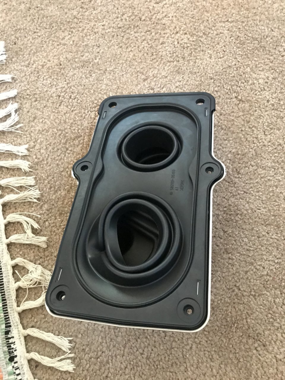

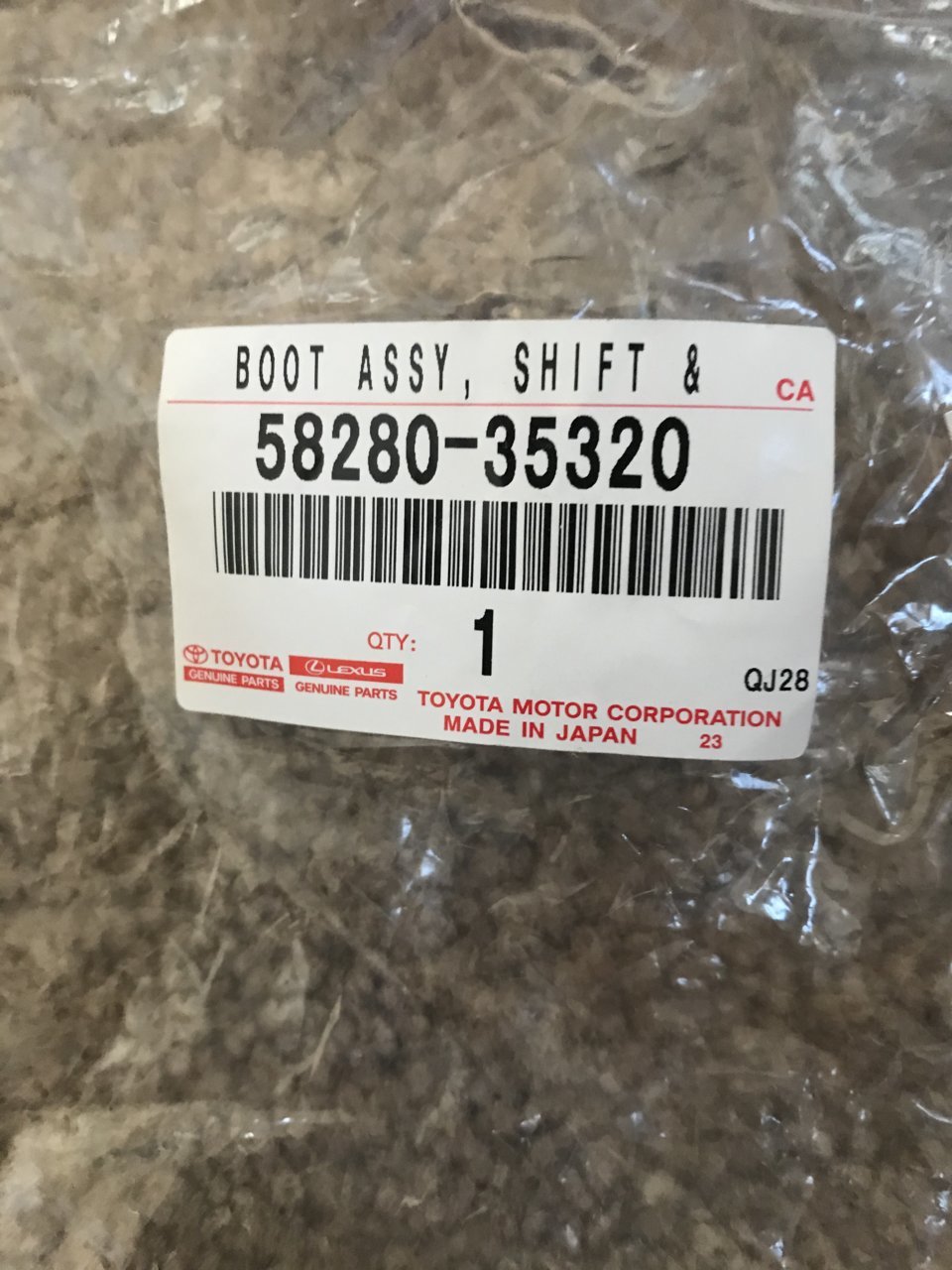

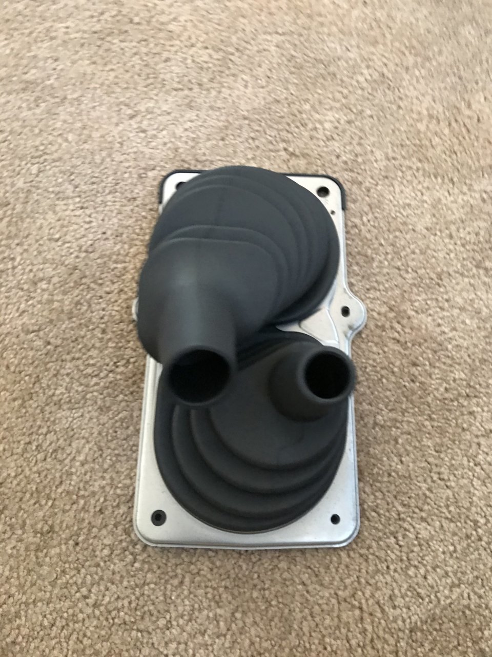

    In case any one is looking for a very solid shift boot for your FJ case swap with a manual trans . I was pleasantly surprised at the high quality very nice piece and no need to add roofing tar and other foreign materials to seal things up .

    I’ll try and remember to take pics when I do the install .

    Again I found the part earlier on in this thread . But I never saw a picture of it just a Toyota factory parts listing .

    And if I’m not mistaken it is the factory boot for an FJ with a 6 speed .

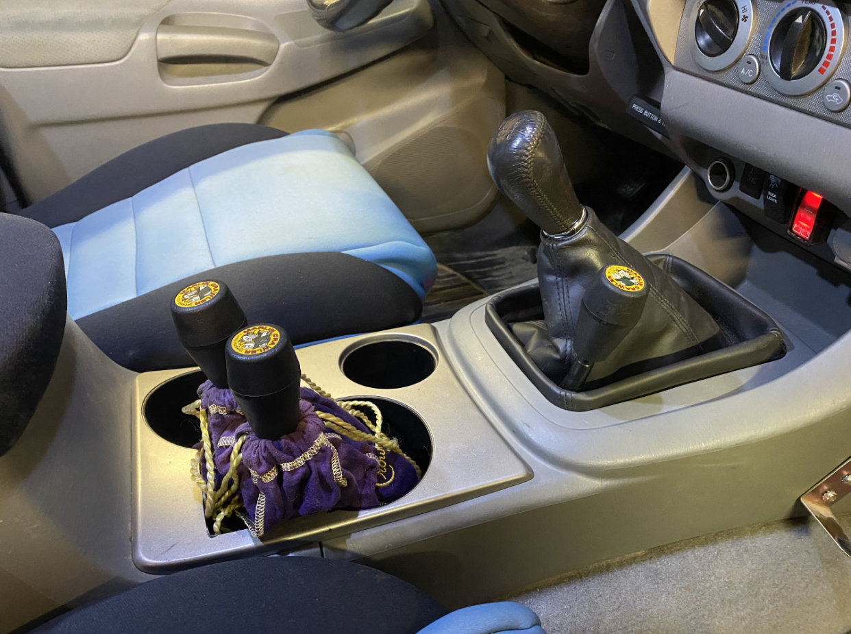

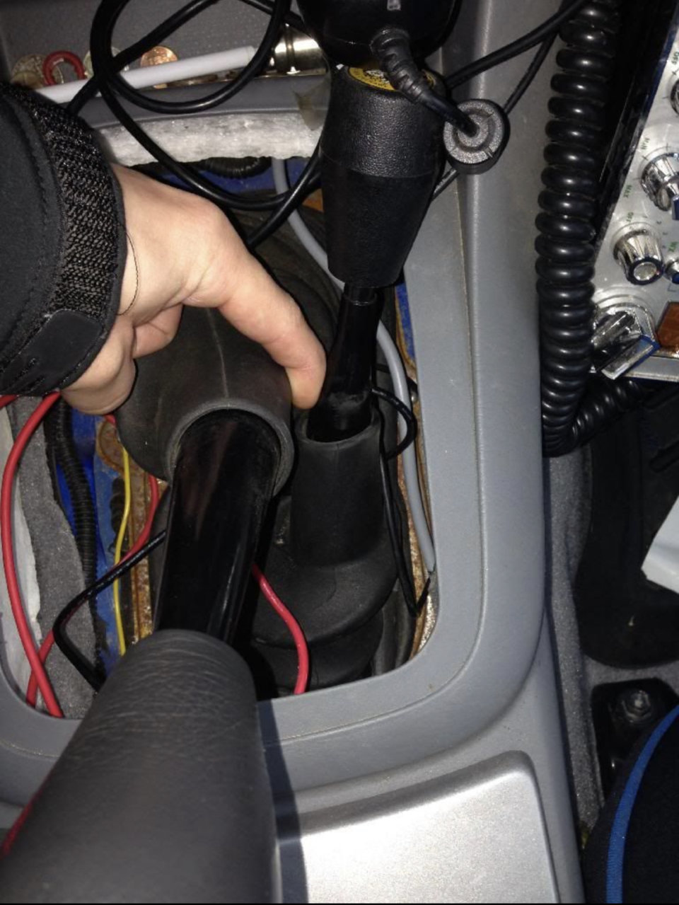

    that’s what I used and it works just swell. Here’s the clearance between 6th gear and 2lo, about an Irish dinks worth

    I’m guessing it sealed to the floor nicely ?

    yes, add a couple more holes in the floor. I used sheet metal screws to hold it in because I’m lazy and it worked just fine for about 8 years so far haha

    I see you have a crawler box with a twin stick case , are you just using a separate boot on your twin sticks ?

    there’s a dual boot on the twin stick, something like this. any gaps were filled with black silicone, easy to remove when you have to, I resealed mine when I replaced the clutch and throwout bearing last year.
