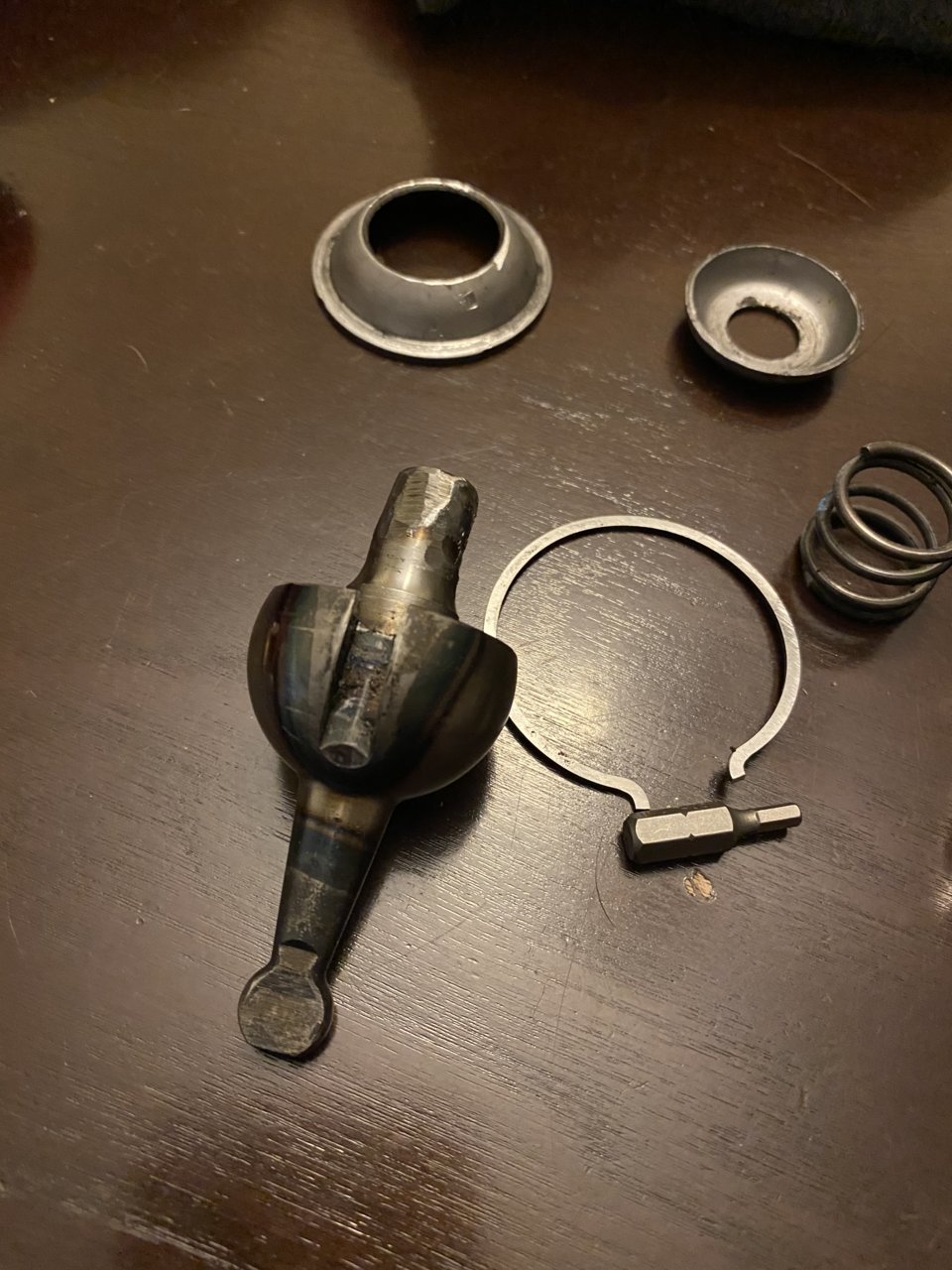

    just order this and modify for your truck. its the same lower end and all you need is so 1/2 round bar. Thats what i used for mine. This is basically all you need to fabricate something [​IMG]

    6 gearT444E and whatstcp[QUOTED] like this.

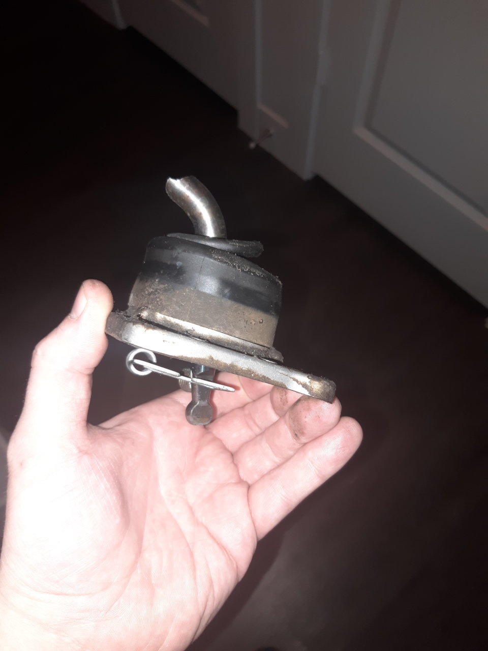

    If this is within your wheelhouse to fabricate then I have a shifter base that's hacked off you can weld some round bar to, or pick the shifter Brian mentioned and pop it into this base. Refund me the cost of shipping it to you and its yours.

    This base is for the FJ cruiser t case? That’s awesome! Thanks I’ll take it. Pm inbound

    Sure is. Glad to help!
