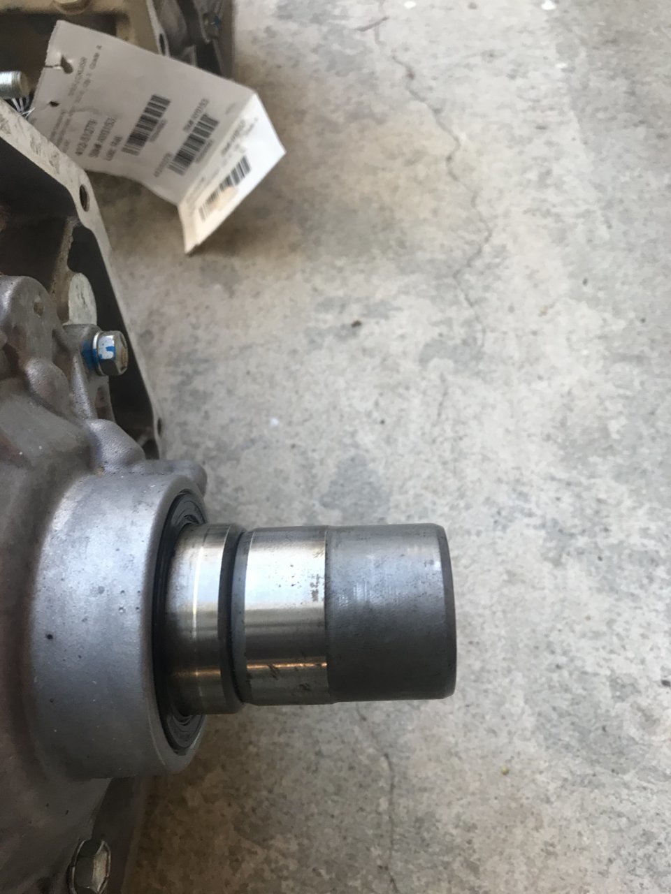

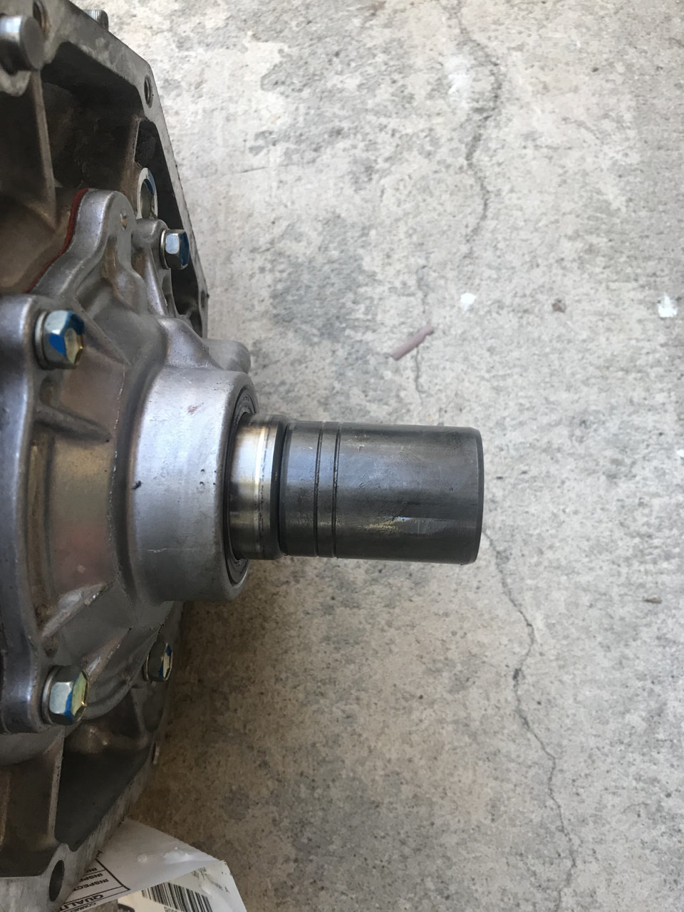

    Hey so I’m in the middle of my swap and my old transfer case has a female input as does the new FJ one but the adapter collar on my OE case is about a 1/2 in longer which one should use ?

    Update I swapped the OE adapter collar to the new case

    You’re going to want to put the one that came out of your truck on the new one.

    That’s what I did

    Thanks for the reply 6gear , my brain told me it was the thing to do , thanks for the confirmation!

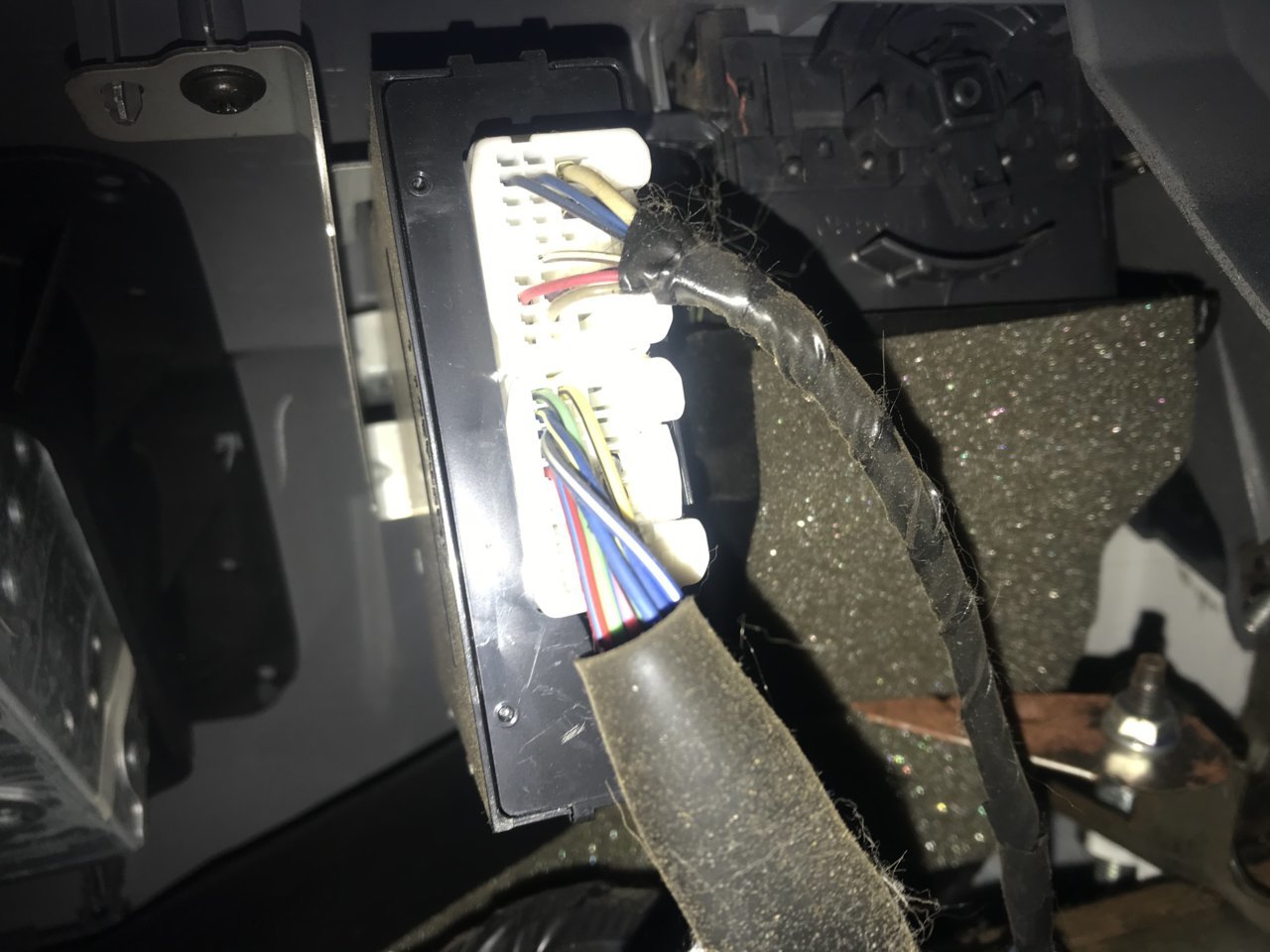

    I’m now looking for 4wd ecu I’m not sure where it is , I now it’s behind the glove box but which one is it ?

    I have an 06 sr5 single cab .
  13. Feb 27, 2021 at 4:42 PM
    #1573
    wrmathis
    wrmathis Dark Lord of the Sith
    Sep 10, 2008
    #9126
    9,453
    Bonaire, GA
    2006 Tacoma TRD OR 4x4
    parts and stuff
    look up. its basically more behind the dash above the glove box
    6 gearT444E likes this.

    Is it a black box with one plug ?

    remove black cover where glove box latch is and look up. All the way on top inside basically directly under the dashboard

    6B02A27B-98CB-45D5-B0C4-D45773F2DE57.jpg This has to be it then , black box 2 plugs

    that’s it
