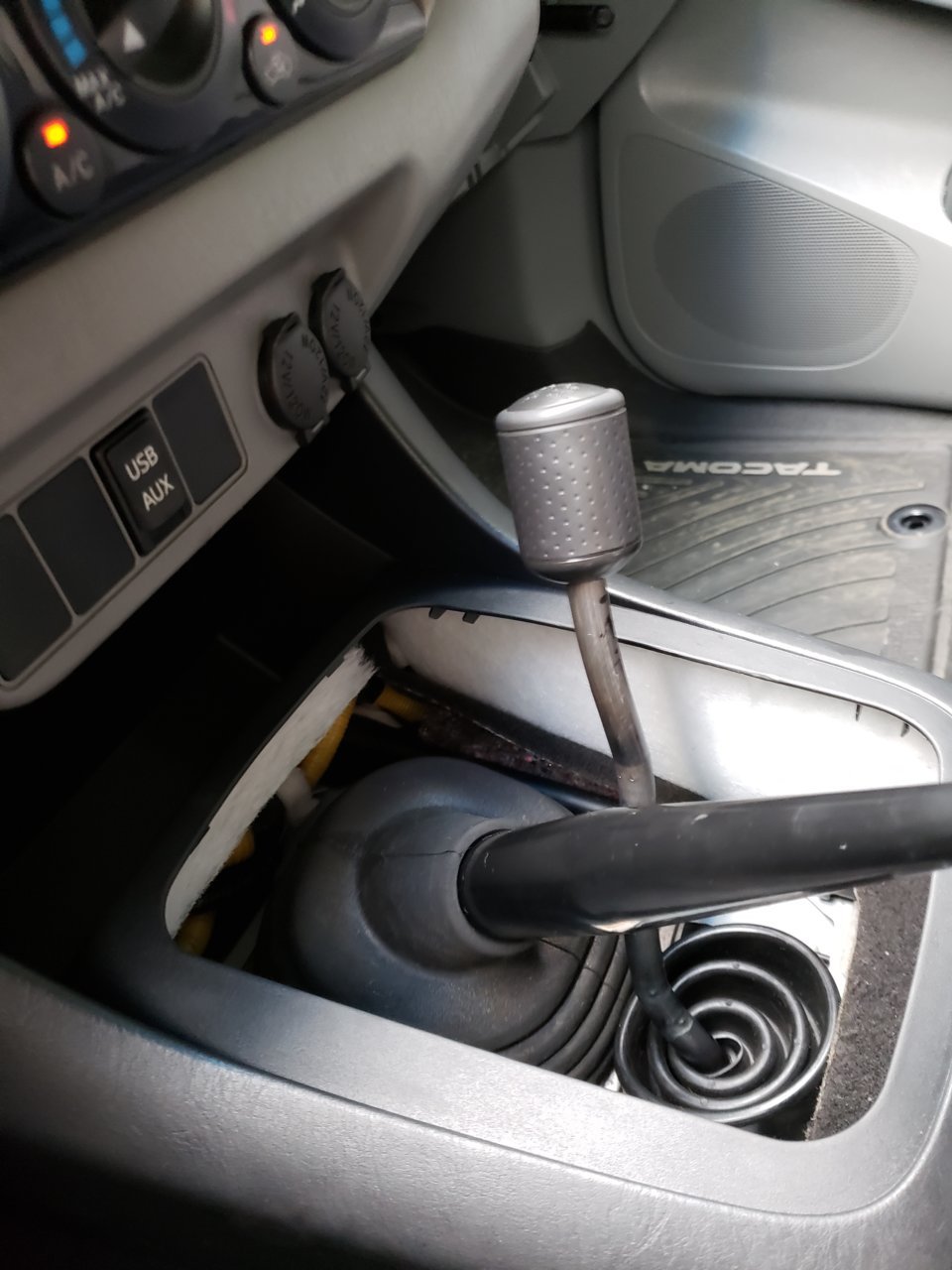

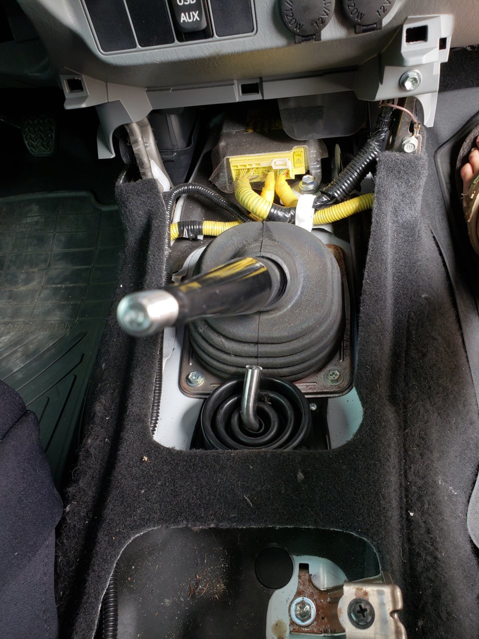

    No sure if this thread is still alive but finished mine. Another Tacoma the way it should have come.

    :thumbsup: Stock FJ shifter? Besides the boot, did you have to modify the center console for any additional clearance for both shifters?

    Piggy back of ^his question ... did you happen to snag a pic before putting the console back on?

    The only thing stock about the shifter is the knob. Got a rubber boot off Amazon, had a friend help fabricate a ne shift rod, and cut a hole in the origninal leather boot (RST should be hooking me up with a legit one)

    I used to 3 in hole saw to cut the hole in the floor, some asphalt window flashing tape and the boot to seal it back up.
