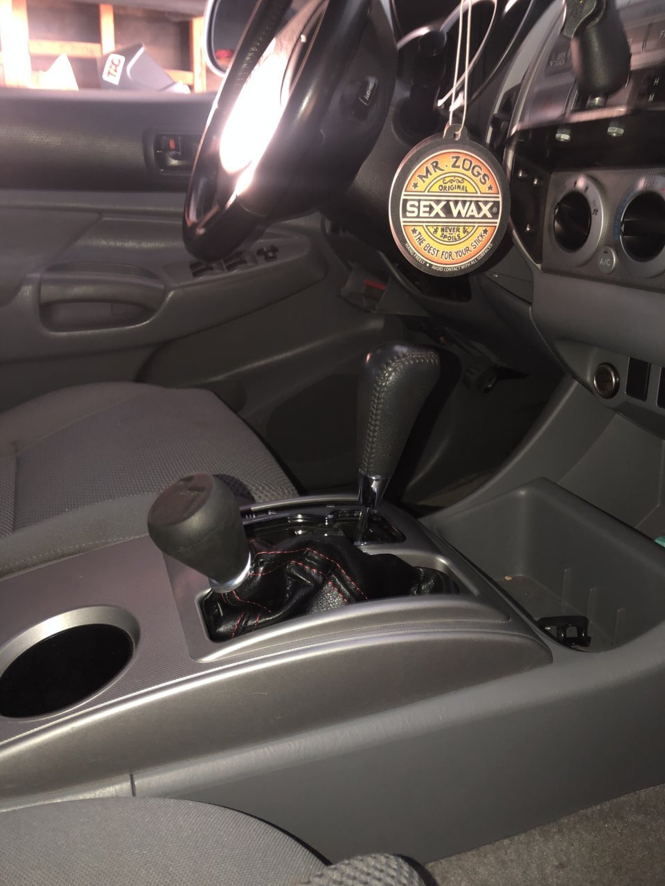

    What shifter boot did you use for the 09

    looks like the Amazon special.

    Looks like the same one I got from Autozone for like $10.

    Can confirm, it’s the one with red stitching. It’s what I got too....:rofl:

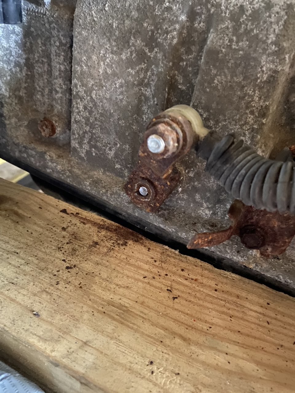

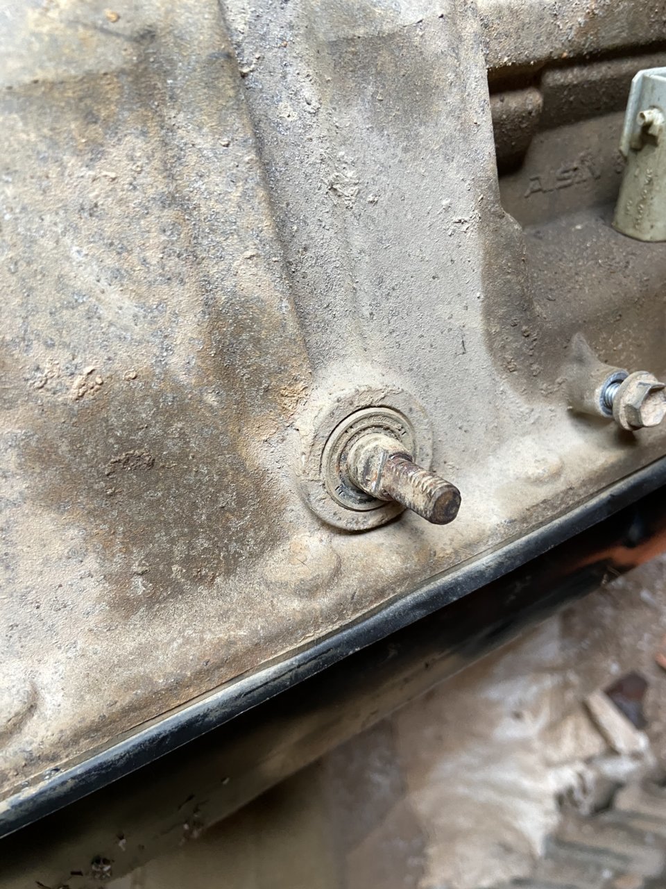

    I was transferring some of my parts from my A750E to my new A750F tranny bc the brackets and bolts are rusted. I broke the shifter linkage bolt. Shifter still works fine but is there a way to transfer my old bolt (bottom picture) to the new broken one (top pic)? Idk how the internals work. Worst case, I was gonna tack weld it, still shifts fine

    `all you had to do was take the top bolt off, id say screw it and weld it lol

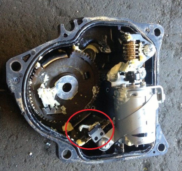

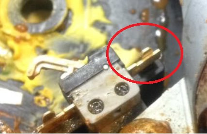

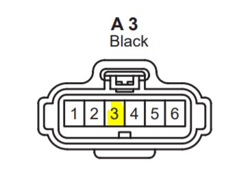

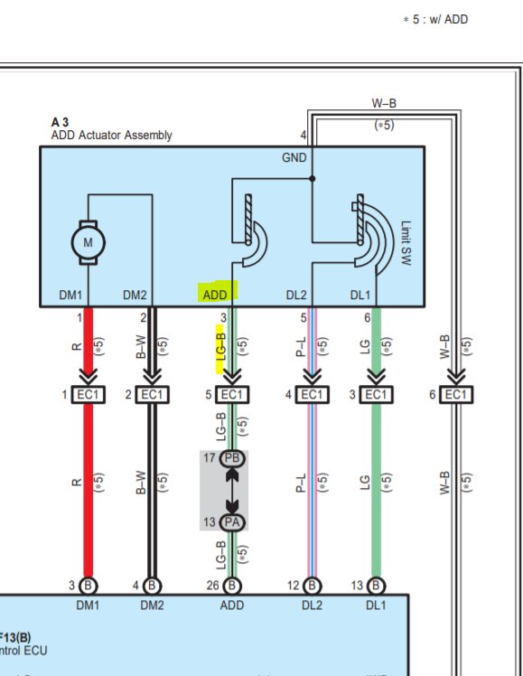

    so update its the sensor inside the add thats probably corroded cause i switched out the switch and it still doesnt light up but still engages into 4wd. Know which pin controls that?

    It's the light green/black wire coming out of the harness, pin 3 of the ADD actuator

    Good luck, here is the switch of concern within the actuator

    If you do tack weld it which I personally would not recommend, stuff a wet rag around the shaft behind the shift lever to keep the heat off the selector shaft seal .

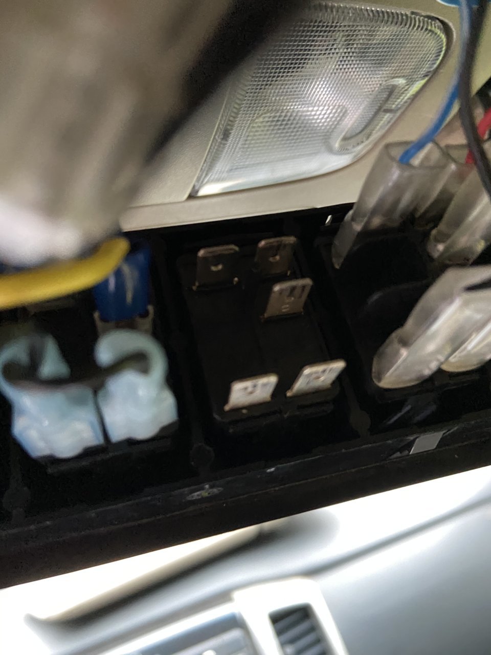

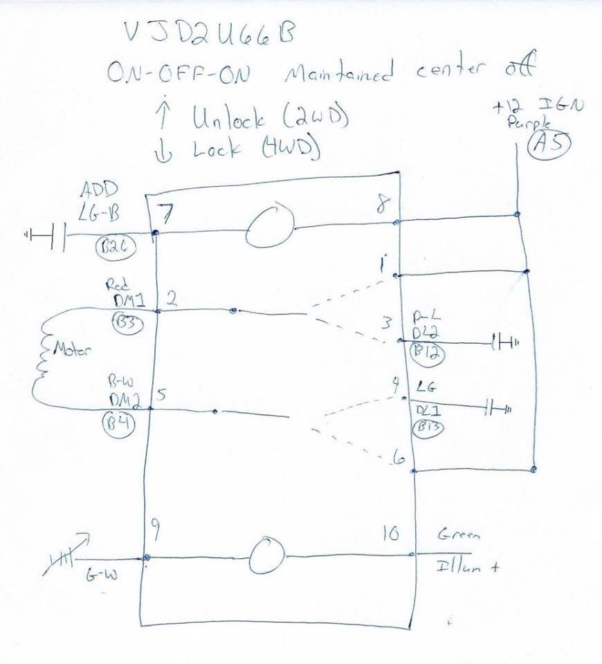

    Since we’re talking about switches, will this switch work? It only has 5 pins.
    Diagram for it
    I wasn’t sure bc in this diagram that you posted awhile ago, seems like there is more

    that won’t work, you need a DPDT switch, 6 terminals minimum. The other 4 are optional and are used for indicator light and illumination
    pdaddy[QUOTED] likes this.

    Gotcha thanks. So the switch will have 3 positions, does that mean on (unlocked) and off are essentially the same thing? The last position would be on but locked
