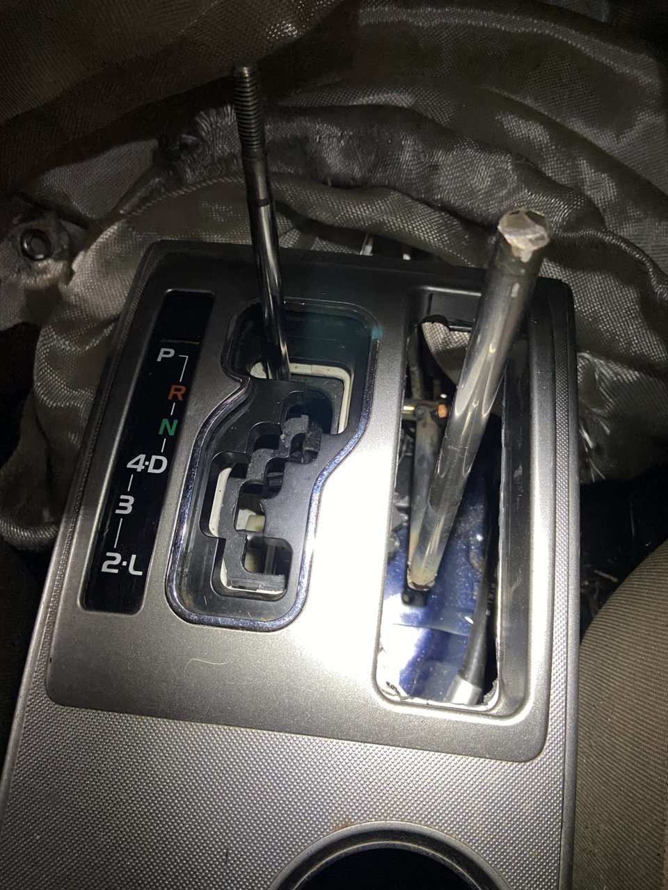

    Does anyone know a good slip-on type fj shift knob? I’m using 1/2 steel rod and really don’t want to thread it lol

    What about just welding a bolt on the end? That’s what I’d do if I needed to thread something

    :eek:You just blew my mind I’m gonna do just that!

    You could also weld the thread end of the original shifter on there.

    That’s what I did with my old shifter. Cut out the center and welded a wrench in. Blended it all together and it looks like a wish.com version of a hurst

    Nice. How are people attaching the boot to the coin slot?

    Zip ties. Lots of material there, just cut slits into the boot for them.

    Velcro.
