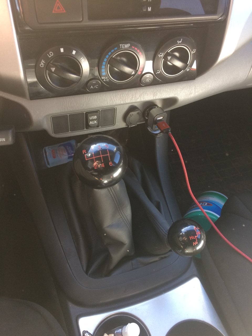

    I thought there was a twin stick specific show off thread but I can't for the life of me find it. :confused:
    I want to see some setups so I can get ideas on how/where I want my extra fun levers.

    FJ t-case with twin sticks, UTE bed, some other things :D
    @tacoma16 gave me twin stick envy.
    I have started down the path, with guidance from him. :cookiemonster:

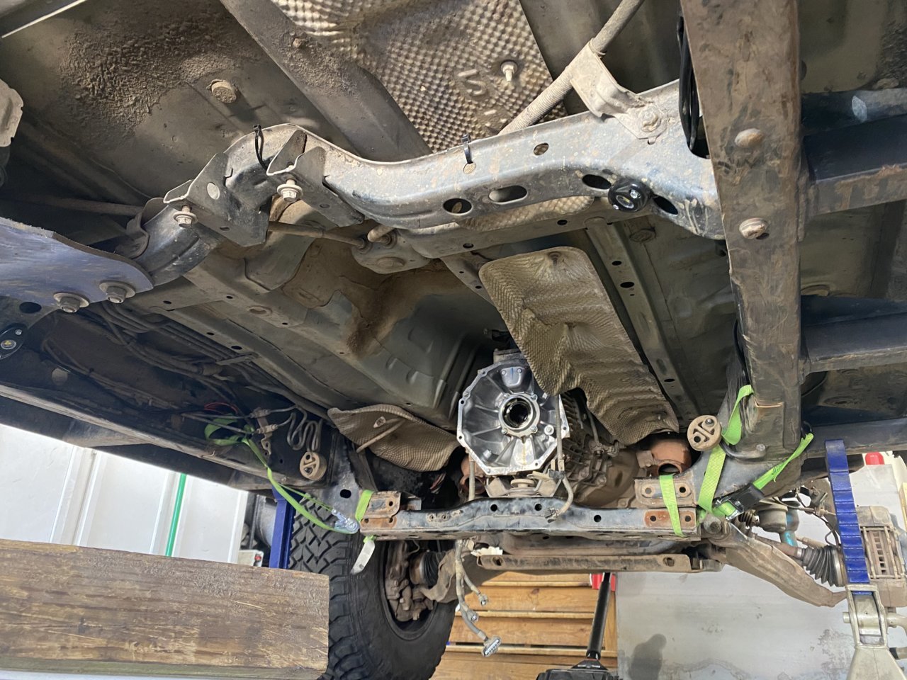

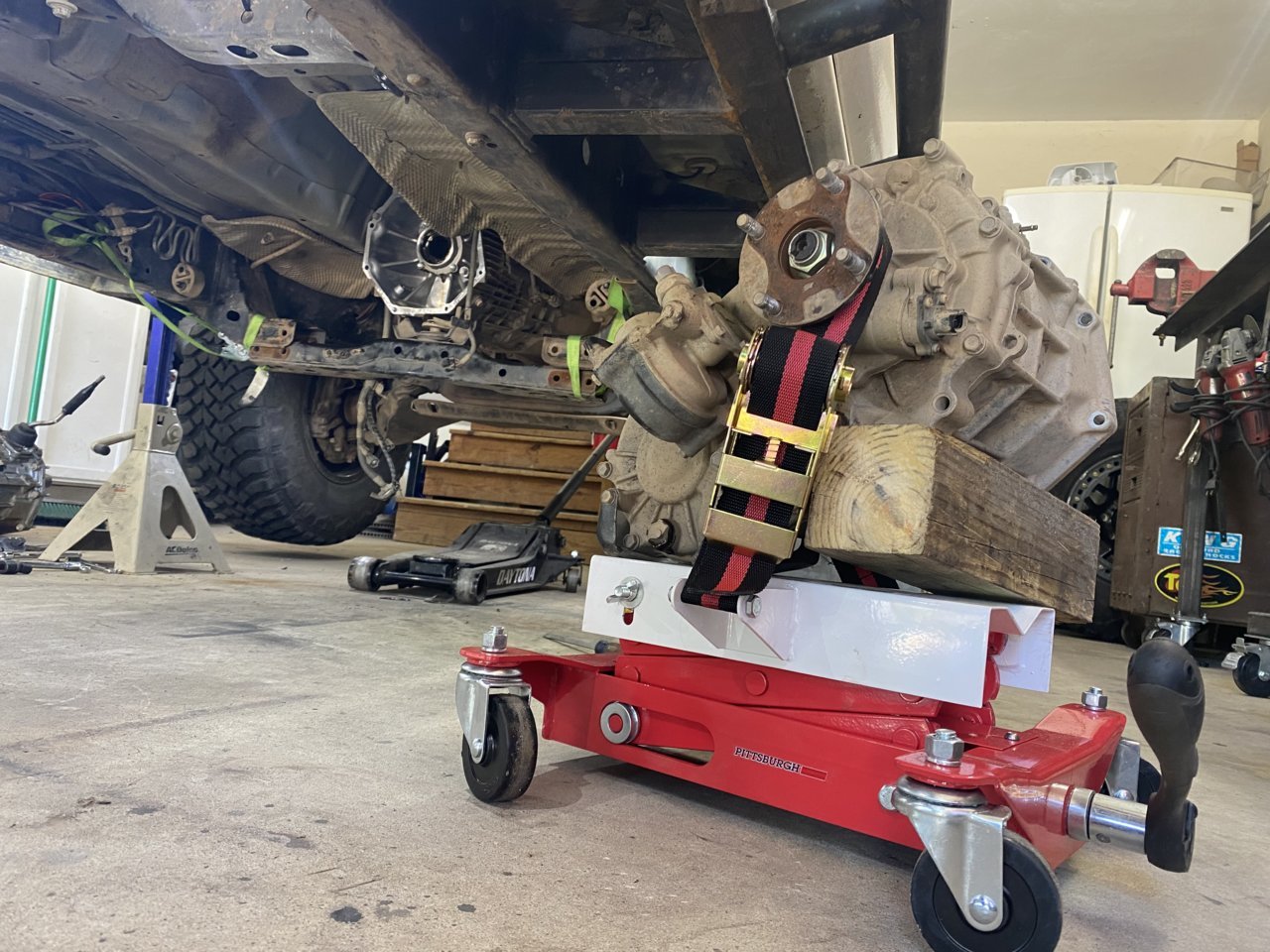

    Stopping for the day so I can have plenty of time tomorrow to swap input shafts without any interruption. A transmission jack made life a lot easier while working alone. Honestly, this has been really easy thus far and I only have fairly intermediate wrenching knowledge. Remove Y pipe, remove driveshafts, unbolt the bolts holding it to the tranny and off she comes.

    I was supposed to remove those peaces ..... doh... lol. nice pic's defiantly keeping an eye on this...

    I thought about working around various stuff but I figured I’m not in any rush. I may as well make this enjoyable and really take my time. So much room for activities.

    Prob the smarter way to do it. I bench pressed that sum b up there lol don’t forget to mark/drill a pilot hole so you know where to cut through the floor!

    @JBTacoma and i tried that and then decided to use the jack lol or did we?

    Yes we used a jack, point the flange straight up and roll it toward the back as you jack it up and it will roll right into place.
