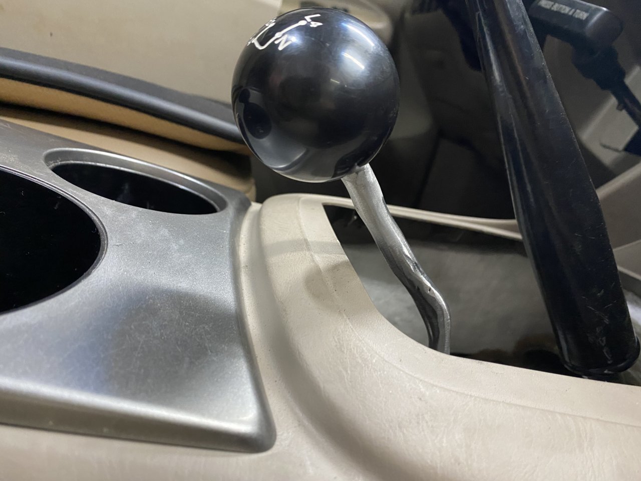

    Windigo
    Windigo Well-Known Member
    Dec 21, 2019
    #313884
    4,181
    Farook
    Toronto Ontario Canada
    '14 Acess Cab

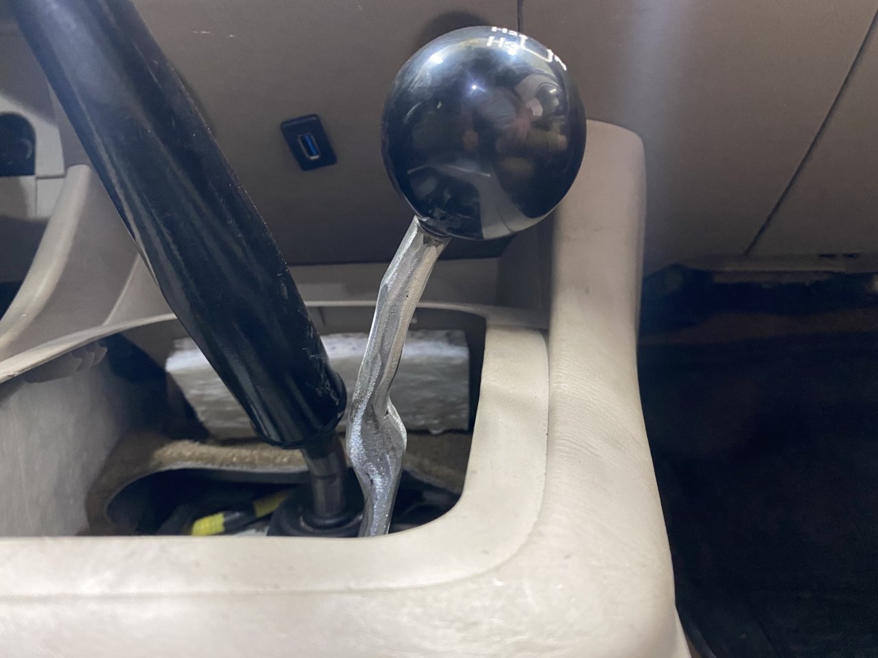

    A picture showing shifters bent to avoid messing with my cup.holders

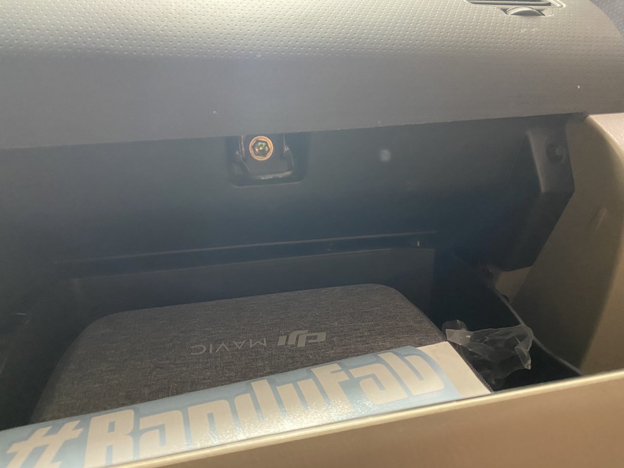

    It has two. Take out the glovebox, and where it latches, there’s a single 10mm bolt. Undo that, remove the plastic cover and you’ll see the 4wd ecu. It’s hiding behind there.

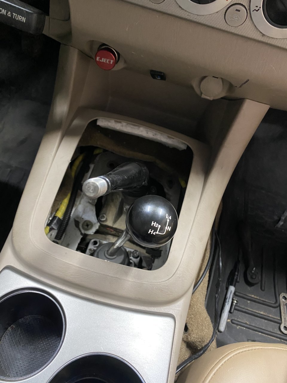

    Phew, I think I finally found the sweet spot. Clearances are pretty good. I have a minimum of 1” gap at all points. It may occasionally hit the trim while really twisted up but I’m ok with that. I just don’t want it rattling all the time.
    Not all these bends are necessary but that’s just how she ended up with the constant cutting and tweaking.
    6th gear/2hi
    4hi
    4LO
    dborrer, airmax233, whatstcp and 7 others like this.

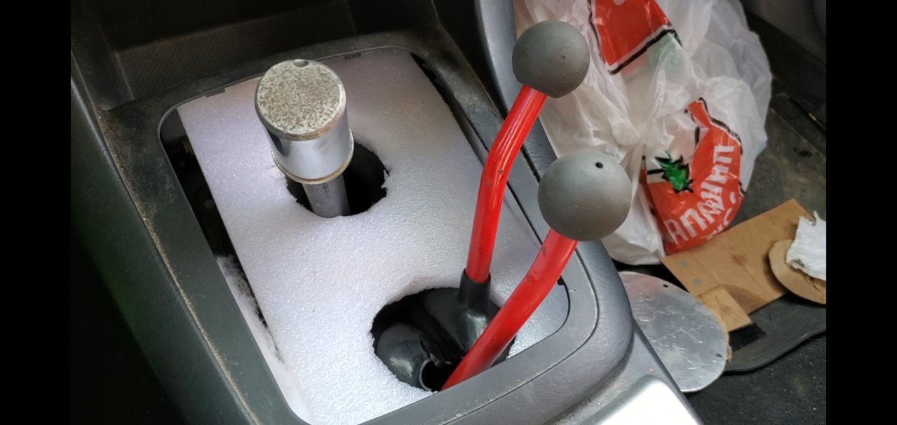

    FJ t-case with twin sticks, UTE bed, some other things :D
    Looks like SEMA quality to me :thumbsup:
    Very nice :rolleyes:

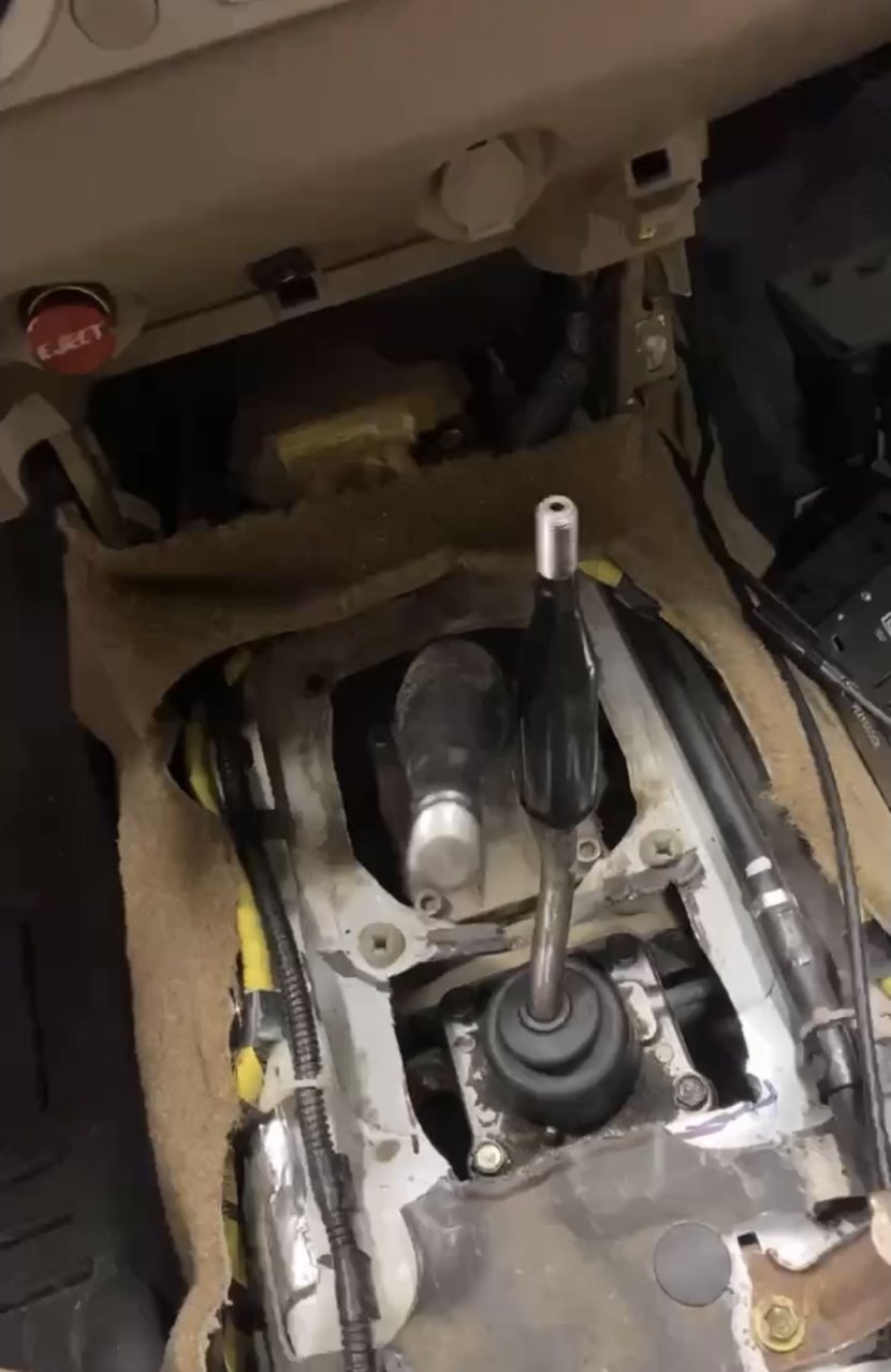

    Well after a test drive, I noticed some seepage from between the t case and trans. Did some sleuthing and I have a leak at the output of my trans and I didn't notice it. Now I've gotta drop the case again for like 5 minutes worth of work. If I have to drop this case a 3rd time, twin sticks are going in.
    Noticed this after the fact.
  20. Apr 29, 2021 at 4:55 PM
    #1880
    DaytonaTaco
    DaytonaTaco Well-Known Member
    Feb 25, 2017
    #211621
    159
    2015 Tacoma Sport 4x4 access cab 6spd w/ tow package
    o_O This is the first time I’m seeing that
