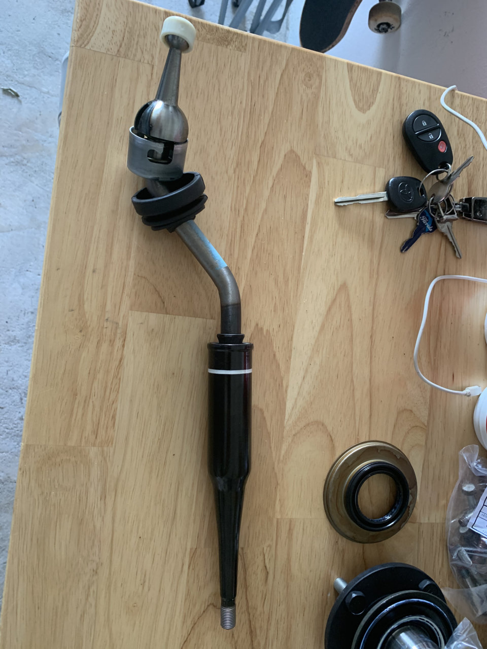

  5. Apr 30, 2021 at 9:21 AM
    #1905
    DaytonaTaco
    DaytonaTaco Well-Known Member
    Feb 25, 2017
    #211621
    159
    2015 Tacoma Sport 4x4 access cab 6spd w/ tow package
    Also, I’m hoping this works, it came in today. The FJ MT shifter.

  7. Apr 30, 2021 at 10:46 AM
    #1907
    EatSleepTacos
    Mar 24, 2015
    #151688
    59,838
    Randy
    West Valley, AZ
    2017 4Runner
    How difficult was it to do this? Did you sew the wire piece into the new one or just zip tie it?
    BassAckwards[QUOTED] likes this.
  8. Apr 30, 2021 at 10:48 AM
    #1908
    BassAckwards
    BassAckwards Well-Known Member
    May 3, 2016
    #186002
    27,954
    2009 Tacoma AWD Turbo 2TR-FE
    Full-time AWD & BorgWarner EFR 6258
    It was a bit time consuming. I pulled the old wire out of the stock shift boot and the FJ boot and had the taco wire sewn into the FJ boot. My mom can sew, so i had her help me with it. She mentioned that the center seam had to be removed and sewn back up to get the back section of the boot to fit and look good. If you notice when you remove the stock tacoma wire piece, the section at the back is narrower.

  10. Apr 30, 2021 at 10:50 AM
    #1910
    EatSleepTacos
    Mar 24, 2015
    #151688
    59,838
    Randy
    West Valley, AZ
    2017 4Runner
    That's good info, thanks. As much as it pains me to spend $100 on an FJ boot, 1/3 the price of the t case, I don't know if I'll be happy with anything less. I love the finished product.
  11. Apr 30, 2021 at 10:52 AM
    #1911
    BassAckwards
    May 3, 2016
    #186002
    27,954
    I agree, you've gone this far, the FJ boot really cleans things up. 100% worth the extra cost

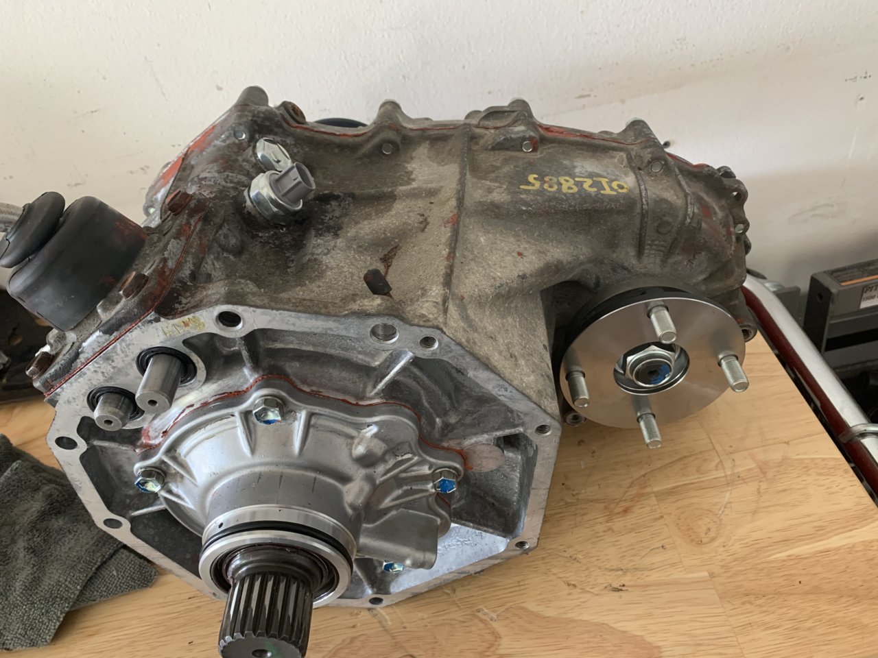

  13. Apr 30, 2021 at 11:05 AM
    #1913
    DaytonaTaco
    Feb 25, 2017
    #211621
    159
    I’d say she’s ready.
    EDIT: of course I’ll stake those nuts
    Key-Rei, 6 gearT444E, Littles and 2 others like this.

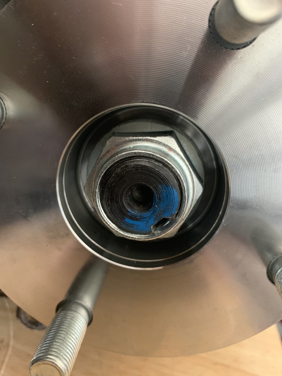

  15. Apr 30, 2021 at 11:25 AM
    #1915
    DaytonaTaco
    Feb 25, 2017
    #211621
    159
    I just used permatex gasket maker from autozone
    And the nuts that get staked are for the output flanges. There’s a spot where they thread on to stake them after you’ve torqued them. I think it’s 87ft/lbs for those two. See the pic
    llamasmurf[QUOTED] likes this.
  16. Apr 30, 2021 at 11:27 AM
    #1916
    DaytonaTaco
    Feb 25, 2017
    #211621
    159
    I don’t know if the blue mark is called anything specifically
  17. Apr 30, 2021 at 11:30 AM
    #1917
    BassAckwards
    May 3, 2016
    #186002
    27,954
    I think the blue marks indicate it was torqued from the factory
    llamasmurf likes this.
  18. Apr 30, 2021 at 11:52 AM
    #1918
    llamasmurf
    llamasmurf Herpa Derp
    Mar 1, 2016
    #179866
    5,187
    Wes
    Northern Ontario
    '15 Matte Black TRD AC
    FJ t-case with twin sticks, UTE bed, some other things :D
    :hattip:
    Thanks guys.
  19. Apr 30, 2021 at 6:50 PM
    #1919
    6 gearT444E
    6 gearT444E Certified Electron Pusher
    Feb 3, 2018
    #243372
    7,798
    Deep South
    Herculiner Hootus
    It's called cross check (one brand anyway), used to verify items were torqued and not messed with or have come loose at the factory, probably for the QC guys. You can buy it and add some for the peace of mind if you wanted to.
    https://www.durablesupply.com/dytaprtoma.html#.YIyzYLVKhPY
