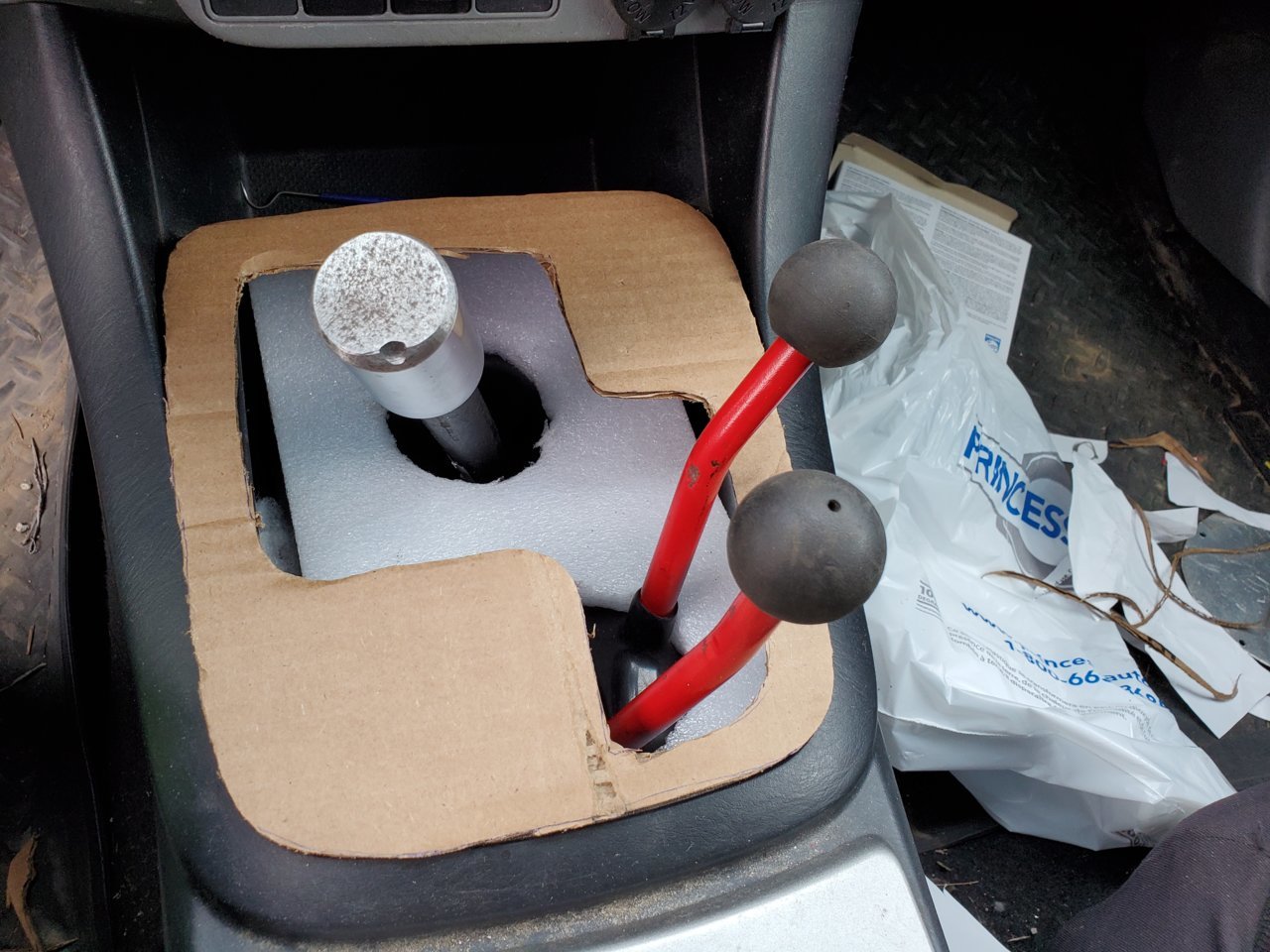

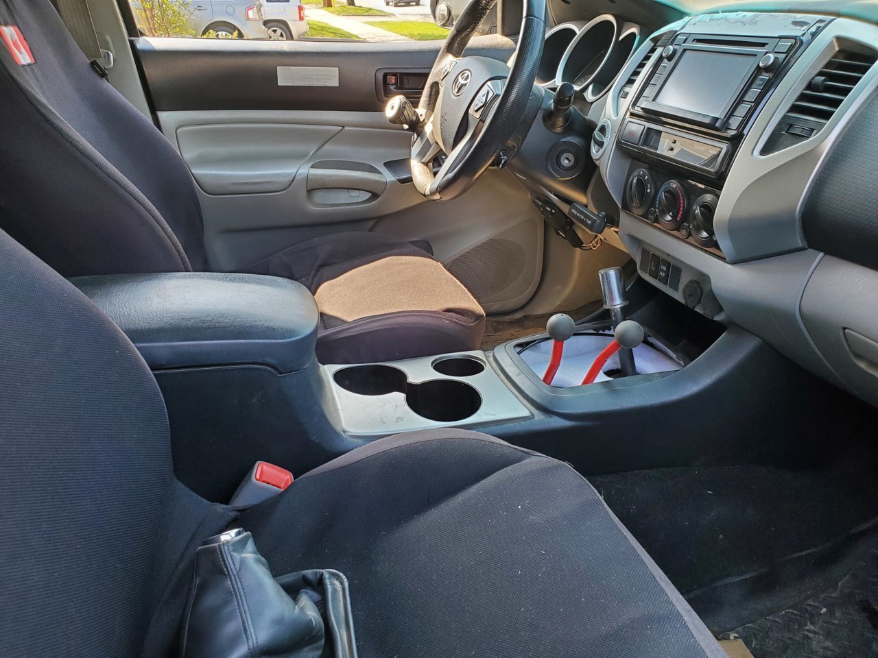

    Still trying to decide where I want to locate my sticks. I like the idea of one on each side of the 6 speed shifter.
    shifter location was the hardest part of the whole job for me

    You got pictures of how you placed yours?

    ok found a pic of finished product. minus shifter boot

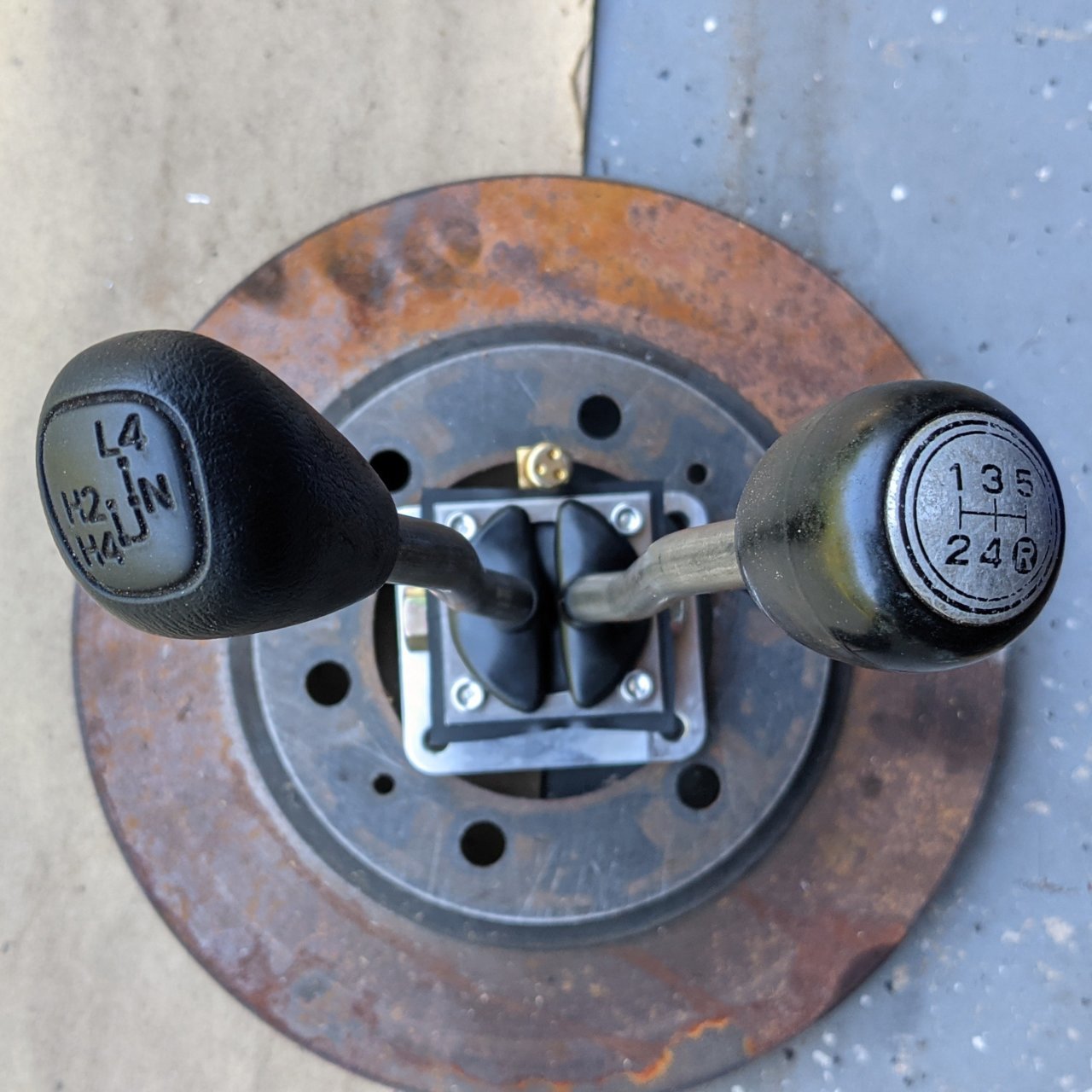

    I do like how they're both off to the side and out of the way like that, can each easily be grabbed and shifted independent and opposite of each other comfortably while jostling around in the cab on an off camber trail? :D
    No idea on positioning but I got my knobs picked at least.
    The original 4WD shift knob from my old truck and the knob from a true first gen "Toyota Truck" that I was actually using as the 4WD shift knob on my old truck.

    I have.to start.to make some.kind of closure for the console. Don't know where to go from hear but it's a start.

    Oh that’s nifty. Are you skipping a traditional boot and doing something else?

    I.dont know. This whole project has been by the seat of the pants. Let's see.
