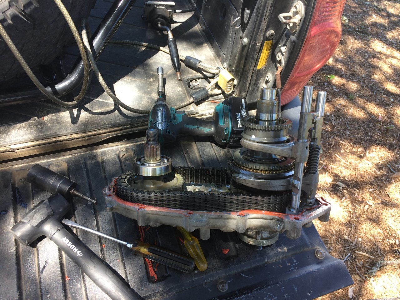

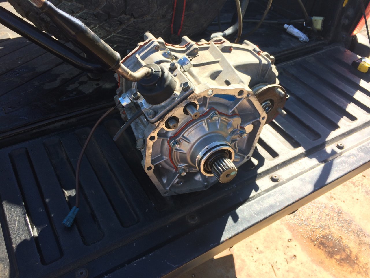

    your doing this on the tailgate of the truck
    dude that is so Texas. :)

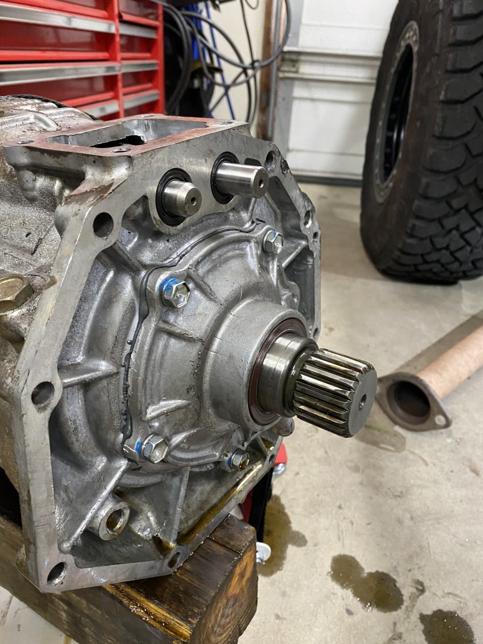

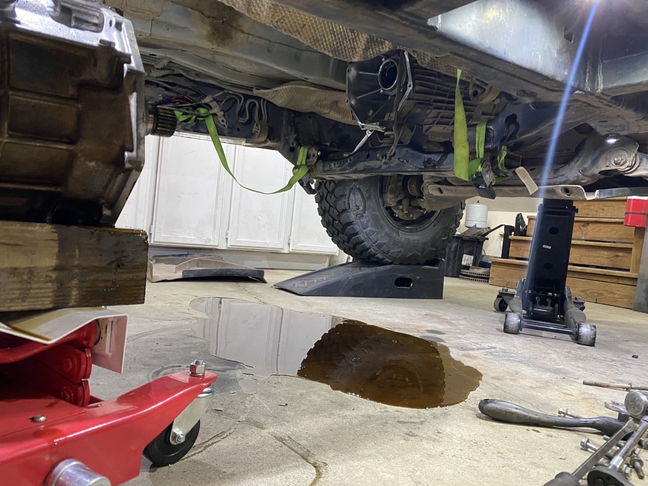

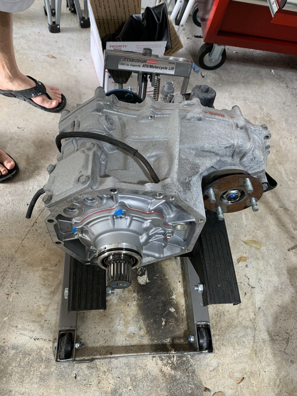

    Remember how I said I had some fluid where the trans and t case meet? I dropped the case again today and Niagara Falls opened up. It’s not gear oil, so definitely trans oil. It doesn’t have that rotten egg smell. I’m going to reseal the back of the trans with FIPG and top it off and see what happens.

    I think someone mentioned this already but are you using the FJ flange or taco flange? The taco flange for the manual has a seal, the FJ does not.

    I don’t remember, I think I’m using the FJ one. I noticed the other has an O ring which would make sense as to why it’s leaking. I just didn’t see it mentioned in Wyatts original write up. If there’s anyone else that has swapped input shafts on the 6 speed, is the plate with the O ring the one that should be used?

    Yeeeep, this pic confirms it. Stock case out of the 6 speed uses the O ring. Well at least I know the issue now.

    Thanks for chiming in and saving me a lot of frustration of having to drop the case for a third time, inevitably.

    Already posted in your other write up, but yes that'll do it. The A750F has a rear seal in the housing whereas the RA60F does not. I do remember when swapping my crawler in, putting the seal housing extension in thus negating the need for the O-ring. If you are strictly swapping an automatic FJ case into a RA60F 6 speed you will need that O-ring and associated 6 speed front plate, otherwise there will be no seal between the transmission and t-case. Picture of the seal housing extension used for the crawl box, which installs a seal similar to the OEM A750F output.
