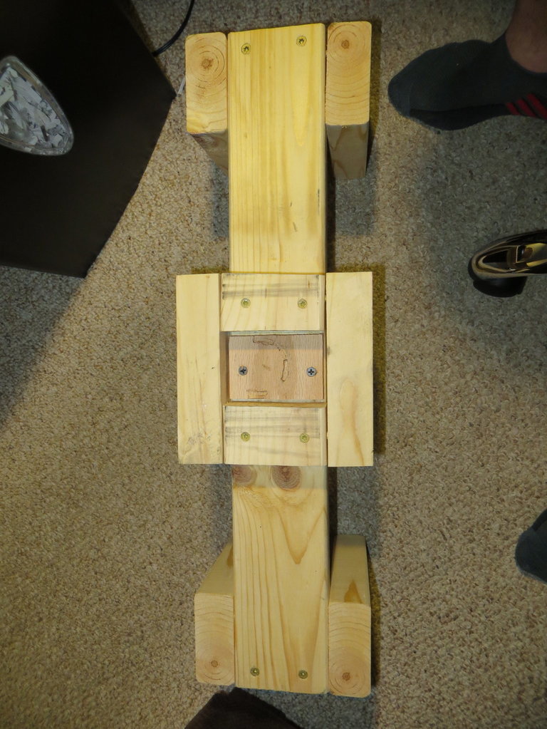

    I put this up a few weeks ago in the "what have you done today" thread. But it was certainly frugal, so I'll throw it up here. :thumbsup:
    I built a jig to lift the truck from the rear-end. You can jack it up from the diff...but I wanted something a little more stable and spread out the load more. It's also safer as it's a lot less likely to slip off of the rear-end like a jack by itself might. Plus I don't mar up the pumpkin's finish. Lifting both wheels off the ground at the same time makes quick work of throwing on and taking off my snow tires as needed or doing a tire rotation.
    $2.20 2x4 from Lowe's.

    NICE!! Any chance of sharing the dimensions? (save me some time) Thanks

    Sure. :thumbsup:
    All 2x4 material. Screwed together with 2.5 inch decking screws
    The main body is 2 feet long.
    The 4 upright pieces at each end are 7 inches tall.
    The 2 pieces in between the 4 uprights are just slightly proud of 3.5 inches.
    The provision (channel) for the drain plug is about 1.25" off of center.
    The "box" on the underside that fits over the jack head will vary depending on your particular jack.
    Your overall dimensions may very slightly. Hope this helps.
    Here's a shot of the bottom. The little piece in the center is just a small sacrificial piece of plywood that I can replace as the jack head eats it up.
