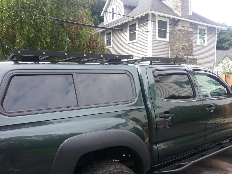

    Finished up with my DIY racks both cap and half cab. Only thing left may be a fairing on the front.

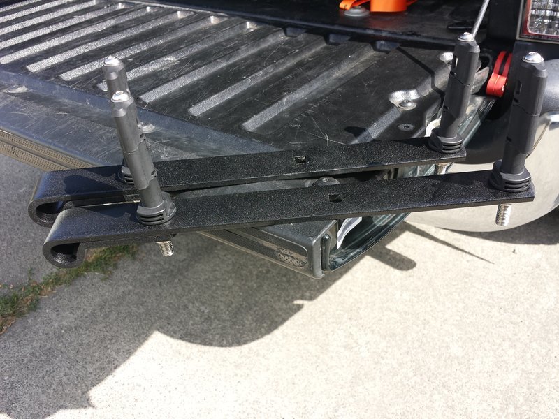

    DIY Maxtrax mounts.
    This 14" strap hinge amazingly has the two outer holes 10 9/16" apart center to center which just so happens to be the EXACT distance the Maxtrax holes are spaced.
    That left the center hole for mounting to the rail with a 3/8" hex bolt and T-slot nut.

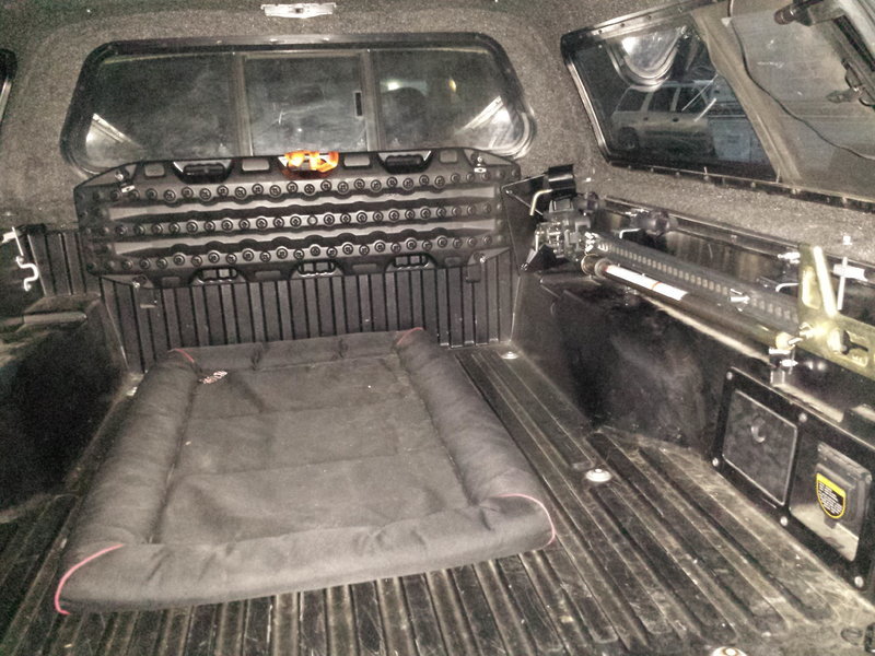

    Cute pup.

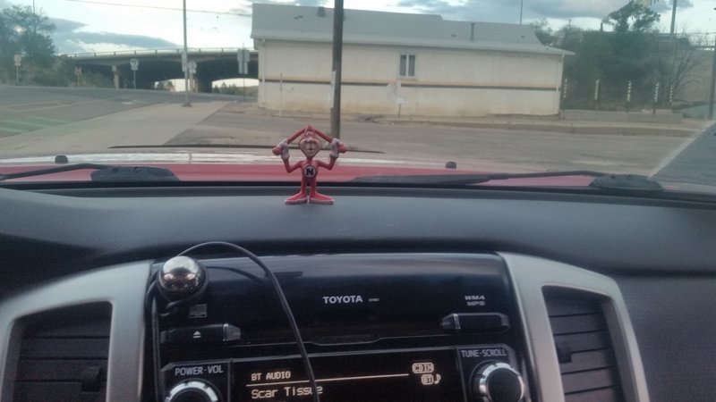

    Got my first cheap mod done :)

    Some people might be a-noid by that mod. :rolleyes:

    Agreed! The dog takes the fotobomb award!

    Is that a Steelie phone holder? If so, how would you rate it?

    Yes it is, I really like the placement there, I have a galaxy s5 and it doesn't get in the way of anything on the radio or vent

    Does the S5 have wireless charging? I ask becaues I'm curious if the part that sticks to the phone would interfere at all
