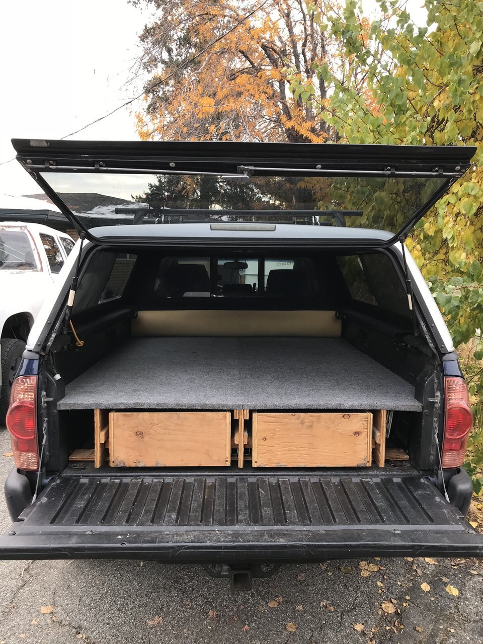

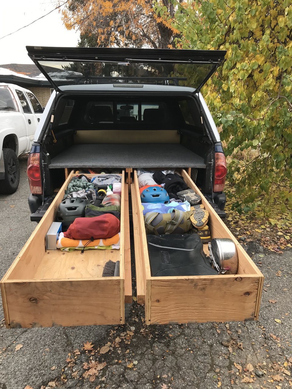

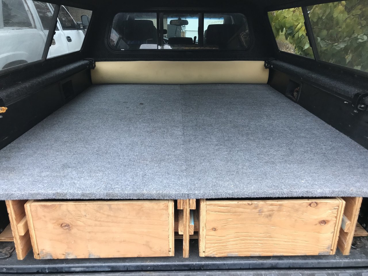

    00960F02-FD0E-4D3D-ABEC-0920F3B722D6.jpg A3E7FD23-7350-4235-95F6-67B5946EB4A8.jpg 8BB91911-8032-4B18-BC60-1F5EC9434F2B.jpg
    200 bucks or so for all the materials but it’s given me years of gear storage while on the road, and a dry place to crash for the night

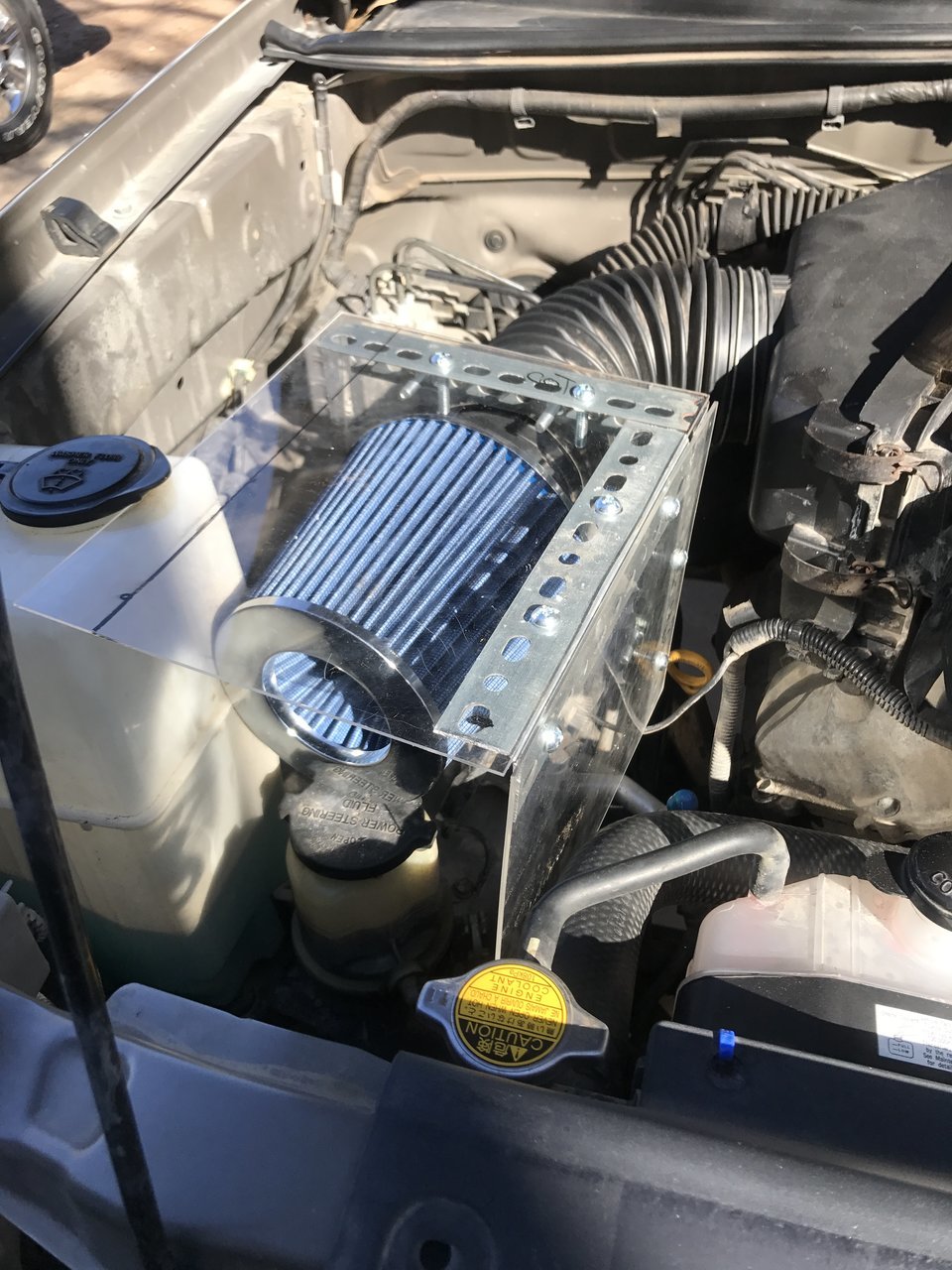

    Hand made heat/mud shield for my handmade CAI. All in~ $40 including the filter!!

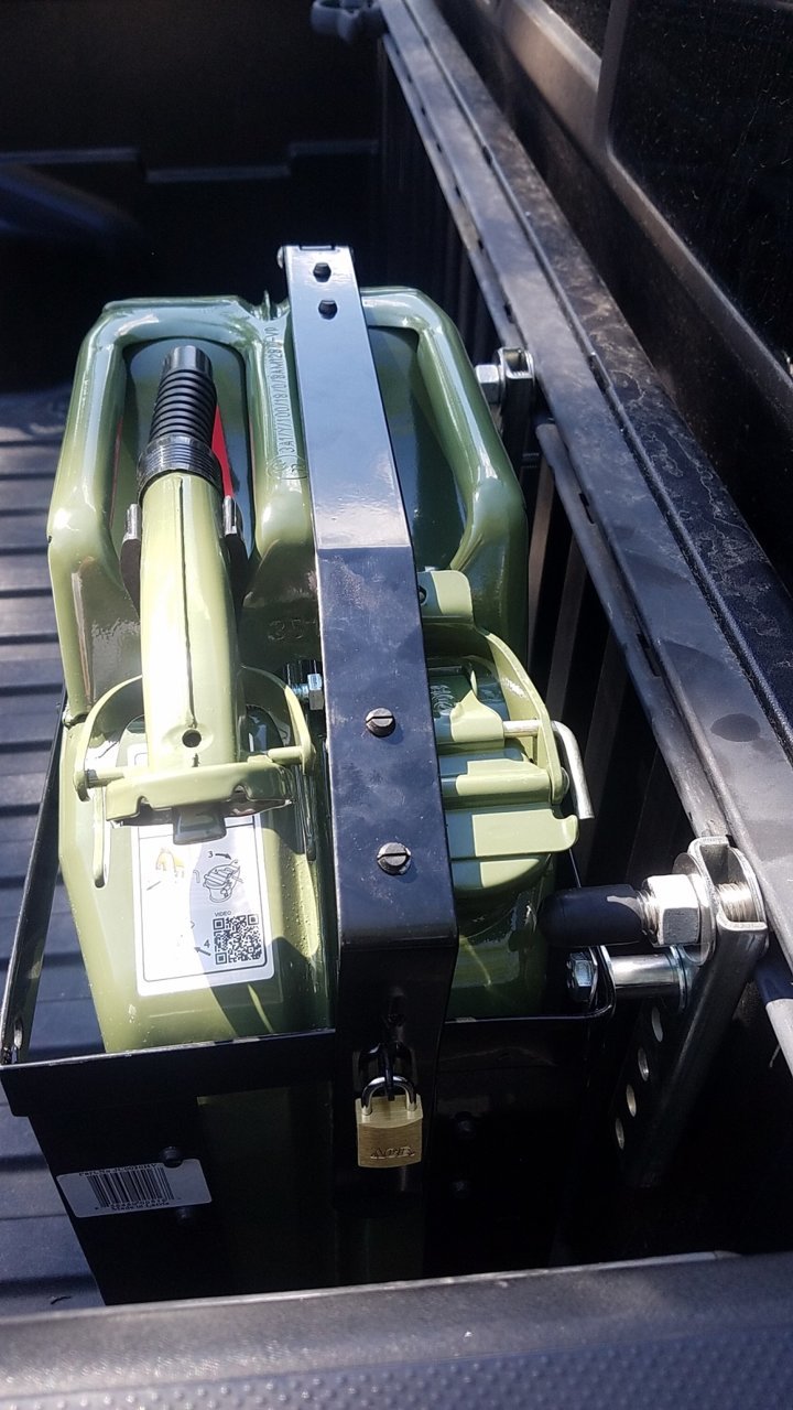

    It's pretty janky, but secure AF. I re-purposed some tension brackets I got off a failed wheel jack from the jet ski trailer. I bought some big @$$ carriage bolts and a bunch of washers to utilize the already existing rail system (in order to avoid drilling in the bed). Holds pretty well and isn't going to fail unless the entire rail does. I had to put a couple of rubber pieces underneath the fuel cage to help support the load on the rail, as when I torqued the bolts it tended to "lift" the cage. Anyways, enjoy!
    No the prettiest, but it works. It ended up being more than I wanted to spend on the project, but that's because I didn't lay out any blueprints and went through a lot of trial and error, trips back/forth to hardware store, and kept a lot of receipts!
    Fuel Can
    Fuel Cage
