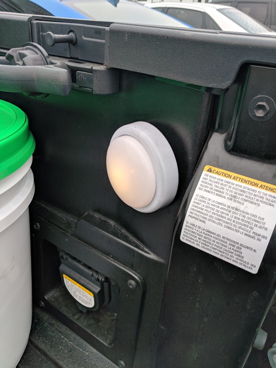

    Lol ok here's a couple for ya.

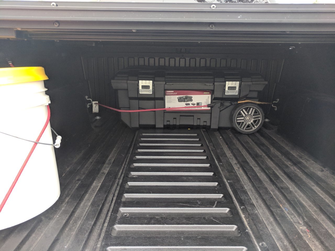

    And don't want to buy that expensive tool box for your bed? 'fraid it will take up too much bed space? Look no further! You and your tonneau can enjoy the luxery of a removable tool box for the low price of 1 bungee cord and a husky tool box.

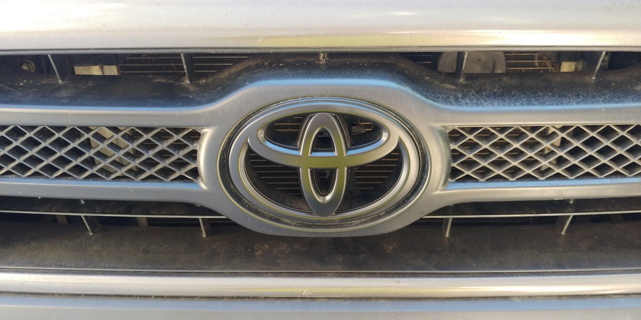

    1027181415.jpg Ok, three mods today with only $40 cash, a six pack of kilt lifter and two millers! My buddy and I made short work of replacing the CV axle. So while we finished our second beer I painted the front Toyota emblem flat black while we were admiring our work. Then we removed the charcoal filter, when I remembered seeing a set of 4 steel rims for $40 on Craigslist. He has a sand blaster in his garage so next weekend we'll blast them and paint them gloss black.

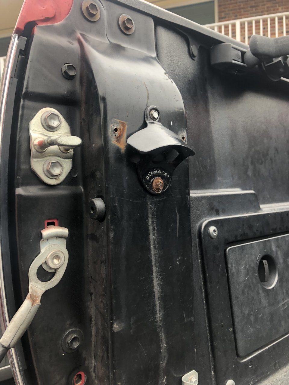

    For those after work beers

    Damn, that’s the best mod I’ve seen so far, cheapest also !!

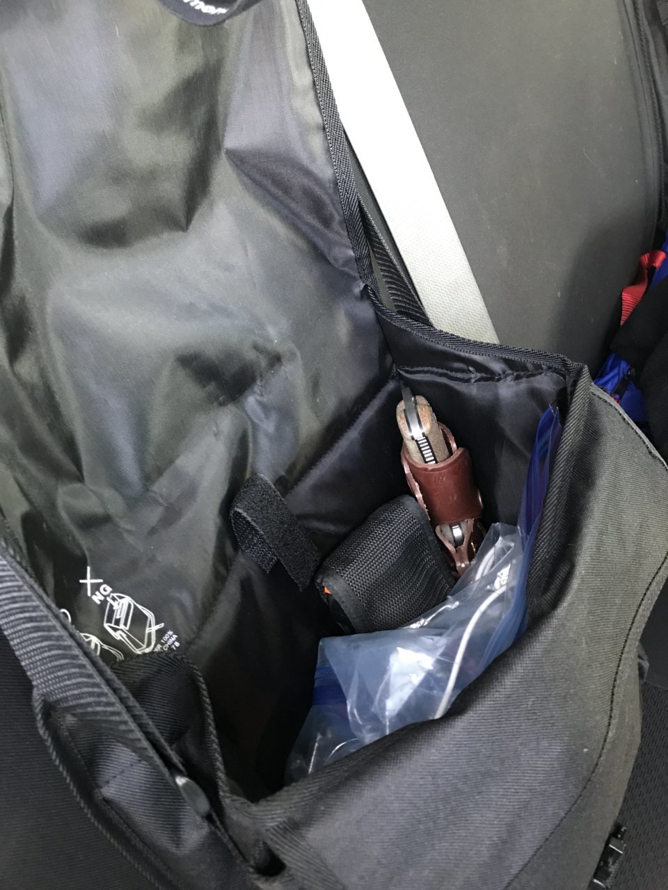

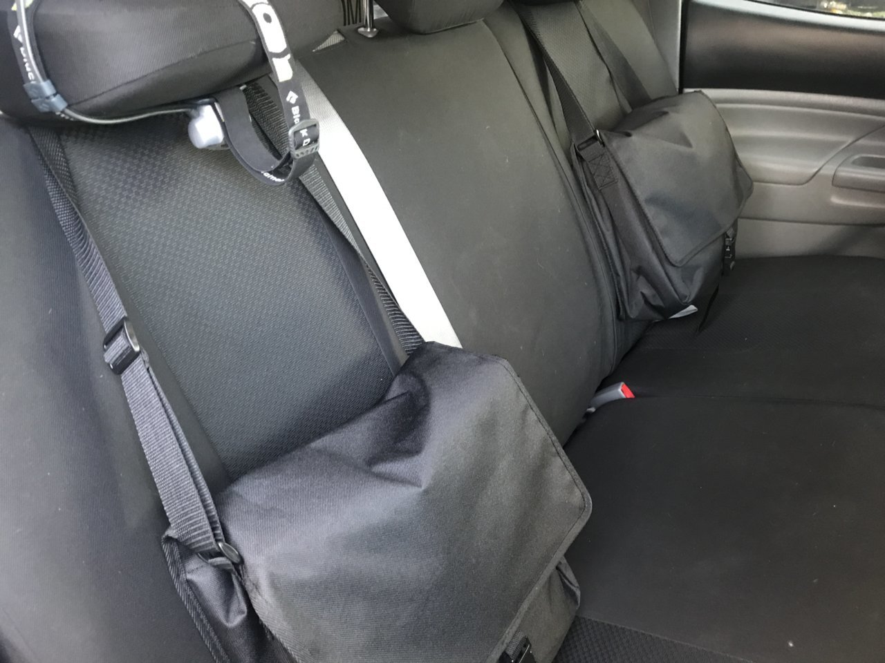

    image.jpg image.jpg I will contribute one: two projector bags destined for the trash. I hang them over the rear headrests and fill them with various goodies that I need when camping or hiking like bear spray and binoculars. When I get home it is easy to grab the two bags with all my valuable gear. Cheers

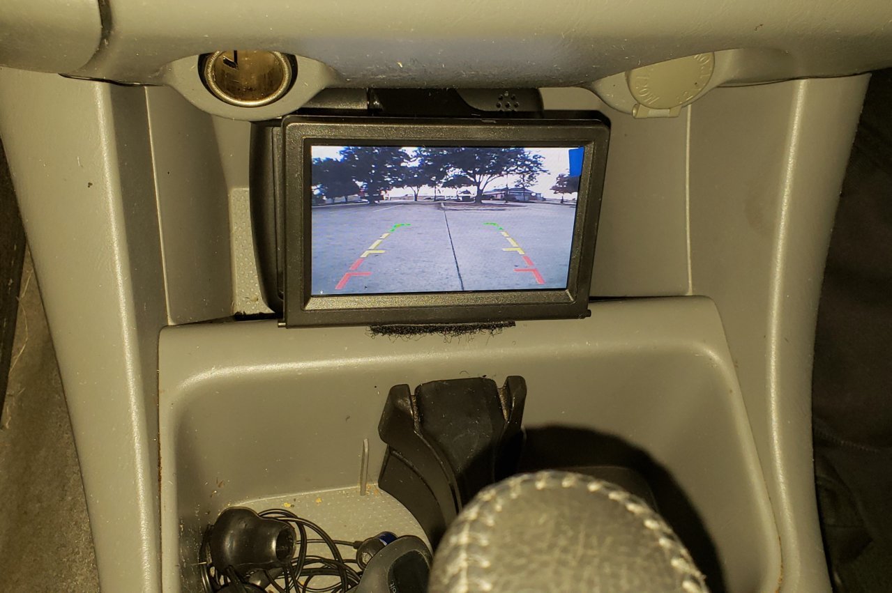

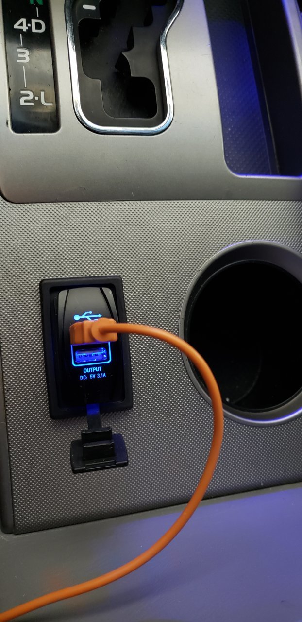

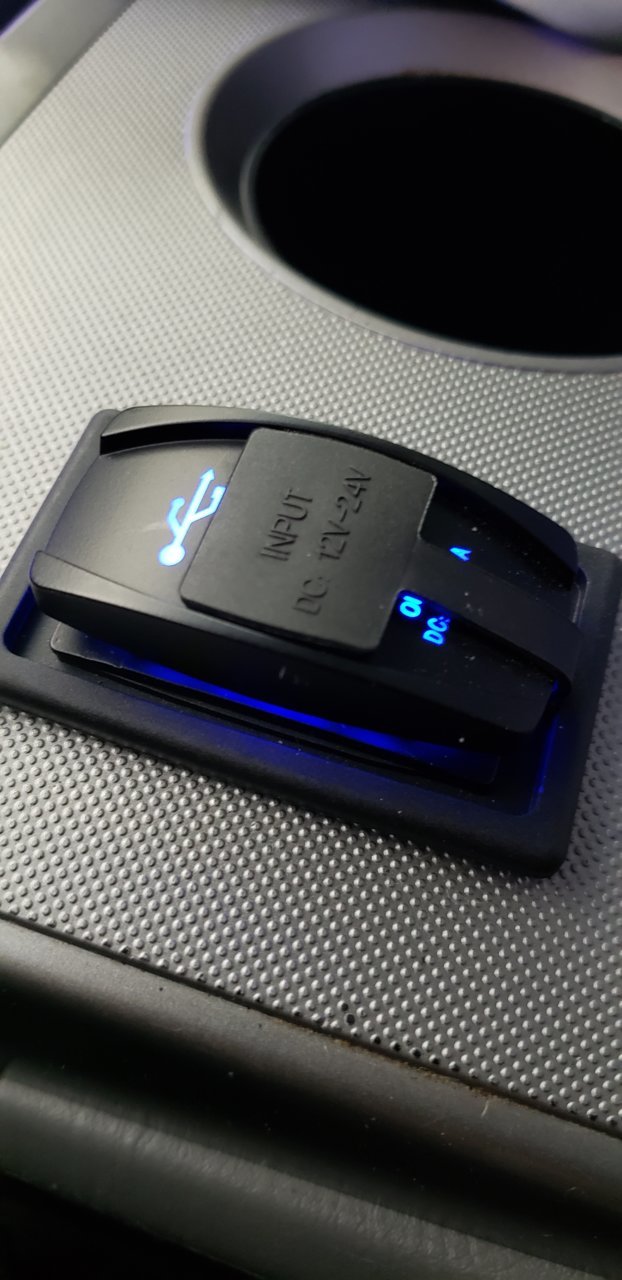

    Added an aux USB charging port next to cup holder(power tapped at cig lighter) and a cheap backup camera controlled by manual switch.

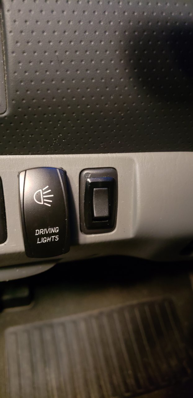

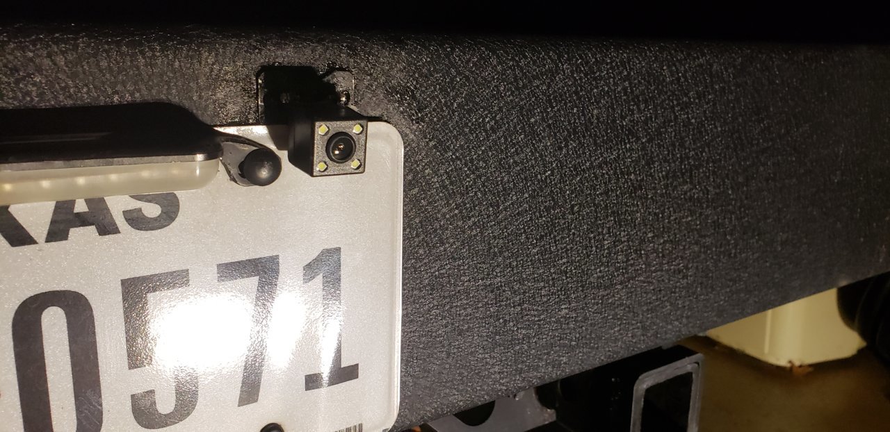

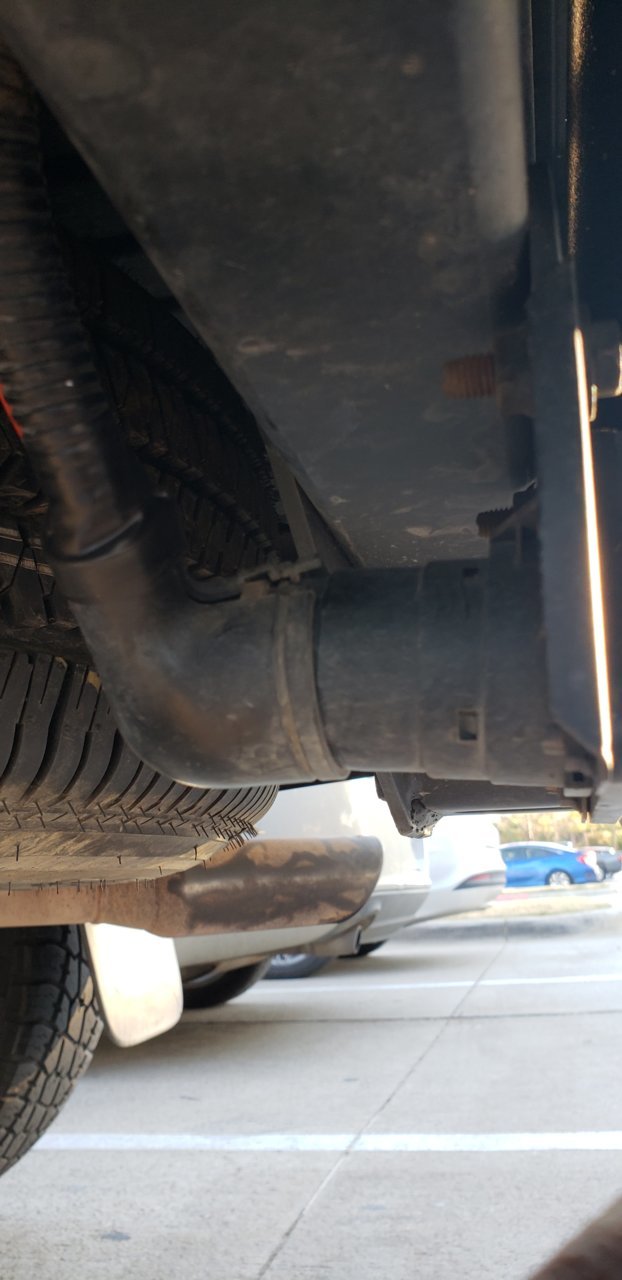

    Backup camera mounted on rear bumper, power tapped to trailer hitch , and screen wired to fuse block through a switch located next to my tacomabeast LED headlight20181222_181031.jpg 20181222_181301.jpg switch.

    Pic of wire tapped to trailer hitch.

    Remove the plastic cover by splitting it open to access the bundle of wires. There is one wire that has 12volts with key on. Mine is the black wire and I just use a wire tap connector to it to power the rear camera. Sorry but I taped it up but you can see the red camera power wire going to it.20181223_083602.jpg

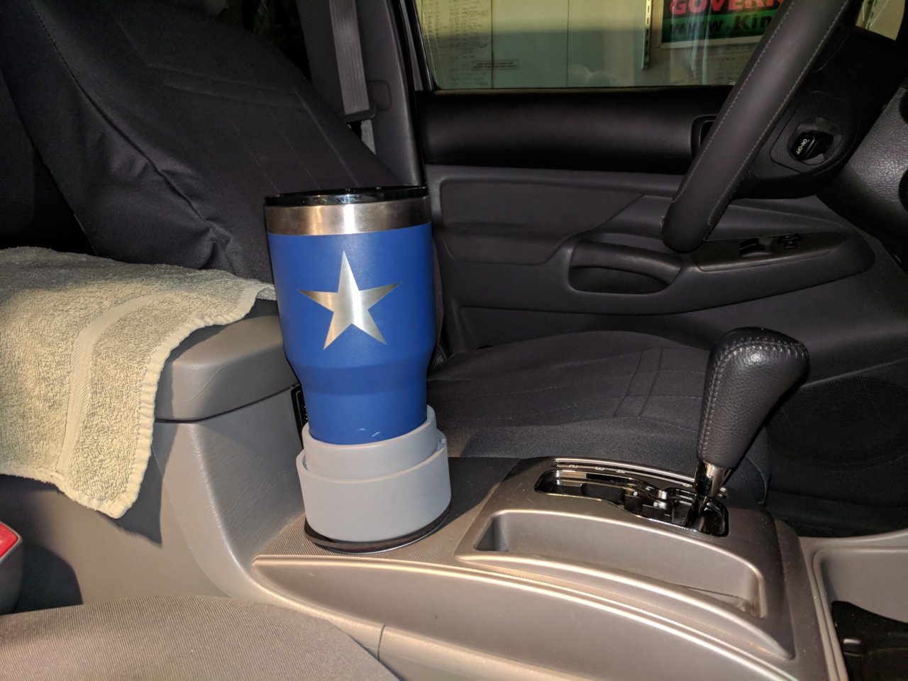

    Tell me more. I'd like to use that spot for big mugs as well

    I have a $5 led light in my toolbox. Held on by velcro (could use more). It's battery powered so no wiring. However, they die faster in winter because batteries don't like cold
