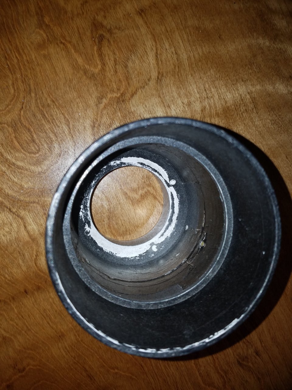

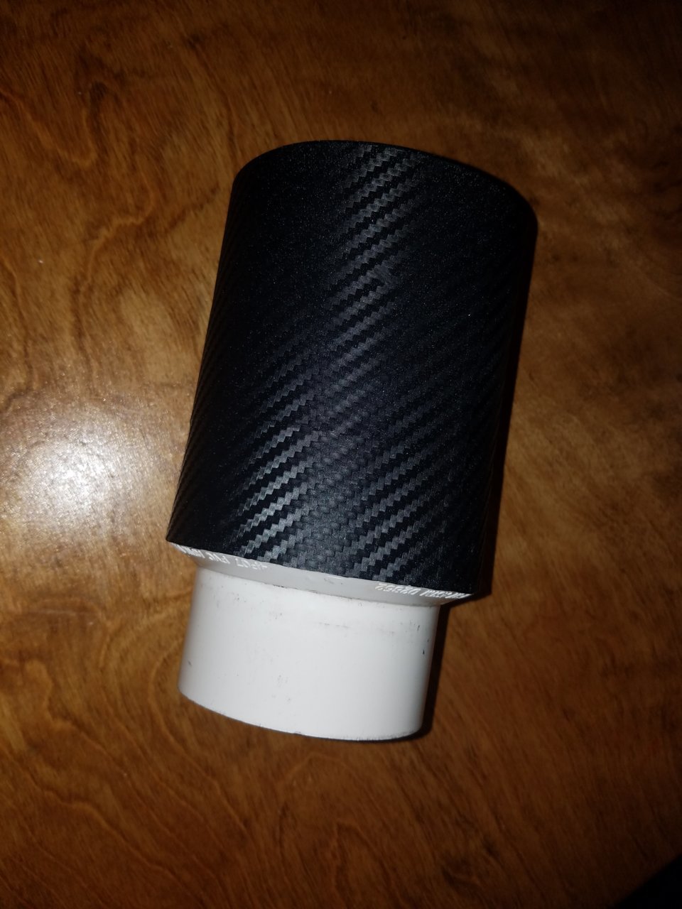

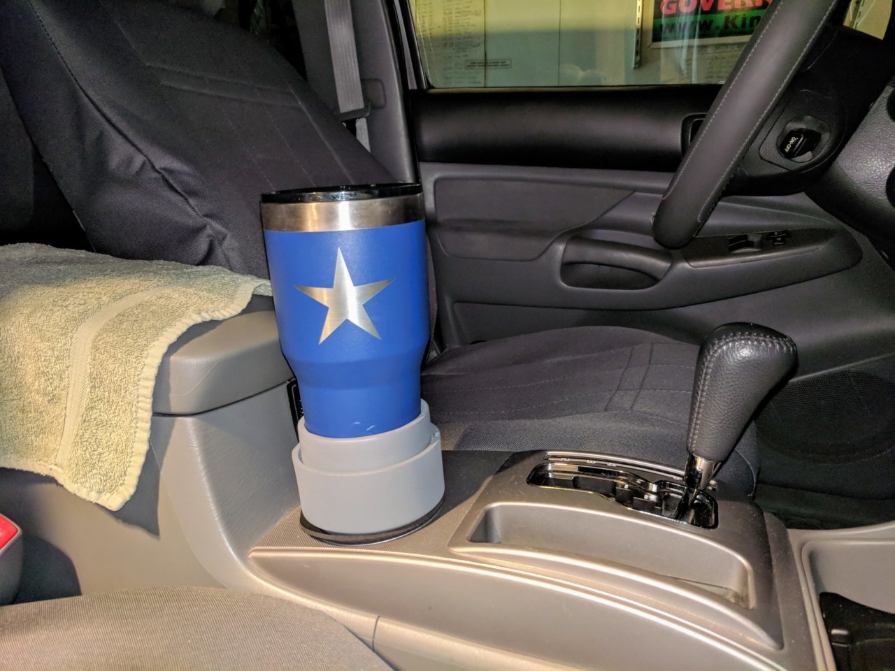

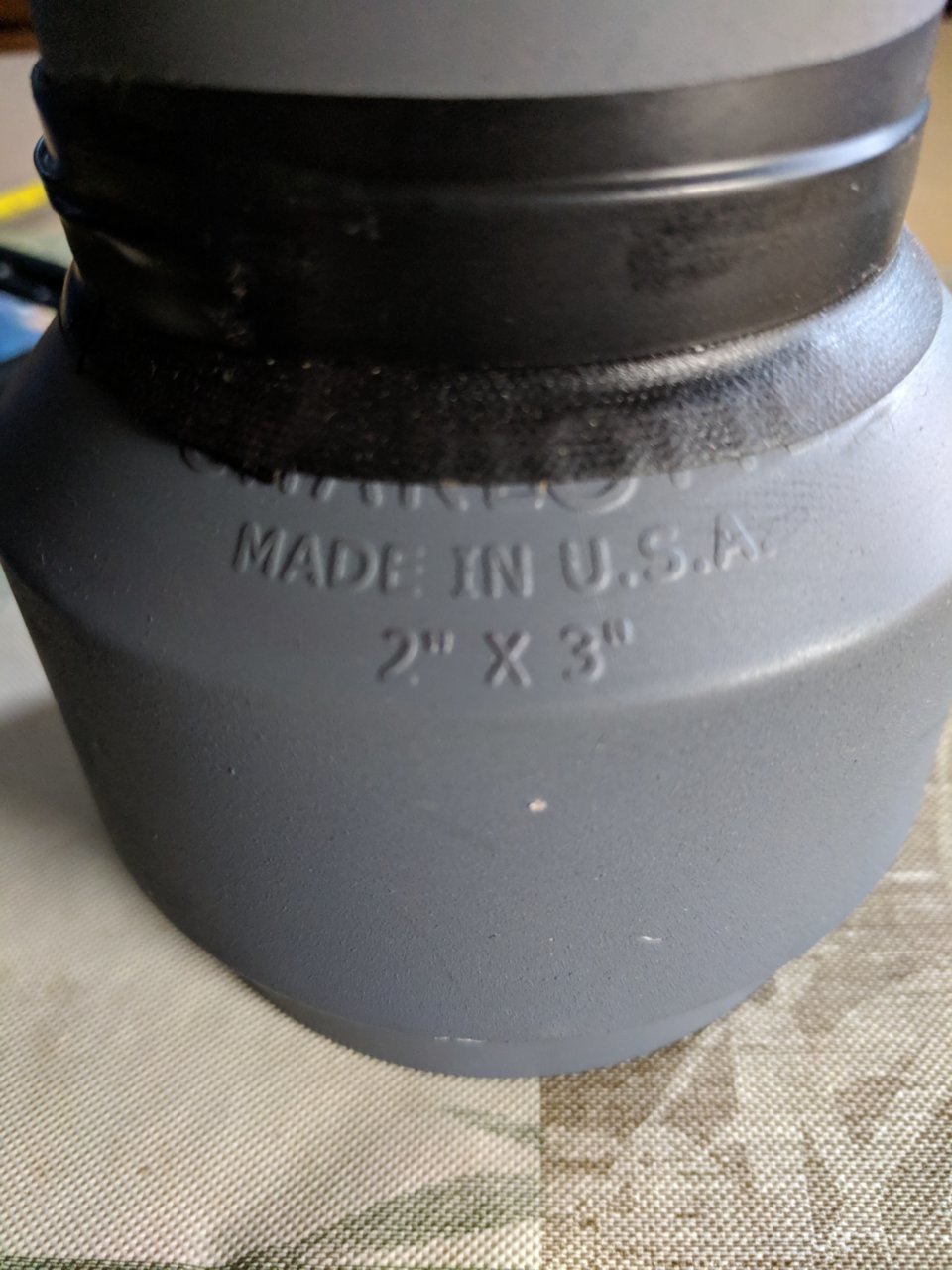

    adadandhistruck said:
    Tell me more. I'd like to use that spot for big mugs as well

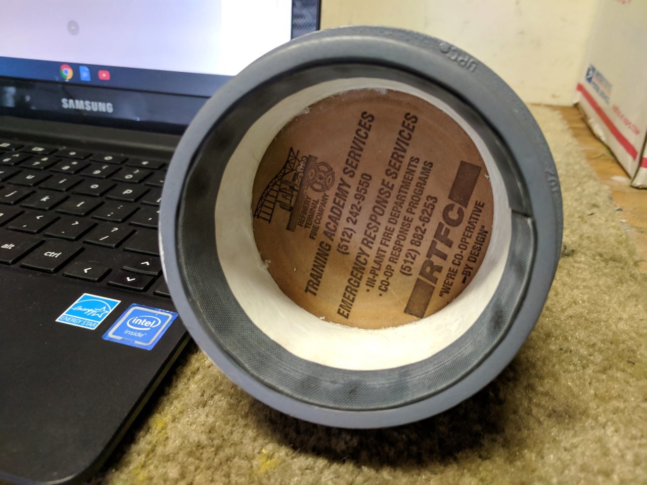

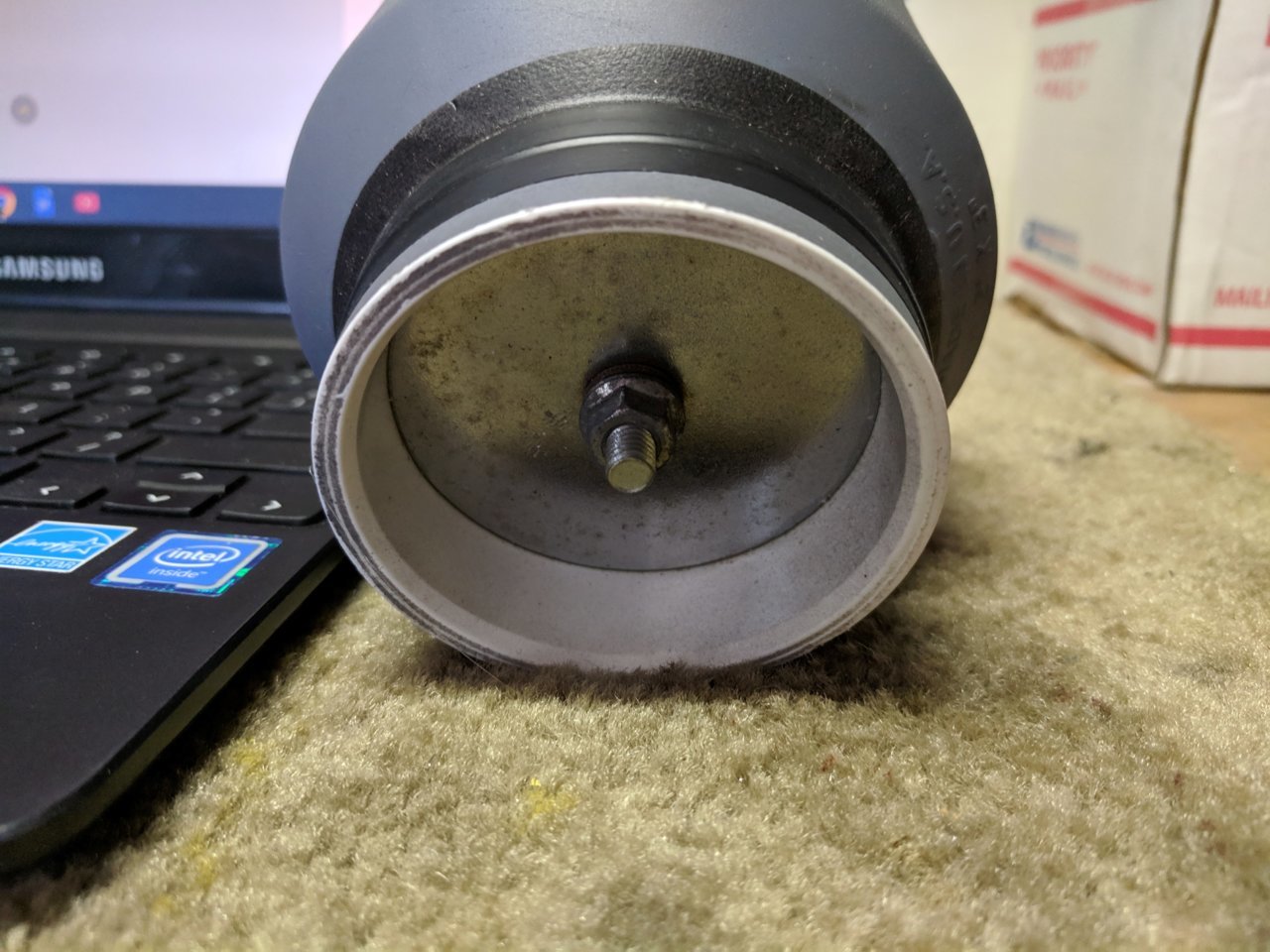

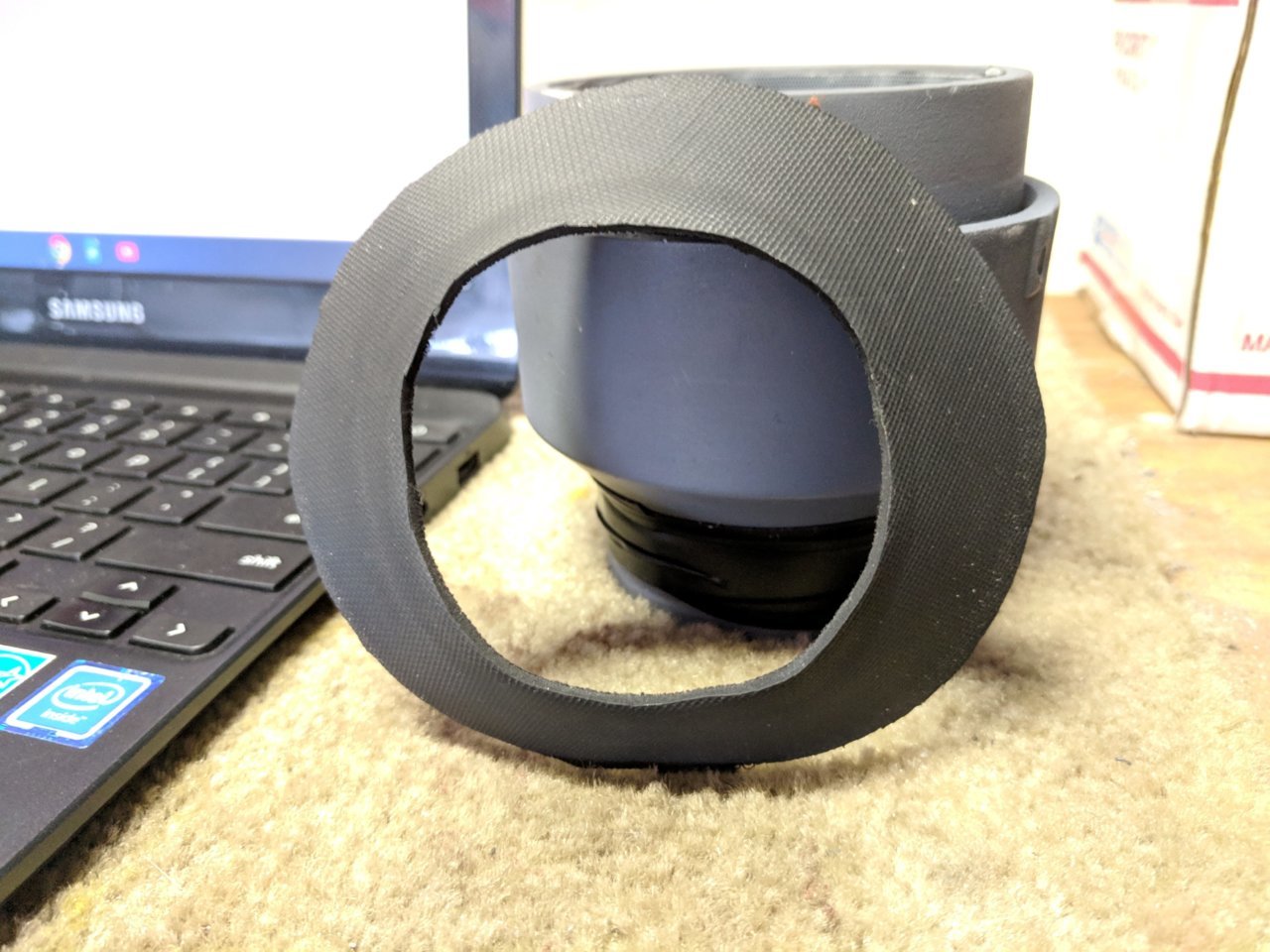

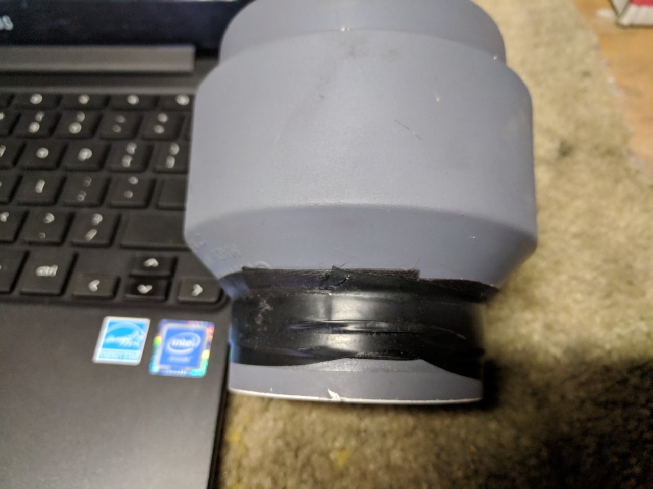

    The kids and the inlaws have all left, so here's my take on this mod. Mine is a little different, as I believe the original poster used 4" pvc. Since I had a good length of 3" pvc pipe laying around I used a 3" to 2" reducer I bought at Lowes. Here's the link to it https://www.lowes.com/pd/Charlotte-...-Schedule-40-Adapter-Coupling-Fitting/3132737.
    I cut a section of 3" pvc about 2 1/4 to 2 1/2" to slip inside the reducer. This cut section is what actually holds the tumbler. I do recall having to open up the ID of the 3" cut section for the tumbler to fit without sticking. Since the inside of the reducer is beveled the tumbler will be unstable. I figured I needed something flat but wouldn't give under the weight of a full drink. I also wanted to add some weight to the base of the cup holder to help secure the whole thing into the center console cup holder. I did some rummaging and found an old lead spacer along with several large fender washers and an leather coaster. The cup holder was then painted with primer. Here I wish I would have painted it before putting it all together. Once painted and dried I put some electrical tape and cut up an old wet suit to make a buffer between the new cup holder and the center console cup holder. I I also put a piece a electric wrap at the top of the new cup holder to prevent any rattling between the tumbler and the cup holder. I was a little concerned about the tumbler being top heavy in the cup holder, but it's never given me a reason to worry.

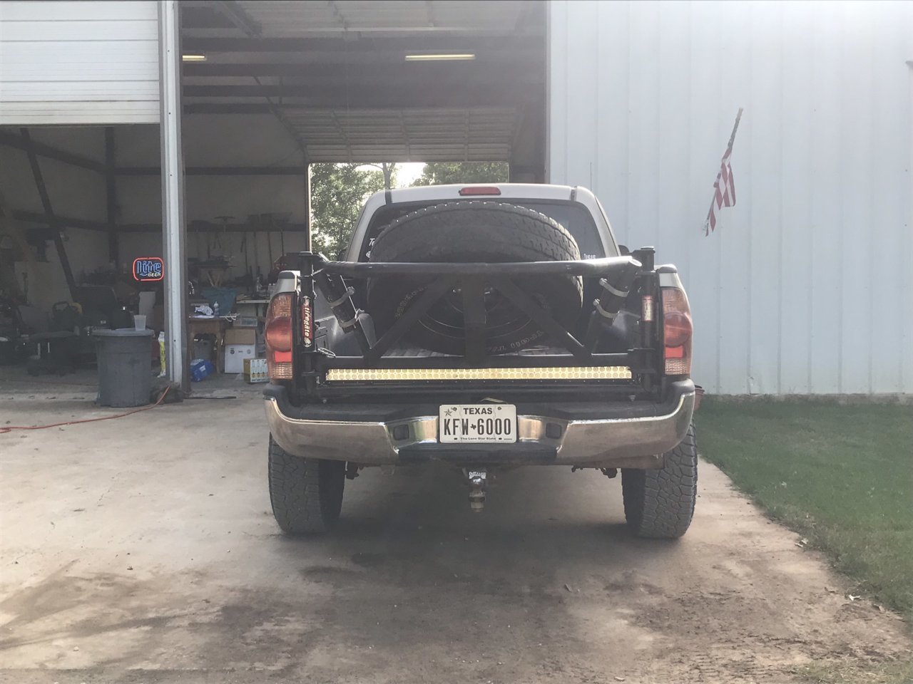

    So after about 6 months, my light bar got a leak... I contacted Amazon and they sent me a new one and sent back the leaky light. About 6 of the lights on the replacement didn’t work so I called again. Since this was the 2nd defective product in a row, they said I could keep the 2nd one for free, and sent a 3rd! I decided to mount the defective one under my tire gate, and it fits like a glove!
    I do a lot of kayak fishing, so it’s perfect for backing my truck up to water and getting my gear ready in the dark! It also doubles as a f$&@ you light for tailgaters! In fact since I put it on, it’s very rare that anyone actually gets close to me. But when they do... it’s kind of funny to watch them back waaay off after turning it on for a second.

    Got to love the f-you light. Had one on my Jeep only used it a few times but man people move right out the way

    Tailgaters beware but turning them on at the wrong time can bring some pretty steep fines.:eek:

    mod yeah for sure! I definitely keep that in mind when I use it. Also, it has definitely been the catalyst for some pretty severe road rage... so I always use it with caution. It’s just a friendly reminder when necessary, and if they don’t back off, I’ll leave it on lol. They usually get off of my ass one way or another!

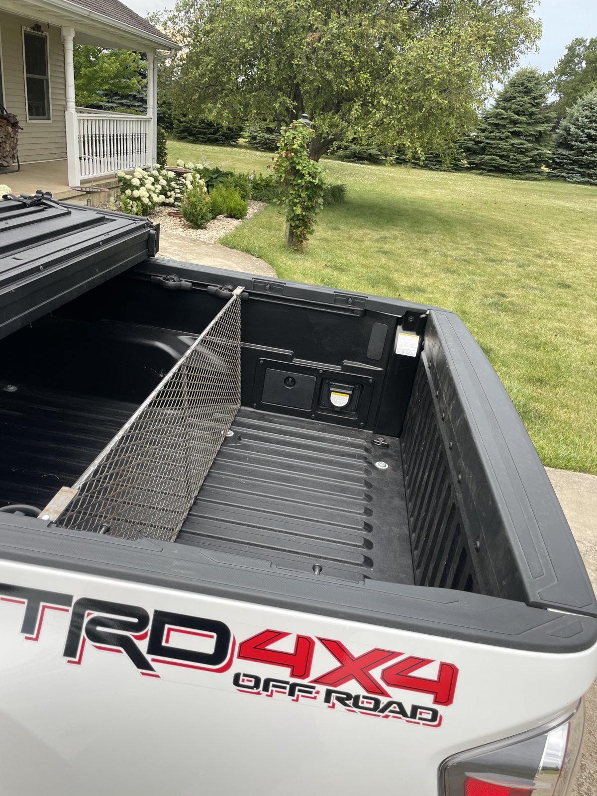

    DIY bed divider inspired by AlanKa
