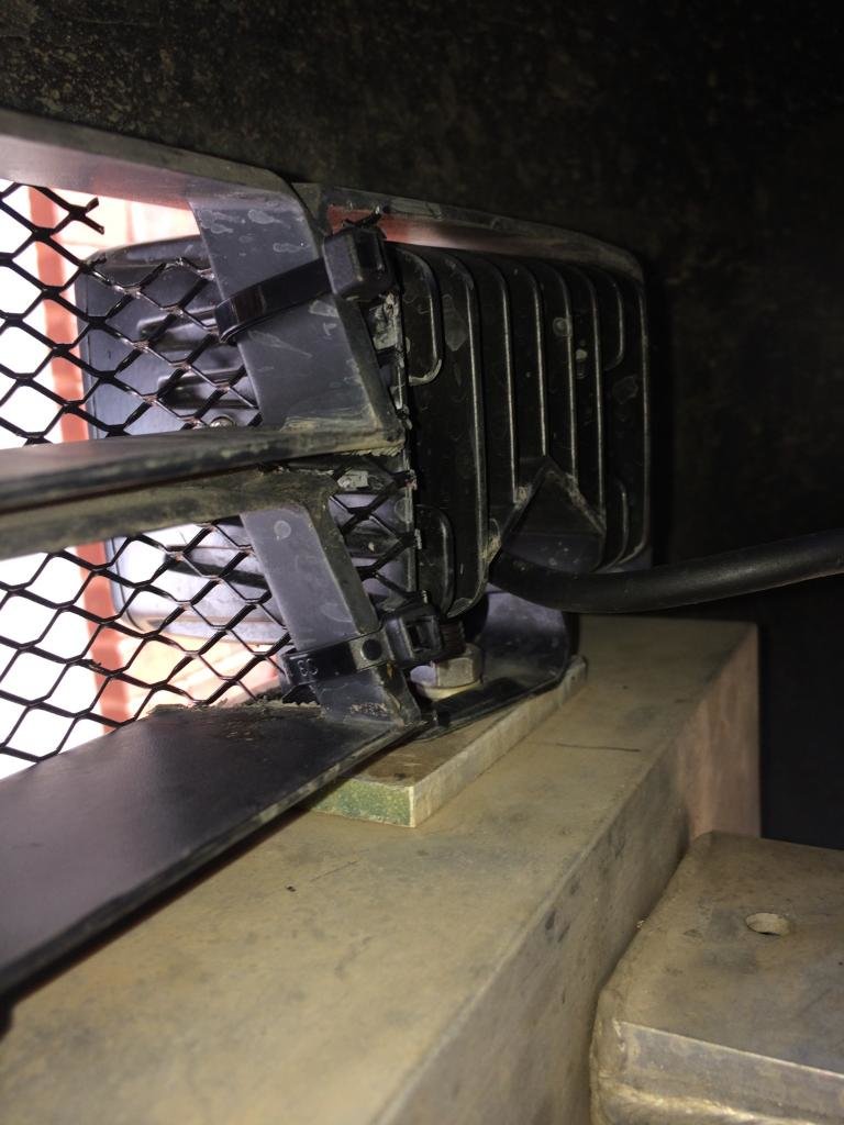

    This is how I attached it. Just bent the mesh at a 90 degree angle on both ends to wrap it around the existing stuff and zip tied it on. Seems to be holding well.

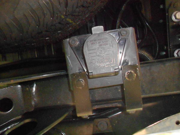

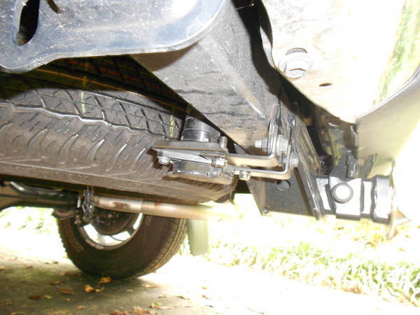

    Relocated my trailer plug-in. Made two L-brackets out of 1in aluminum (1/8in thick). Had the extra nut and bolts lying around the garage. Also had some MatteBlack Rustoleum left over from other projects. Spent just over $6. Might redo it later, but I think it looks pretty good for my first attempt. Got the plug-in out of the way and I didn't have to cut a hole in my bumper.

    I keep seeing the trailer plug relocation.
    what exactly is this plug "in the way" of?
  10. Sep 26, 2014 at 2:09 PM
    #270
    Ostrichsak
    Ostrichsak Don't taze me bro!
    Apr 5, 2012
    #76327
    9,122
    Jer
    Northern Colorado, USA
    Supercharged '10 Tacoma 4x4 TRD
    TRD Supercharger + too much stuff to list. Click sig pic
    Departure angle when 4-wheeling.
