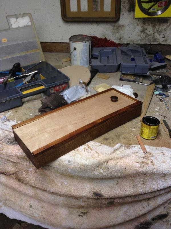

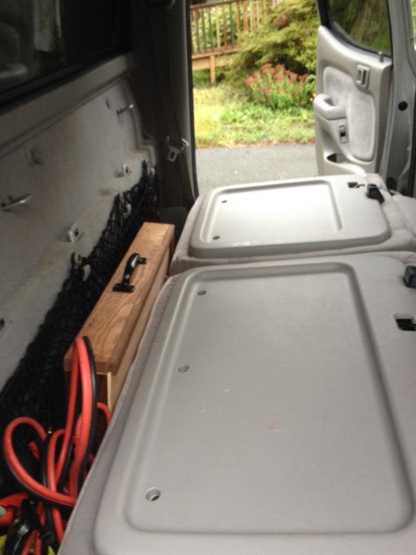

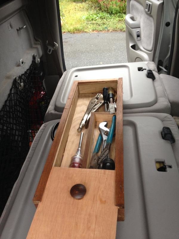

    I wanted a toolbox that would fit behind my fold down seat so i used some scrap wood i had and came up with this( i found similar things for 50-100$ on the googlemachine) mine was free:cheers:

    Nice! I would love to be able to use the space behind the rear seats. :eek: Put some carpet liner in there and they won't rattle. ;)

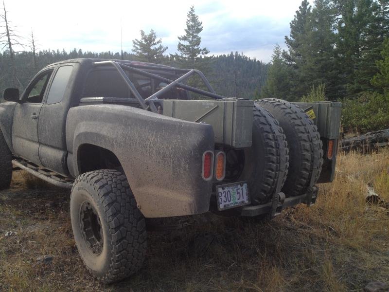

    Mounted some old ammo cans to hold recovery gear and some hand tools.

    Where did you get these locks?
    EDIT: NVM, you posted it. How well is the paint holding up on the locks?

    It's holding up pretty well, the locks are recessed so that itself prevents it from being scratched. I sanded the chrome finish before painting for better grip. :thumbsup:

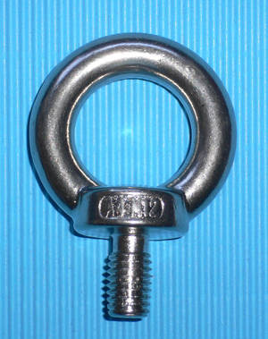

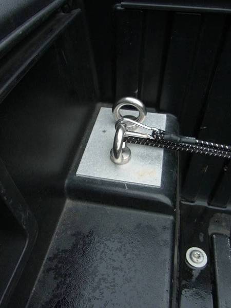

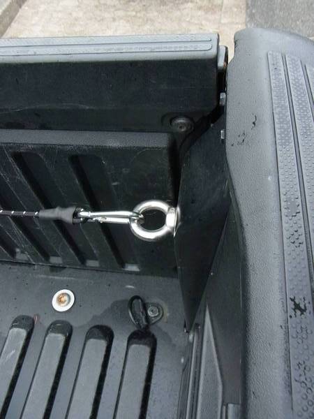

    selfmade new tie down points (not only for motorcycles)
    i use two aluminum plates (5mm thick) with 2 holes in every plate for each side.
    just two holes in the bed (each side).
    the plate under the bed has to be a little smaller.
    i made a aluminiun-plate sandwich, with the bed material in the middle
    use self locking nuts under the bed.
    thats it !!!
    sorry for my bad grammar[​IMG]
    and in the back you just have to remove the tail lights and just drill a hole.
    use two big washer (sandwich !) for the eye-bolt.
    Dj Suisav likes this.

    Nice! :cool: I like the one by the tailgate. I may use that one, maybe with a D-ring though.
