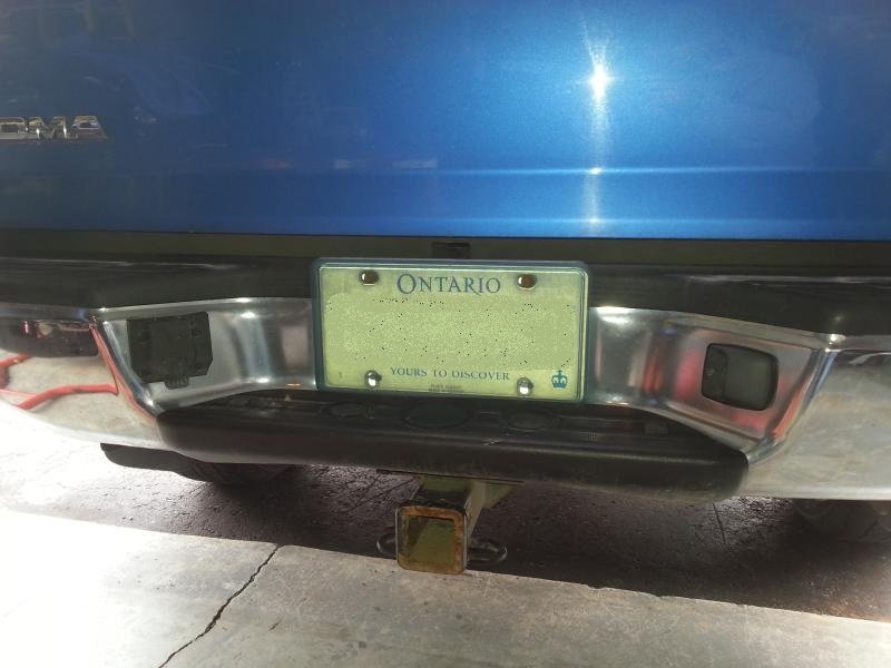

    Took out left plate light and mounted 7-pin connector. Fit like a champ.

    How much cutting did you have to do to get it to fit in the light slot?

    Zero. It fit perfect. It's a Reese 7 pin plug.
    I took the light out, and put the 7 pin plug in the existing hole. Marked 4 holes and drilled out for the 4 mounting holes.
    I'm not kidding - fit like a charm!

    doing this today!!!!!!! I was contemplating doing the flush mount in the bumper, but if this means not drilling a hole into it (and with my luck screwing up) you answered my problem!
