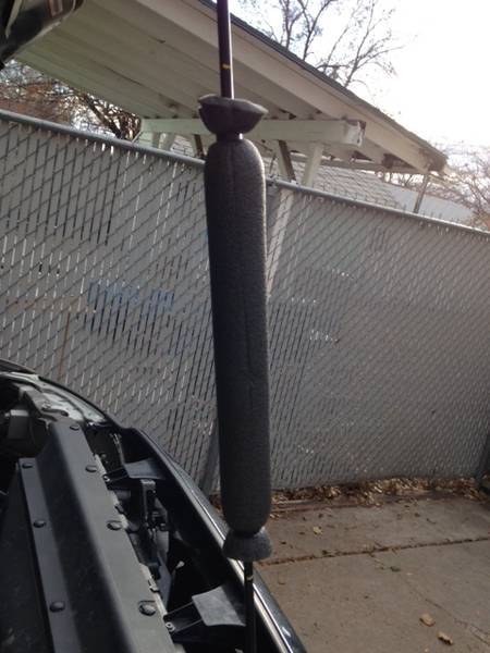

    I kept hearing this infernal rattle that sounded like metal hitting metal, when I'd drive on dirt roads with lots of cobble or washboards. I checked the motor, transmission and t-case mounts and they were all fine. I checked the drivelines, center bearing, front diff, CV axles and all suspension components with the truck up in the air on jackstands and no load on the suspension. I checked everything underhood, the front clip and the safety bumper. Finally when I had enough for one day and shut the hood, I heard the rattle again for a split-second. I opened the hood and discovered that the hood prop is wiggly even when it is secured in the plastic clip that holds it down. I already had the leftover pipe insulation and zip ties, so the "silent hood prop" mod cost me $0.00, and when I leave the pavement my truck no longer rattles like a '92 Dodge Neon with a bad aero kit.

    Thanks for doing all the work for us. That's a lot of hunting.

    Get Redline Tuning hood struts and you won't have to keep that "silent" prop rod :D
    Glad you found an easy quick fix :thumbsup: to you

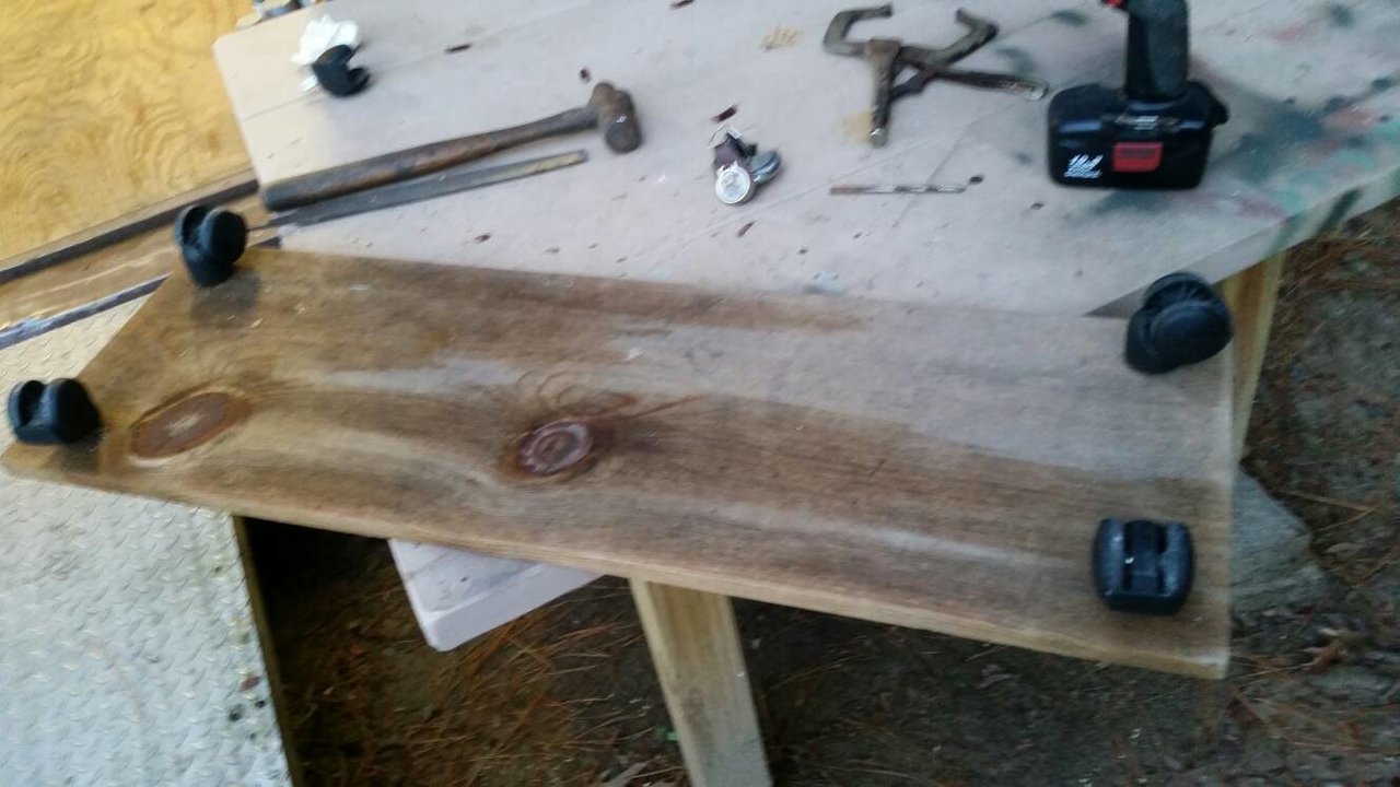

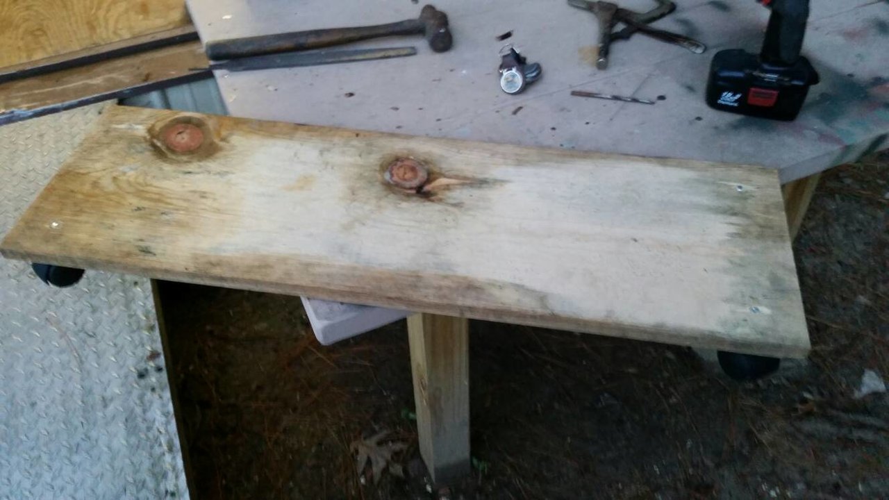

    Not really a mod but it was frugal, did it myself, and will be used for my tacoma. Took a plank of wood and old stool to be thrown away, hammered the wheels off, drilled holes in each corner, and wedged the wheels in. About 20 minutes time.

    A dwarf creeper? LOL

    Sh, no one must know my true appearance.
